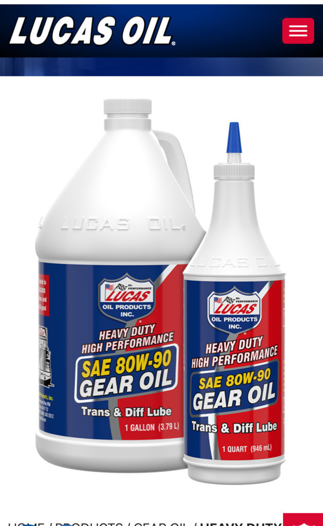

    Are you meaning this?
    And no additional additives?
  22. Jun 6, 2025 at 6:12 PM
    shifty`
    shifty` Waving My Dick In The Wind
    Jun 20, 2020
    #48239
    30,063
    ATL
    '06 AC Limited V8/4WD
    Yes. That specific gear oil works, as is, with zero additives. It’s what is currently in my LSD diff today, after spending almost $70 on my preferred Mobil1 full synthetic gear oil, and getting diff chatter.
    But with it being non-synthetic, you should change it in half as many miles as synthetic with normal use (15-17.5k) and if towing, 7.5k-10k miles. Those are *ideal* numbers, if we had a dollar for every person on here that’s gone 150k miles without ever changing diff fluids, we’d be rich.
