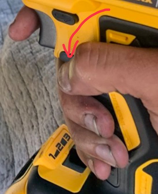

    I REEAALLY hope everyone here is just joking... I think I can tell which direction my impact and socket are spinning.. :facepalm: was just like that in the shot. I tried breaker bar, torque wrench and vice grip all before my impact fyi. But good side note regarding button direction for the future. Either way going to buddies shop in the AM for weld and extract, last resort.

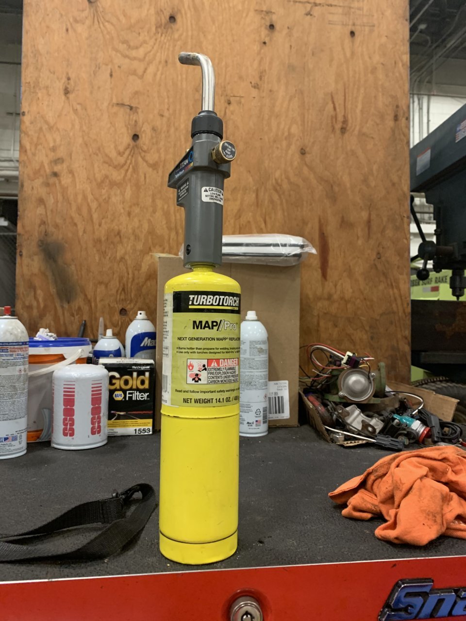

    Map gas will be enough heat for it and air hammer

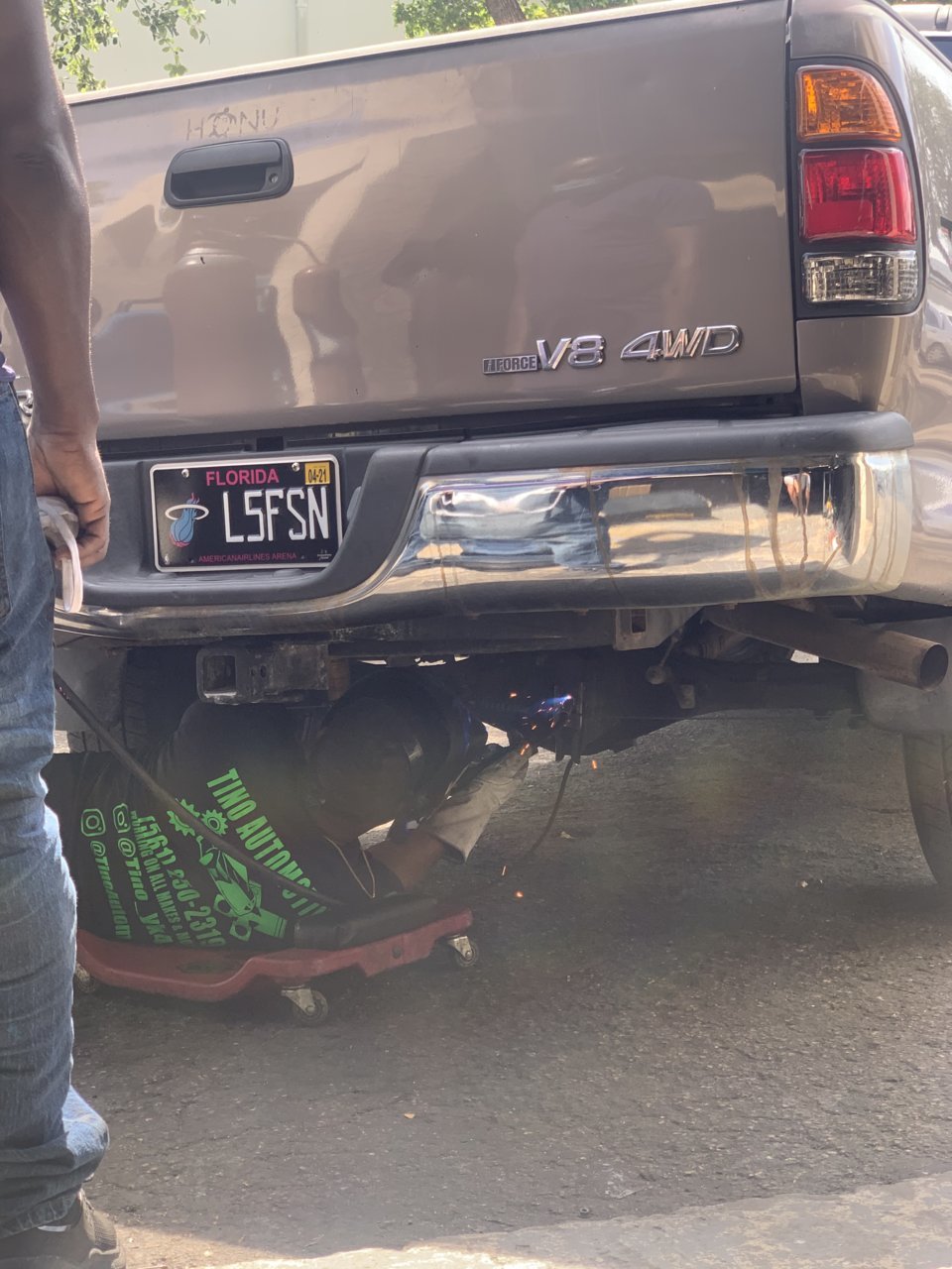

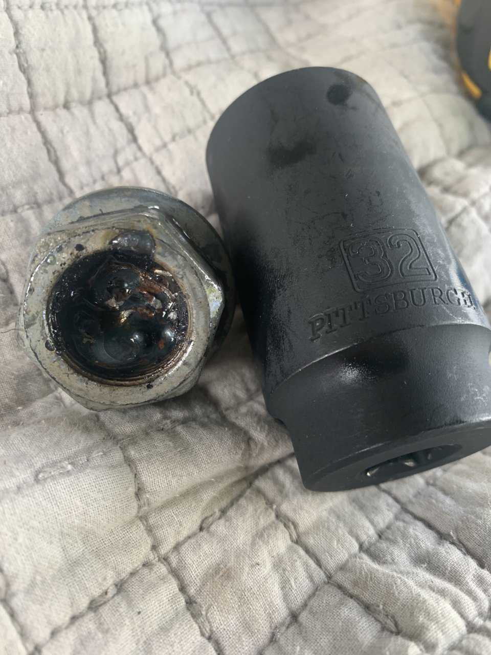

    Wellllll... got the bolt off. Went to a buddy and local mechanic of mine who pretty much does it all. Welded on a 32 and we got the thing off rather easily. I did find out that indeed I leaked a lot of fluid through the driver side seal, was nearly dry for a good month or so o_O ..Filled her up, went to Toyota and got a brand new diff plug. Torqued her down to 39lbs as manual notes. Kind of like having a shiny new bolt for everyone to see ;) Thanks to the solid amount of feedback in basically just a day.. I’ll probably invest in a budget welding machine down the road. She’s coming along nicely, suspension work on the horizon fellas!
    also @TTund16, my Dewalt impact has 3 speeds, 700lb being max. But I use a torque wrench up to 150lb to finish off most bolts/nuts!
