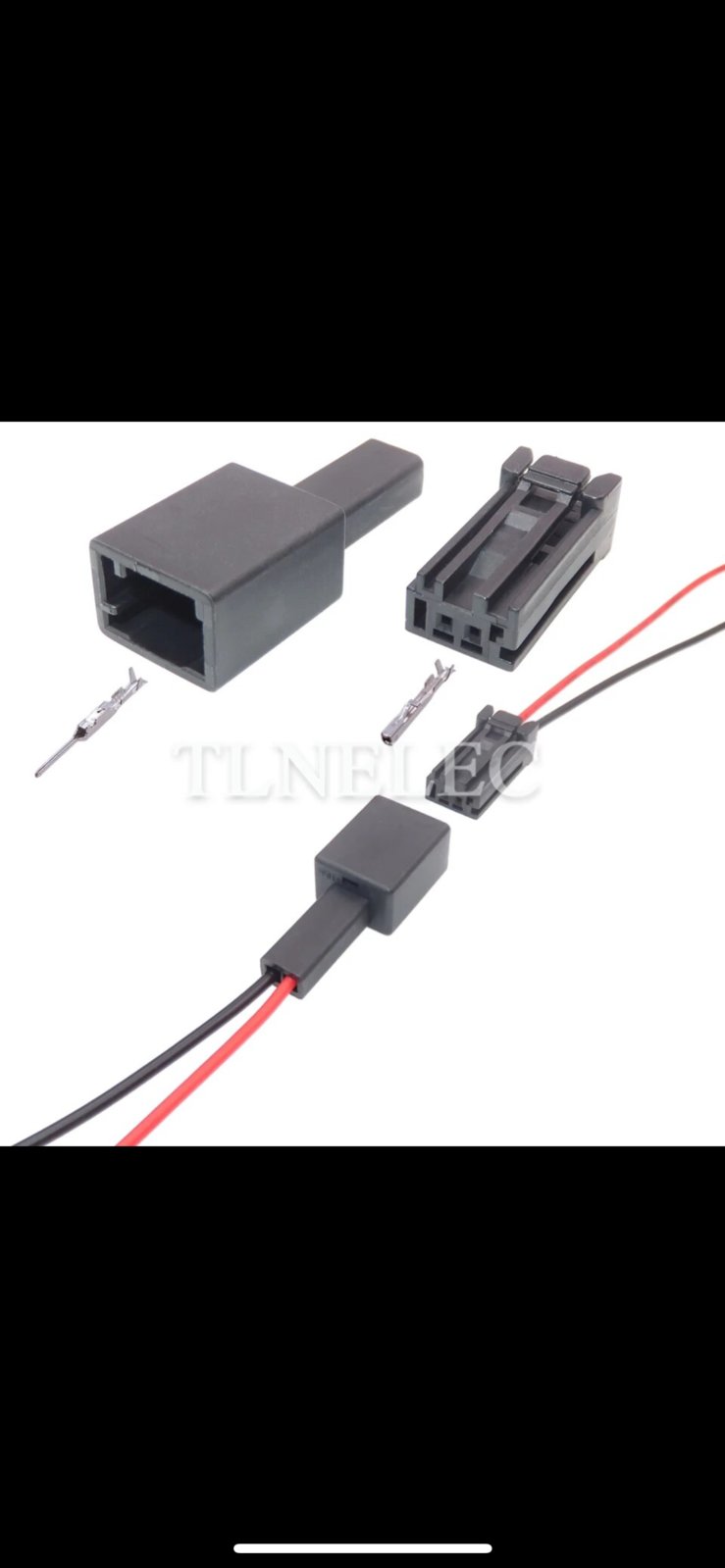

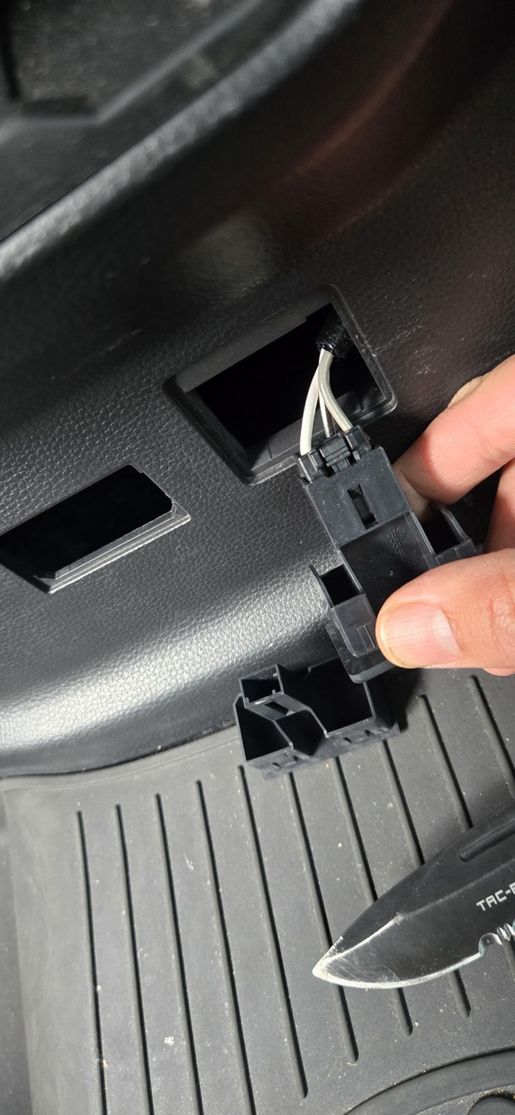

    Has anyone with a 2023 SR5, found they are "prewired" for the USB? I hate to tear the console apart to either splice or add the Y-cable from the kit, 00016-34325. I purchased a OEM USB port, w' flip covers', off of Ebay. No, I have not pulled my console apart, nor tried to pop the USB "plug" out. I grabbed this photo from MRQZTNDR93's post hoping that someone found the USB "hole-plug" had a harness connected to it:

    You’re not prewired. I’ve done this mod already. Mine is a 22 SR5 (loaded with all option packages) but they didn’t change anything to speak of between 22 and 23. I used the one with the covers as well. I also have the 120V inverter like you. But you can easily pull that back cover off if you want to have a looksy yourself. Don’t even need any tools.

    Confirming that the usb Power is not pre-wired. I have a 2023 SR5, I had to splice into the front USB circuit.

    I have a 22 SR5 and it was not prewired. I used the kit from sparks and taped into the power without cutting a wire. Takes about ten minutes to install as all the parts you need are included.
