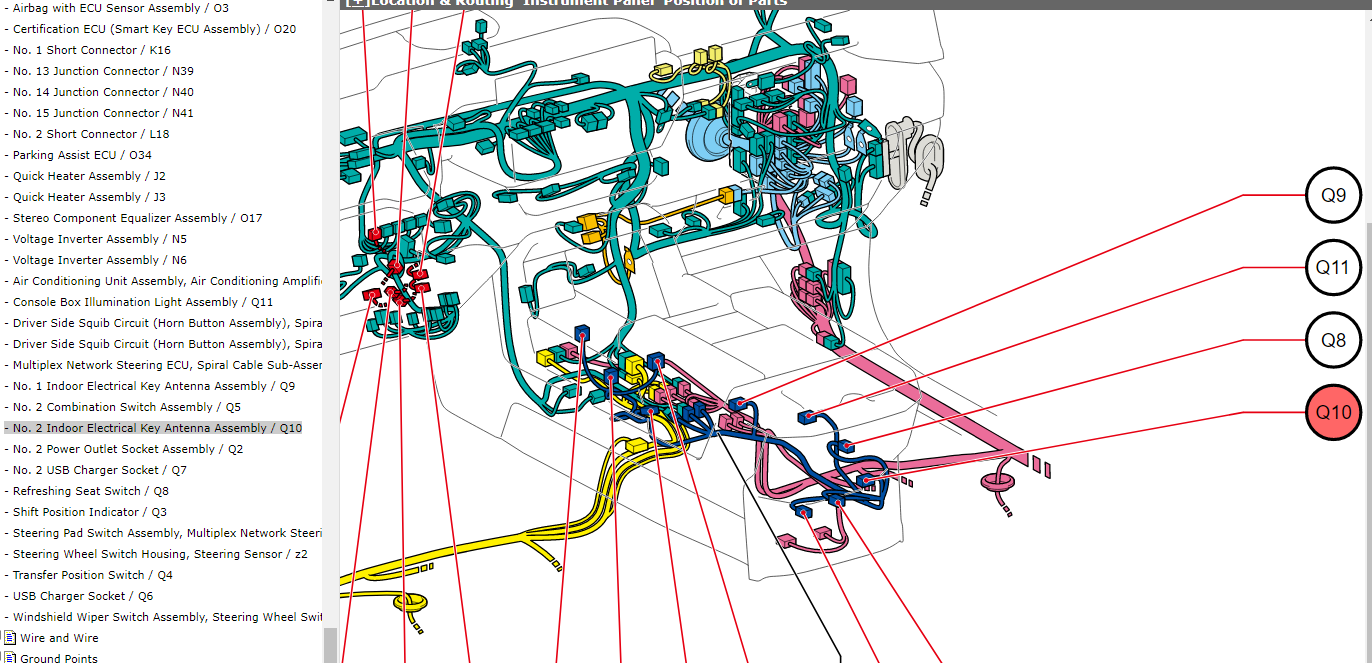

    If anything I LOVE how you can get ahold of these schematics.....now show me if the front door panels have the power side mirror cable looms inside for all trims.. :-D

    Wow you are good! how did you find that schematic... and by the way you are 100 percent right!

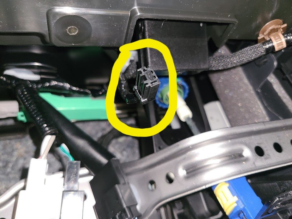

    @Buellride Do you think part # 90980-12D25 is the same as what I have circle in one of your installed picture? I am trying to figure out if the connector for the center console USB port is the same connector for the back of the rear USB port. In your picture, it looks like it is the same connector but I want to confirm before I start buying parts. Thanks in advance.
    https://www.toyotapartsdeal.com/oem/toyota~housing-connector-f~90980-12d25.html

    Yes, that is identical connector to the front USB port and what you would order from the Toyota parts dealer. I think the part from Toyota of Olympia, WA was something like $3.85, took 1 day for it to arrive at the dealer. Of note if you get the pigtail wire from Ebay, make sure to order 2. Also the wires that make up the Ebay pigtail are a smaller gauge to what is on the OEM wiring loom.

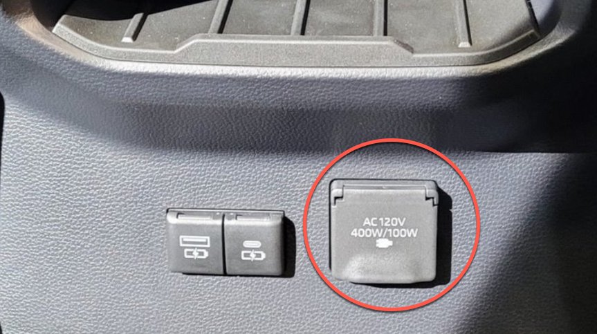

    Hi All, Does anyone know the part number of the AC 120V 400W/100W?upload_2022-6-5_0-23-10.jpg

    The outlet p/n is 855300C100C0
    It will require an inverter and associated wiring to function.
