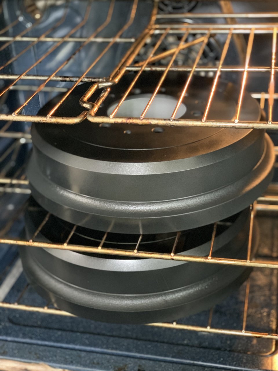

    I cooked the new drums with caliper paint, but when I dropped one off the hub it went shitty. No problem, old drums were just rust anyway.
