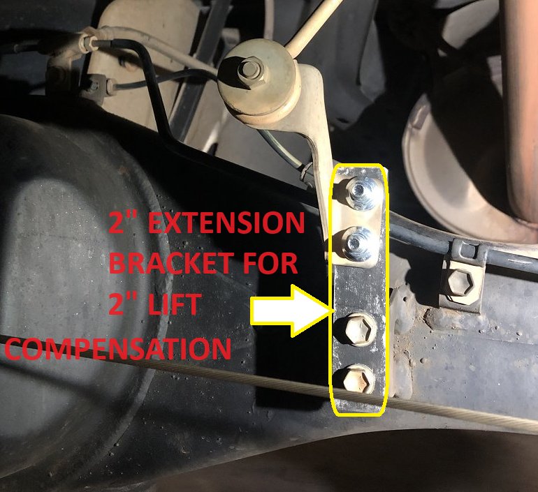

    Just dropping this here also, since it’s out in the world. Regarding LSPV adjustments to improve braking performance by shifting more responsibility to the rear brakes…
    it’s worth marking the original position with paint marker BEFORE adjusting if you choose to move the assemble up the threaded post, so you can always restore things if you don’t like the feel of more work being pushed to the drums.

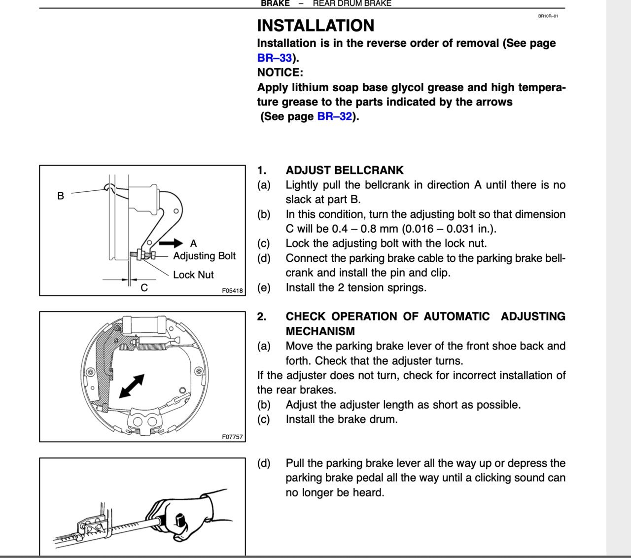

    I wanted to share my experience in case it helps someone. Saturday I replaced my rear brake shoes. Installation went fine and I uploaded a video showing the function of the star wheels/self adjusters. It shows that everything appears to be working correctly as I press the parking brake.
    Fast forward to yesterday and I go to test drive the truck. The brakes are terrible. Funny(or sad) given my brake history with this truck. @RUSTYNUTS is laughing.
    What I realized is that it didn't matter how many times I pressed the parking brake, the self adjusters eventually just stopped adjusting. I put the truck in neutral, rear tires off the ground, and it was clear as I spun the tires that the shoes were not lightly touching the drum. I ended up having to give each star adjuster around 7-8 clicks with a screwdriver from the access hole in the backing plate. That got the brakes almost where they need to be. I'll be fine tuning them soon.
    Where I think I messed up is that I forgot to adjust the bell cranks. I'm guessing they just aren't able to pull the brake shoes enough to get them where they need to be. I'll be working on that this week. Prior to working on my brakes, my parking brake worked perfect. As of today it sucks.
    TLDR-if you work on your rear brakes, don't forget the bell cranks.
    https://youtube.com/shorts/Zi1t2npPdEo?si=59UHsQTXLkvtQH3q
    Bell Crank adjustment below. Copied from the original post.
    Also including the troubleshooting guide that @jpink made.

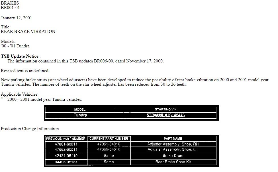

    Looks like I had this on the 'puter and haven't uploaded it to this thread. There was an updated adjuster / starwheel for 2000-2001. They reduced the number of teeth which would in turn increase the rate of self adjustment. New part numbers were listed at the time. Oddly enough the newer 26 tooth adjusters have been discontinued and the previous 30 tooth are still available.

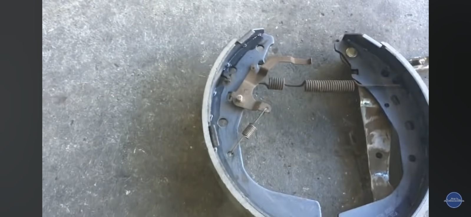

    At some point they changed them again. I noticed when watching a YouTube video that whatever year he was working on had a completely different design than the parts I have.
    Screenshot from video: mine looks nothing like that.

    Believe those are the later 05-06 versions. We've seen some pics on here that looked that way too.

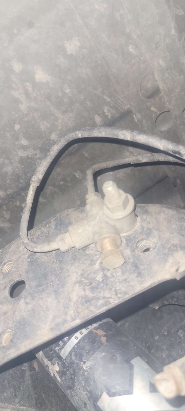

    I just did the LSPV delete this weekend. There was a solid improvement for me once I got the manual valve adjusted correctly. Looking back now, I would say my LSPV was failing or failed. If you think your LSPV is gone, worth the swap, IMHO.

    Did you go with Wilwood? I'm assuming it's an easy swap?

    Well hell, I didn't know you were gonna swap in a manual valve. I wouldntve given you the spray bottle. I thought you were gonna throw in a T-tap and call it good.

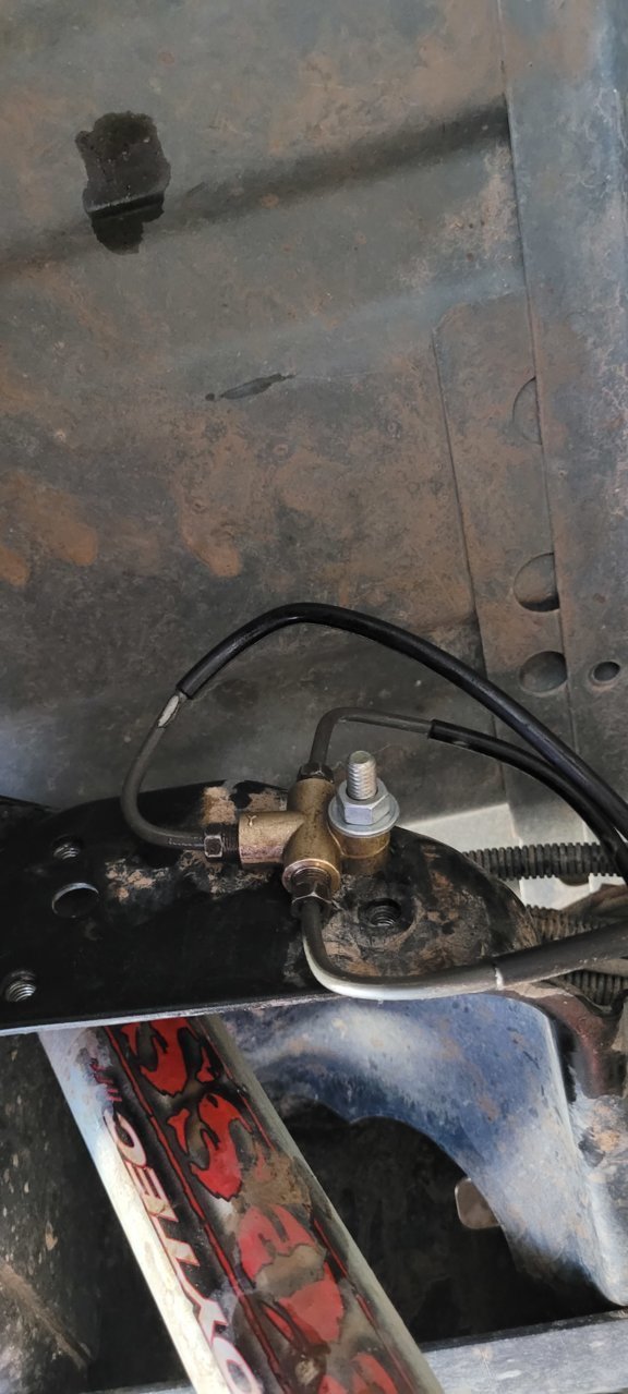

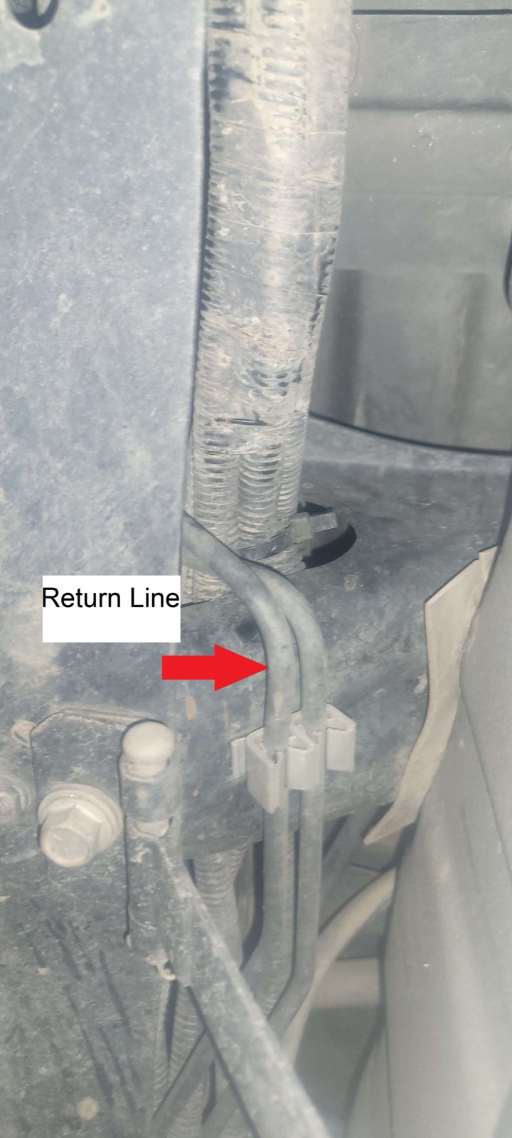

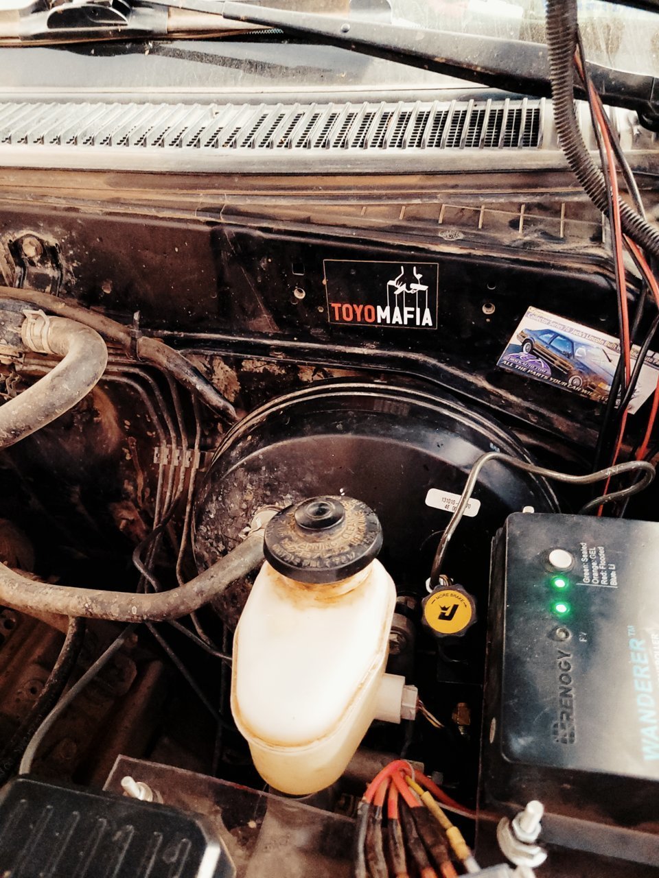

    I used a different kit than the Wilwood one, I put mine at the master cylinder instead of under the truck, but the Wilwood can go there too. This is an old pic, but that line sticking off it is a little tidier now.
    I bought tee this to put in place of the original LSPV, perfect fit. Specifically bought it for the hole to easily mount it to the frame. https://www.amazon.com/gp/product/B01N2HLYC6?ie=UTF8
    I still had some spongey-ness in the pedal I couldn't bleed, so I decided to delete the return line for the rear brakes to see if that would make a difference. Brake fluid has no choice but to go through the ABS lines this way to get to the rear brakes, otherwise there is a Tee under the brake booster that splits fluid before it goes to either the ABS lines, or directly to the rear. I much prefer it this way and have been running it without issues for awhile now.

    Yessir, it was super easy. I used that kit you linked for simplicity. Took me a couple hours. If I did it again I might drop the spare so I can reach in there a little easier. Of course, I do have a full size spare... if you had a factory size spare it would be fine. I still have the return line sitting in there just in case it didn't work but I will most likely pull it out in the future.

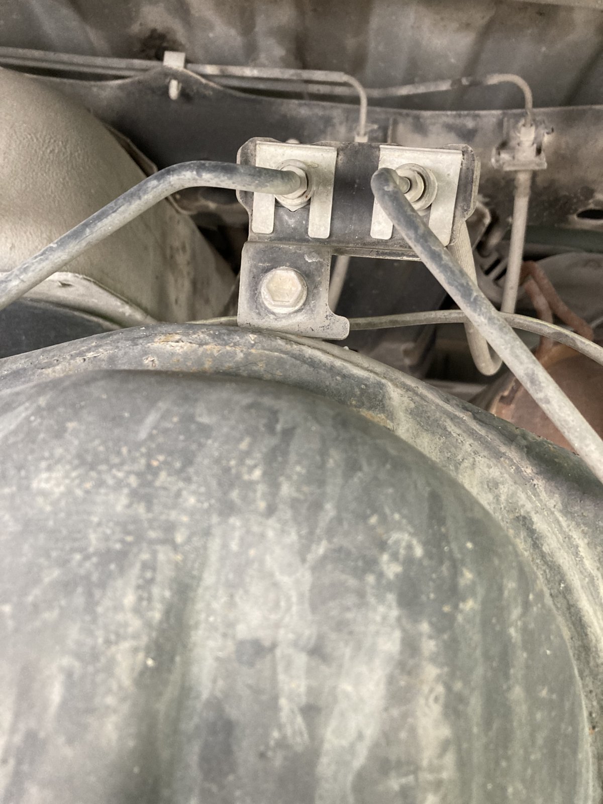

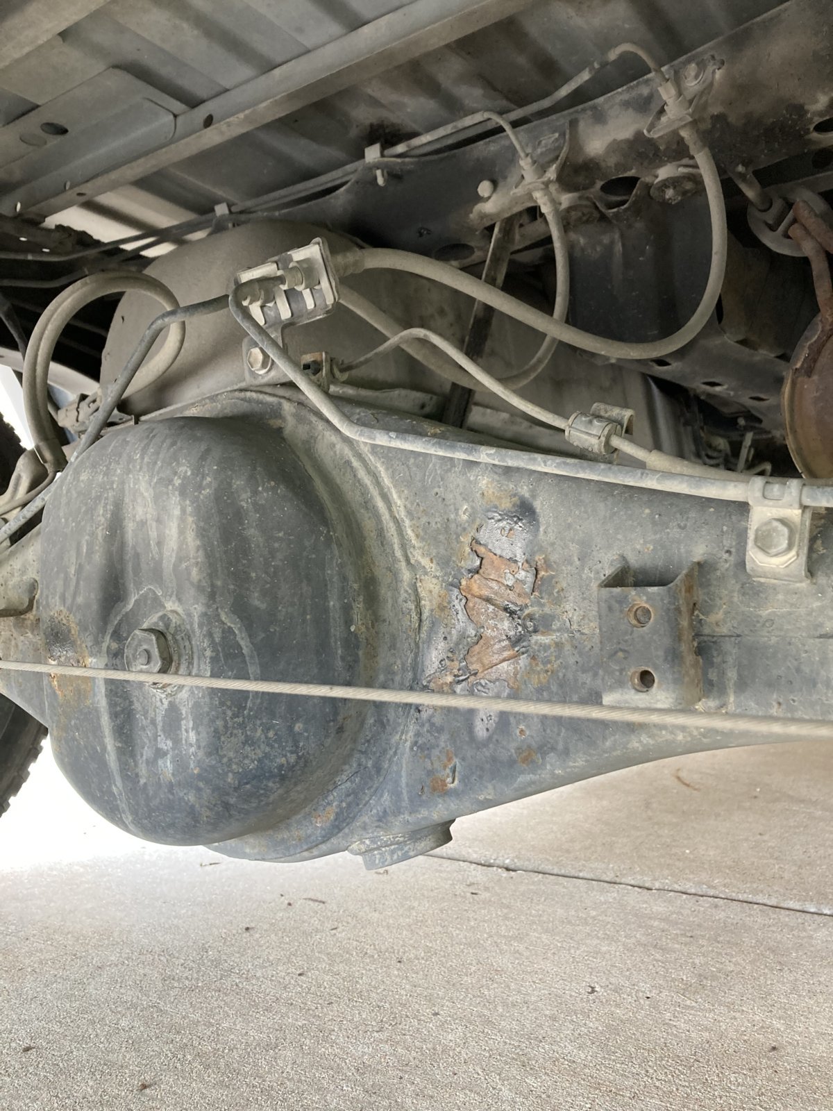

    Also, while I was in there, I looked for the LSPV. It’s not there. So I guess the previous owner had it taken off/bypassed? I know he towed a lot and the truck came with tow package off the lot, but that’s all the info I have on it. See pic below.
    Also, no LSD sticker. Dang it.
