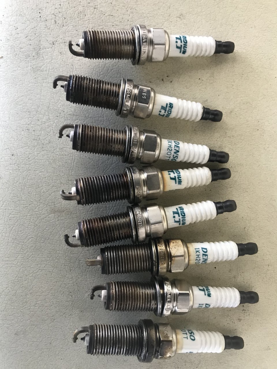

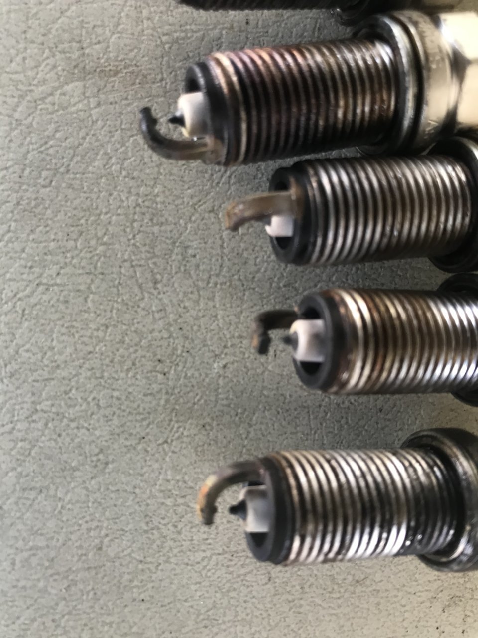

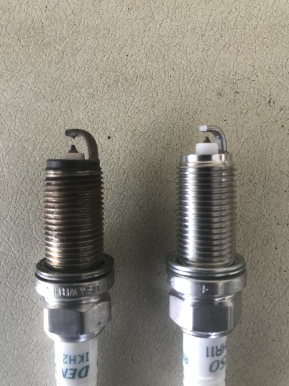

  27. Jun 3, 2020 at 11:08 AM
    #57
    Jeffro22
    Jeffro22 New Member
    Jun 23, 2019
    #32294
    314
    2013 platinum crewmax 4x4
    swapped out 8 "counterfeit" densos. Have about 12k miles on them, and gaps had opened up alot. Bought my new OEM plugs from toyota dealer
    33E90562-74FE-4229-B77E-0B282EABF37C.jpg 17CA8036-4F4C-477C-9E89-2802428BA665.jpg I just
    Joe333x likes this.
  28. Jun 3, 2020 at 11:18 AM
    #58
    Joe333x
    Joe333x Member
    Apr 4, 2019
    #28632
    1,925
    Boston
    2019 Tundra CrewMax Platinum
    I can't tell if it's just carbon build up on yours or not but one thing I had noticed on counterfeit plugs is the tips are much broader and not as fine as the tip on genuine plugs.
  29. Jun 3, 2020 at 12:34 PM
    #59
    Jeffro22
    Jeffro22 New Member
    Jun 23, 2019
    #32294
    314
    the fake ones have a bigger tip. The gap on all the plugs that I pulled was up to .56-.60
