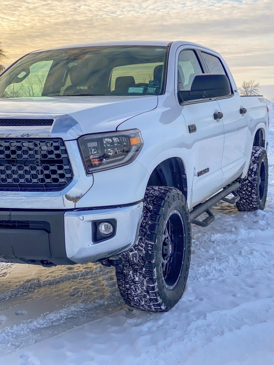

    My wheels are 20x9 0 offset. Here’s another pic.

    Did you have to remove/modify the inner fender?
    And the truck looks good....exactly stance-wise what i'm looking for.

    Thanks! I removed both front mudflaps and heated the front plastic bumper liner forward. Still rubs a bit in reverse if I cut it hard. I'm going to mess with it a little more once it warms up a little bit. To damn cold right now lol. I may install some of the bumper spacers depending if it still rubs or not. Not even close to the body mount though so that's good.

    Yeah i picked up some of the bumper spacers and already have the bumper liner removed on the drivers side.
