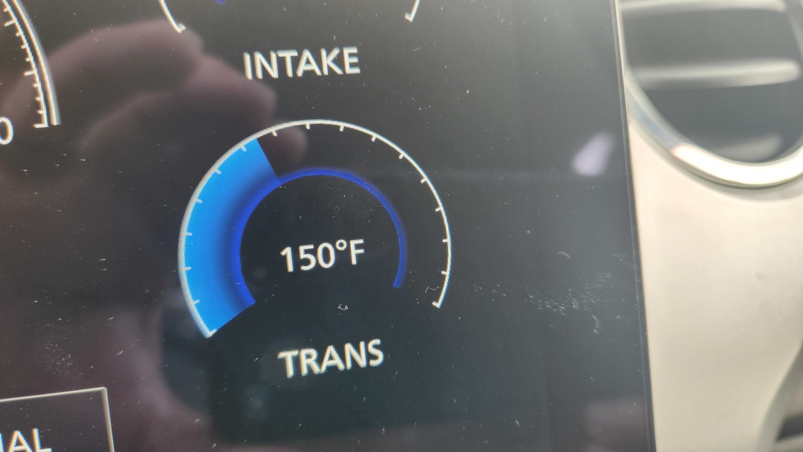

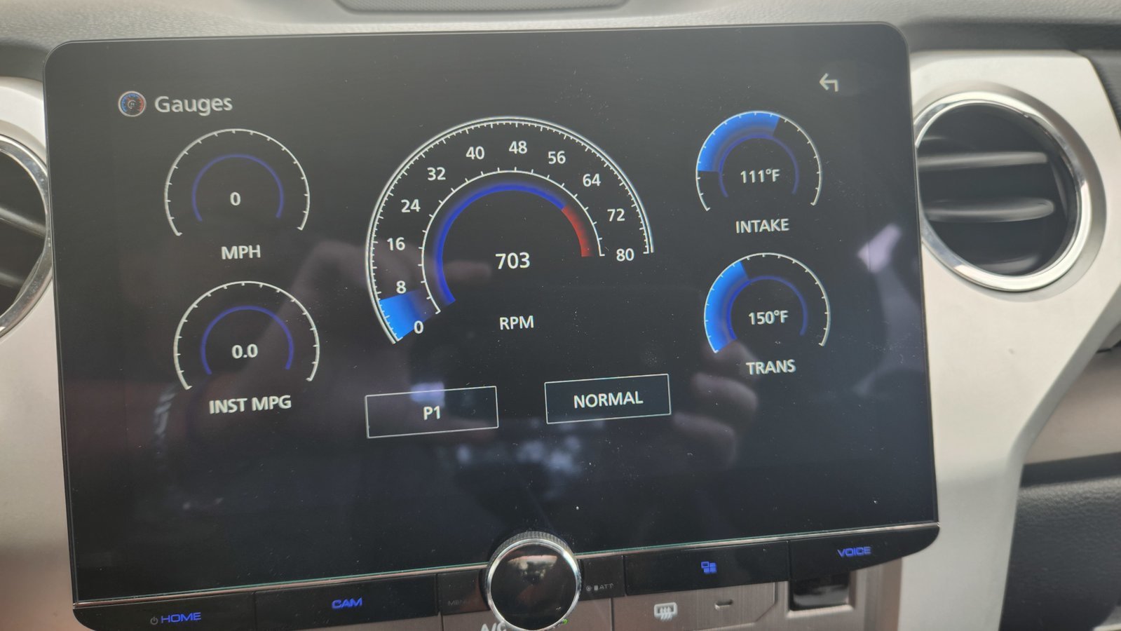

    SD Surfer
    SD Surfer [OP] Globe Trotting Bon Vivant
    Oct 13, 2022
    #84846
    1,847
    Bruce
    So Cal
    2019 SSM CM SR5 TRD OR 4X4 5.7
    I just spoke to Kyle and he knew all about you and Chris getting this to work and said you were a huge help in making it happen.:thumbsup:
    *Funny story* When I started telling him the situation and said "So I have a Tundra and I'm on a Tundra owners forum" he went "Oh no..." :rofl:
    It actually is in Beta but he's gonna' push it out to me as soon as I finish setting up my account on the Maestro app.
    Good news is that since I got the RR2 I'll be able to flash it via BT without having to pull the Maestro out.
    I'm gonna' be so flippin' happy if this actually works.
    1lowlife and AZBoatHauler like this.

  10. Jun 10, 2024 at 10:07 AM
    #70
    SD Surfer
    Oct 13, 2022
    #84846
    1,847
    Bruce
    So Cal
    So Are any of you guys reading trans temps on a head unit able to see both pan & TC readings like the scanner & app guys can?
    I'm assuming since I just have the one temp reading it's probably the pan?
    Once it gets up to temp it doesn't really budge. (but I haven't towed the trailer yet since getting the gauge to work)
    If I'm reading pan temp and TC temps spike a little (Say I'm towing and hit a grade, or if I'm wheeling) how quickly is that reflected in the pan?
  11. Jun 10, 2024 at 10:11 AM
    #71
    centex
    centex New Member
    Nov 27, 2022
    #87464
    1,903
    That I do not know. From what I'm seeing on mine, it looks like pan temps.
