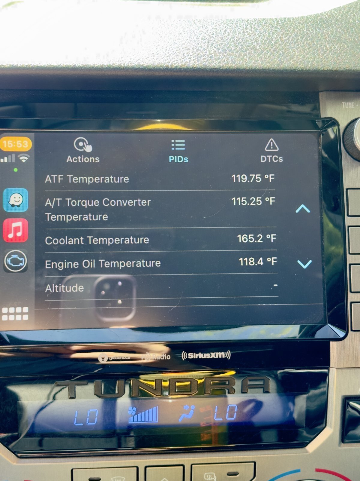

    You just need to buy a ODB scanner. I bought this one-
    Then download the ODB Fushion app. Then set it up. I also purchased extra Toyota PIDS for like $25 or something.
    The bottom one, the more expensive one, It does say it works with both Carplay and Android Auto.

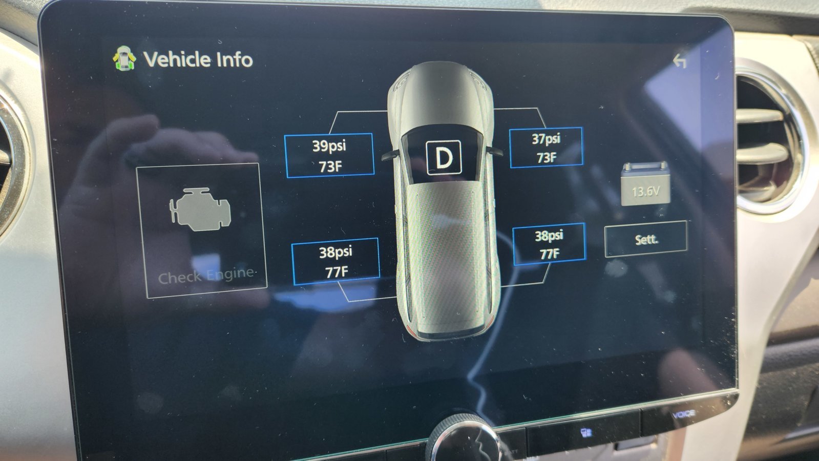

    Would I be getting the gauges, TPMS, etc. that I'm seeing if that wasn't connected?

    The ODB Fushion app. It the actual app, not screen mirroring.

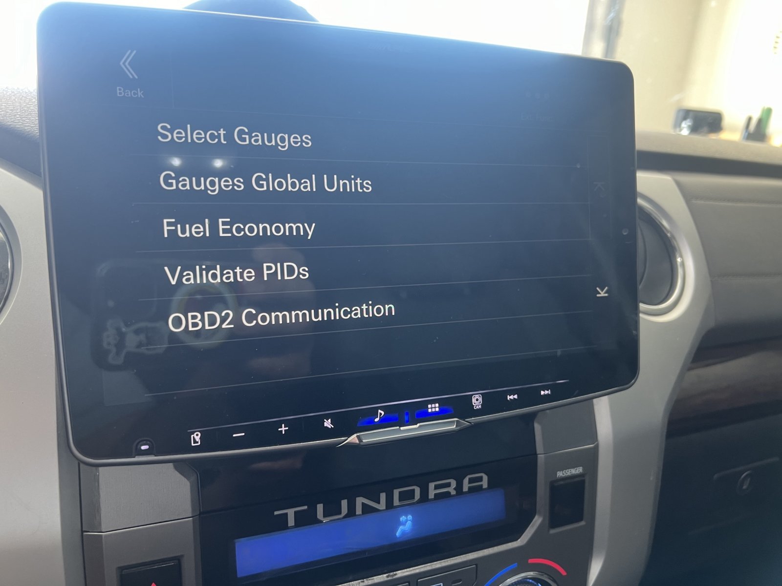

    I remember this setting. It somehow got changed when the dealership did a software recall for the emergency response phone call system and I lost my transmission and engine temperature gauges, had to turn this setting back on to get the gauges back. @SD Surfer I would also recommend leafing through the settings and see if you can find something related OBD2 communication. I'll look through mine again this evening to see if I can find it again.

    Yes - it is.
    go to the vehicle info page where you get tire pressure and click setup. Then click gauges. Then click OBD2 communication.

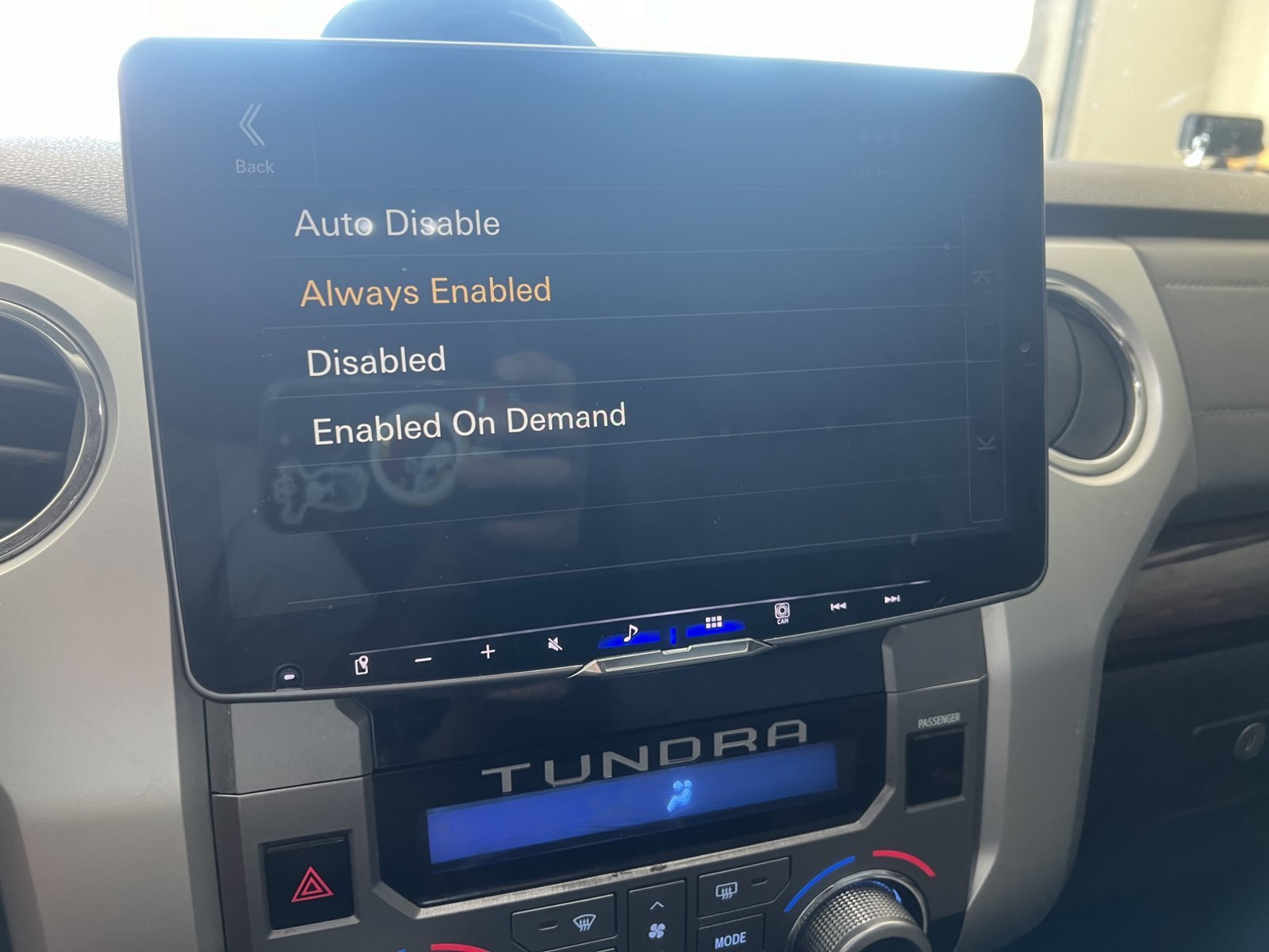

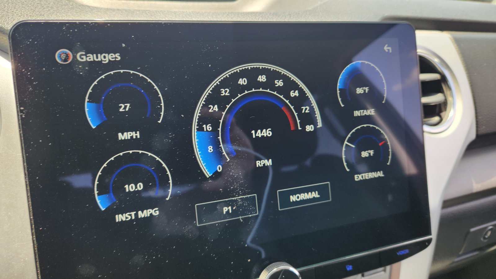

    Yep, I found that while I was on my lunch break... switched it from "Enabled on Demand" to "Always Enabled" then Validated PID's again. Didn't seem to do anything.
    I'll look later at all possible gauge positions, but the ones where it listed Trans Temp it was still grayed out.
    So here's a probably stupid idea... Since this seems to be a year by year thing I wonder what would happen if the Maestro was reflashed as a different year that seems to work.

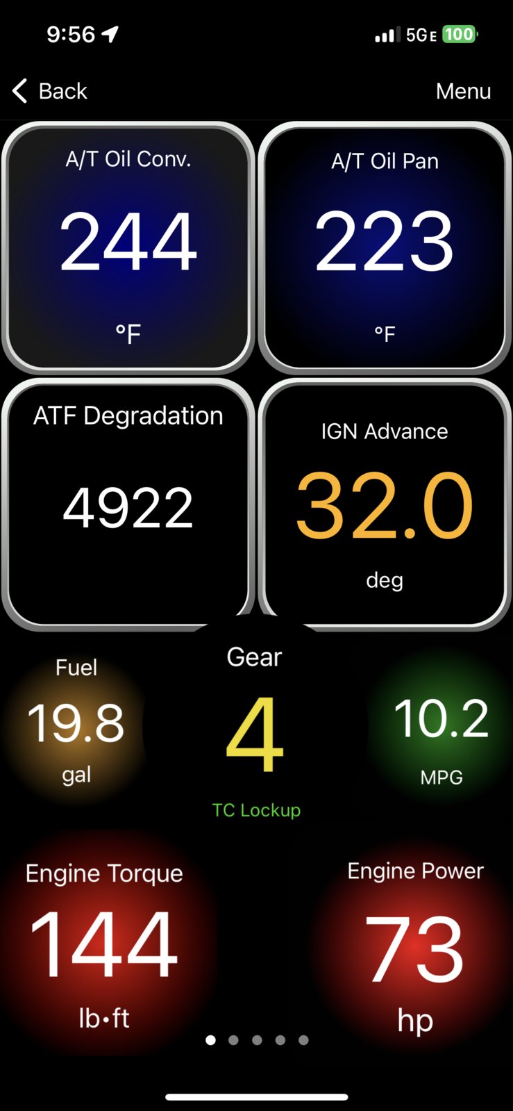

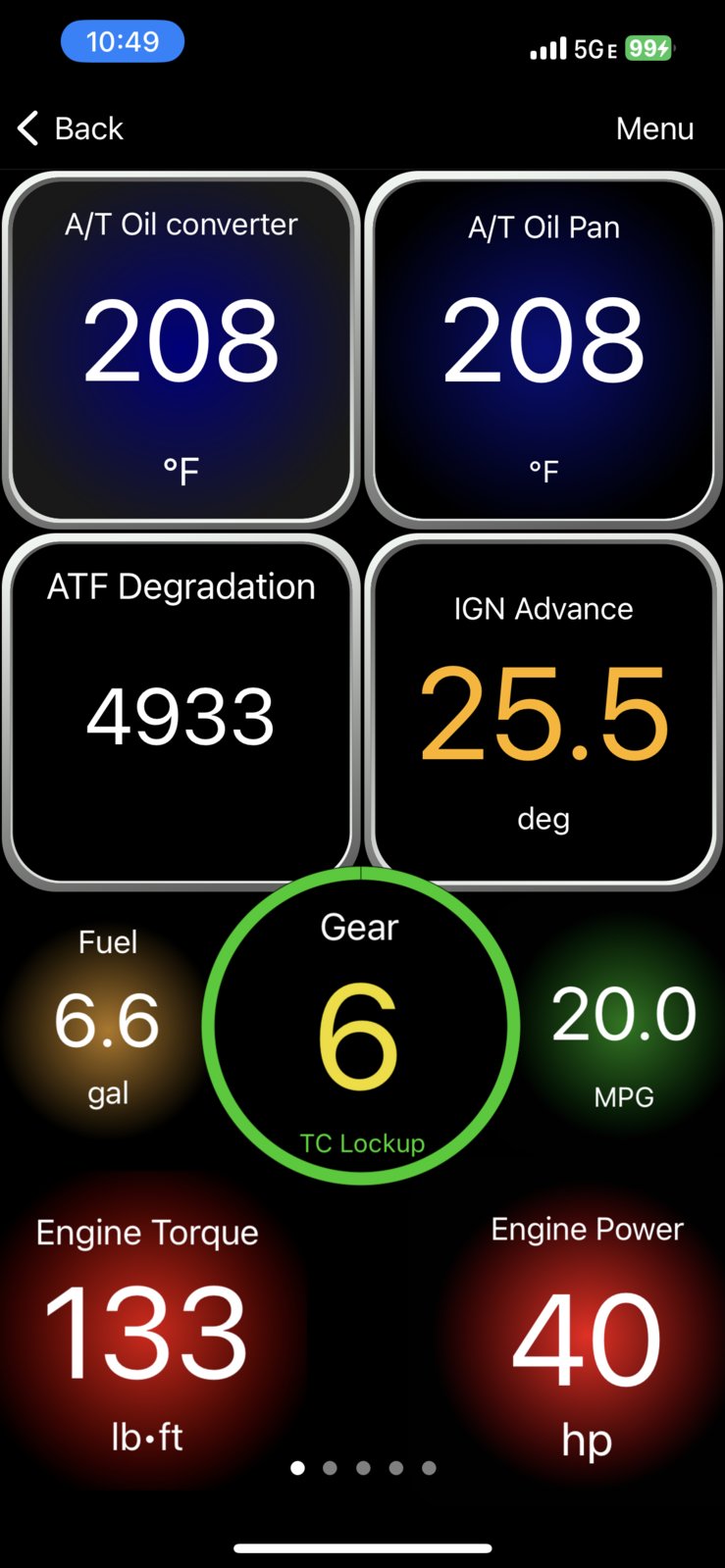

    On mine ATF Fluid temp #1 is pan and #2 is torque converter. TC lockup is a 1 or 0 value. I used another members custom parameters to make it a green ring that lights up around the current gear when locked.

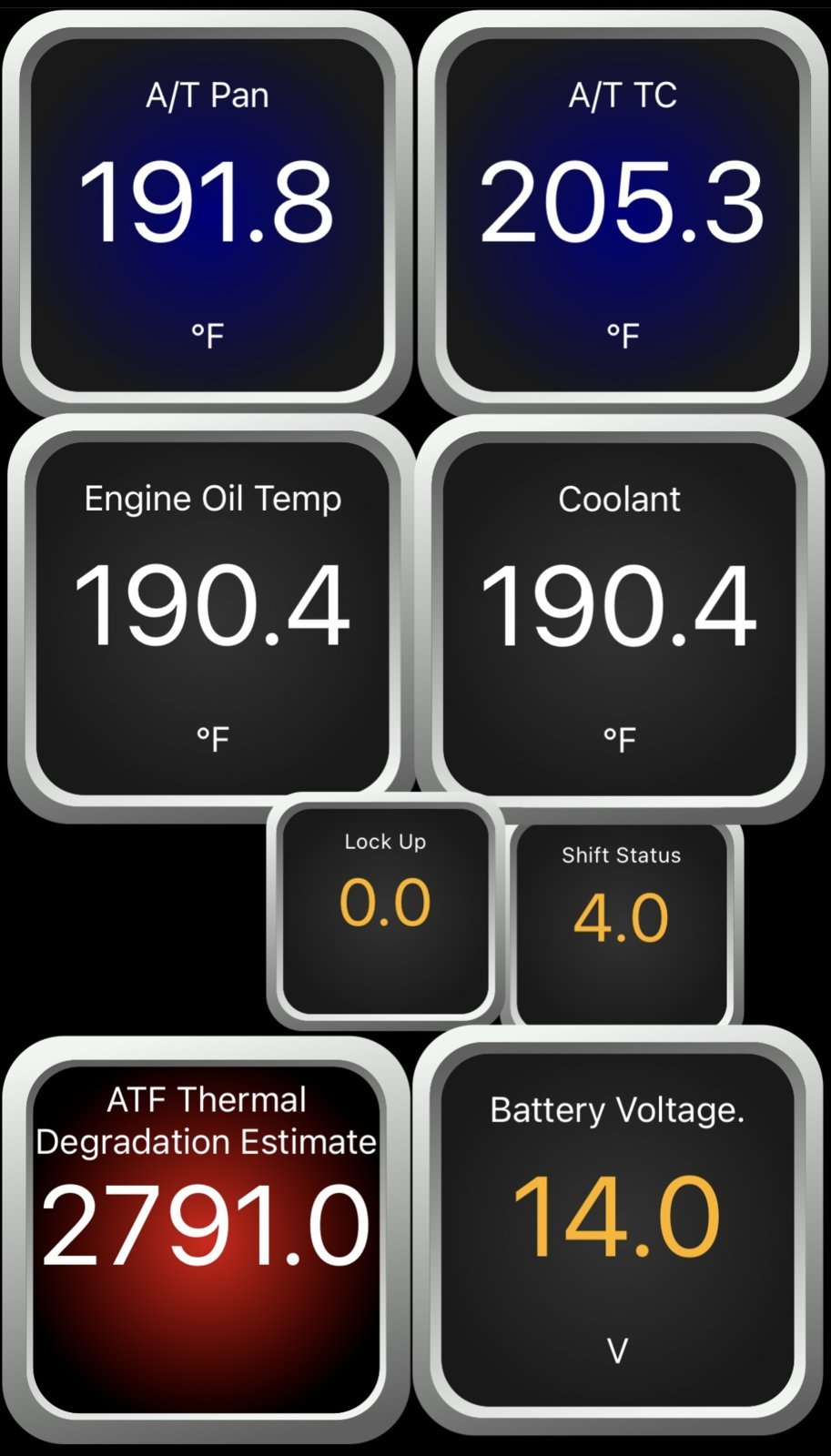

    upload_2024-5-29_13-37-42.jpg upload_2024-5-29_13-37-58.jpg upload_2024-5-29_13-41-53.jpg

    Care to share the parameters for the lockup?
