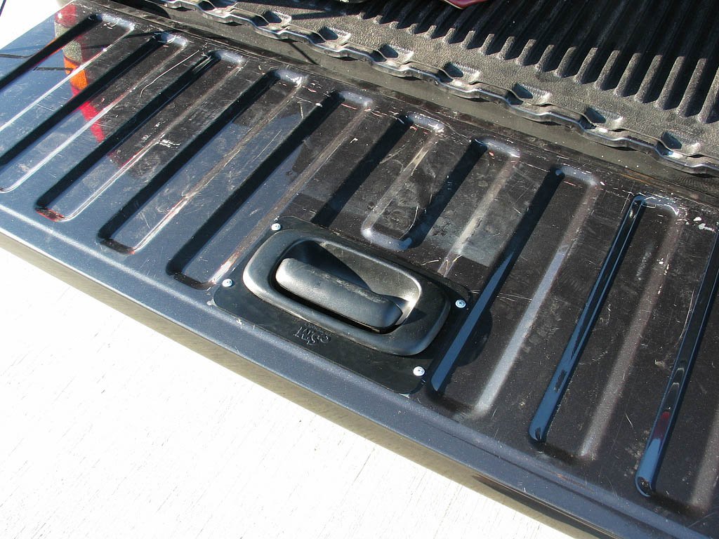

    Be sure to ask the shop what a good wait time is on that paint hardening up fully. I remember after shaving the tailgate on one of my previous trucks, I had it repainted by a friend of ours. I had to go to Home Depot a few days later to get some stuff, and when I brought the tailgate down, it barely tapped the lumber cart and it permanently dented the paint. You couldn't see it from a distance, but you could if you got up close enough. Man, I miss having family friends that could paint...

    @Shifty , on your pic, are scratches along the exterior gate lip?
    its been about 4 days since shop did its clearcoat polish and day temps have peaked to 72 this week.
    I did a hose down w/wash mitt and chamois wipe last night. Will call B&P about wax or some type of finish protection; forecast of drizzle-rain til Mon-Tues. [perfect overcast wx for wax job].
