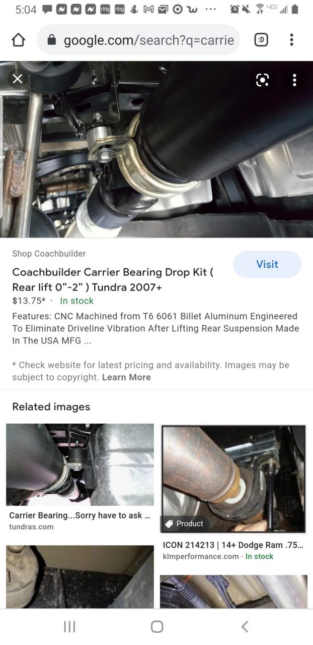

    Not sure what a carrier bearing drop kit is. Is it something I have to buy or is it already on the truck for the mechanic to adjust?

    Kanobi13
    Kanobi13 New Member
    Mar 27, 2018
    #13944
    1,258
    JayKay[QUOTED][OP] likes this.

    I would definitely try the drop kit first before the traction bars. They are super easy to install and cheap too

    As mentioned, I'd check the carrier bearing drop kit first before going with traction bars.
    I'd be surprised if an 8" lift kit didn't come with a bearing drop as part of the kit.

    Traction bars and a carrier bearing drop kit is the right thing to do. You don't want to be eating up u joints frequently, or worse, snapping them at very inconvenient times and or locations.

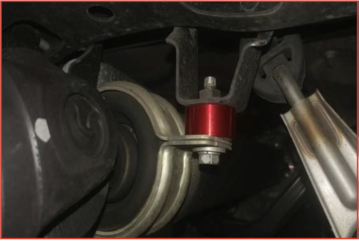

    Is this the carrier bearing drop kit? This is what’s included in the lift kit but not exactly sure where it is to check to see if the lift shop installed it. The color should be black, not red.

    Yes it is just spacer.

    They did install the spacer so I guess I’ll have to wait for the traction bars to come in to see if it’ll fix the vibration/shuttering issue I have at acceleration from a stop.
