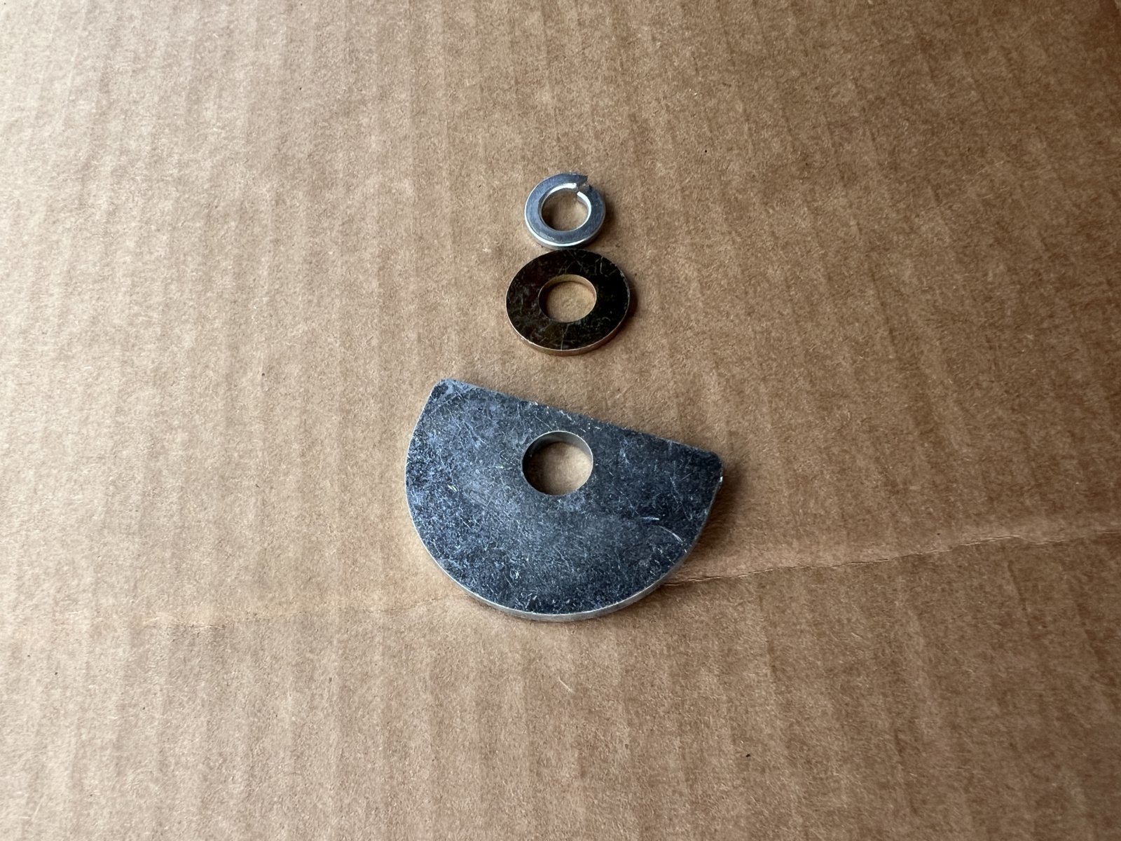

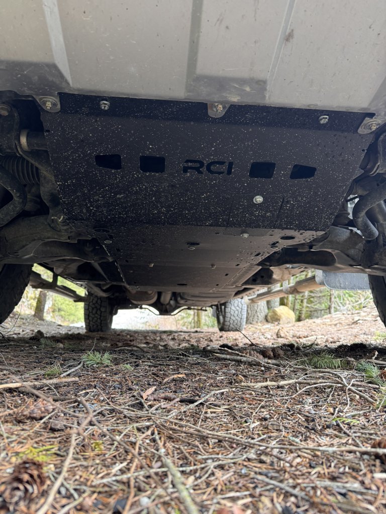

    So I got these all installed. It wasn't really bad at all except for the two nuts/bolts sandwiching the tcase and engine skids together. With the cat guards, there was barely any room to get in there. I was able to get my arm in the cut out for the oil drain for the passenger side, but the driver side didn't have that cut out and I could barely get a wrench on that. Removing it would be difficult to say the least.
    It came with these half moon thick washers and I didn't know where they go. I used them on top of the transfer case crossmember as a big washer.

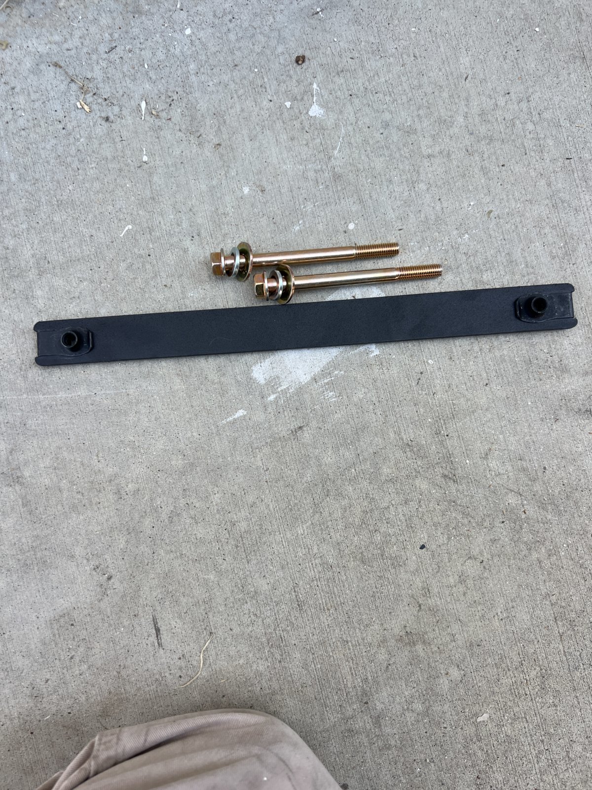

    I also didn't use what they called the Retro Mount Plate. Now that I think about it, I wonder if it would've made those last two nuts easier.
    I might pull it off and adjust the cat guards a bit. They are hitting something on the frame and vibrating. If I do that I'll try out the Retro Mount Plate.

    You really want the retrofit plate. It makes the 2 bolts that sandwich both plates super easy.

    I redid it today with the retrofit plate. Much bettter! I should've read the whole thread more carefully. It was addressed early on. Still don't know what those half moon plates are for.

    It comes with the cat guards. Because once you get the cat guards in place, you can't reach those two bolts.

    Some applications require the half moon plates as a backer because the hole is so close to the bend of the frame a full circle wouldn't fit (can't remember if it's the taco or another application); anyhow, rather than having multiple pieces of hardware for each application they provide the half moons to everyone to use as necessary.
