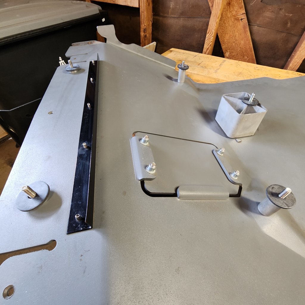

    I have the TRD knockoff engine skid n this is what I did when I had creaking and popping...
