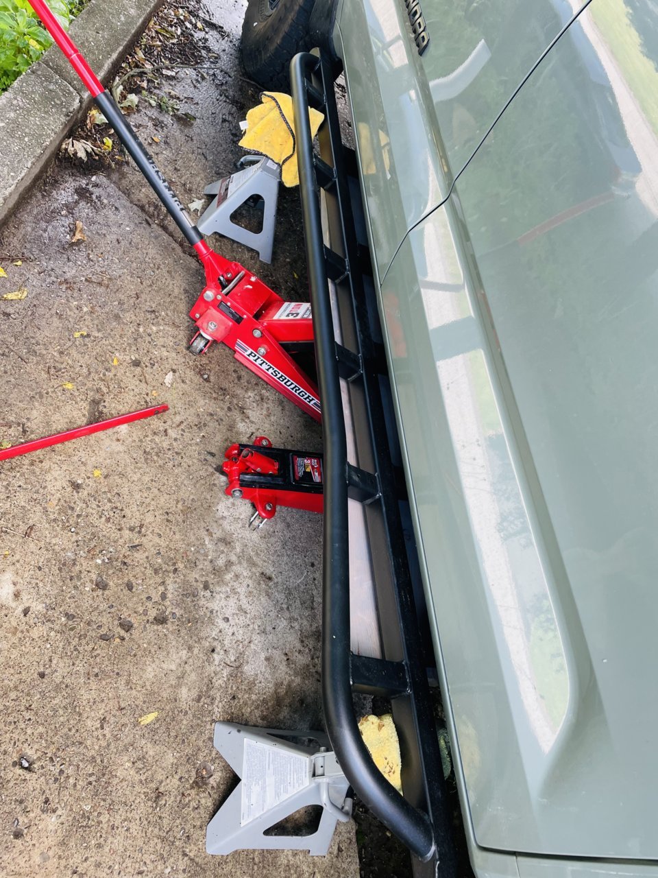

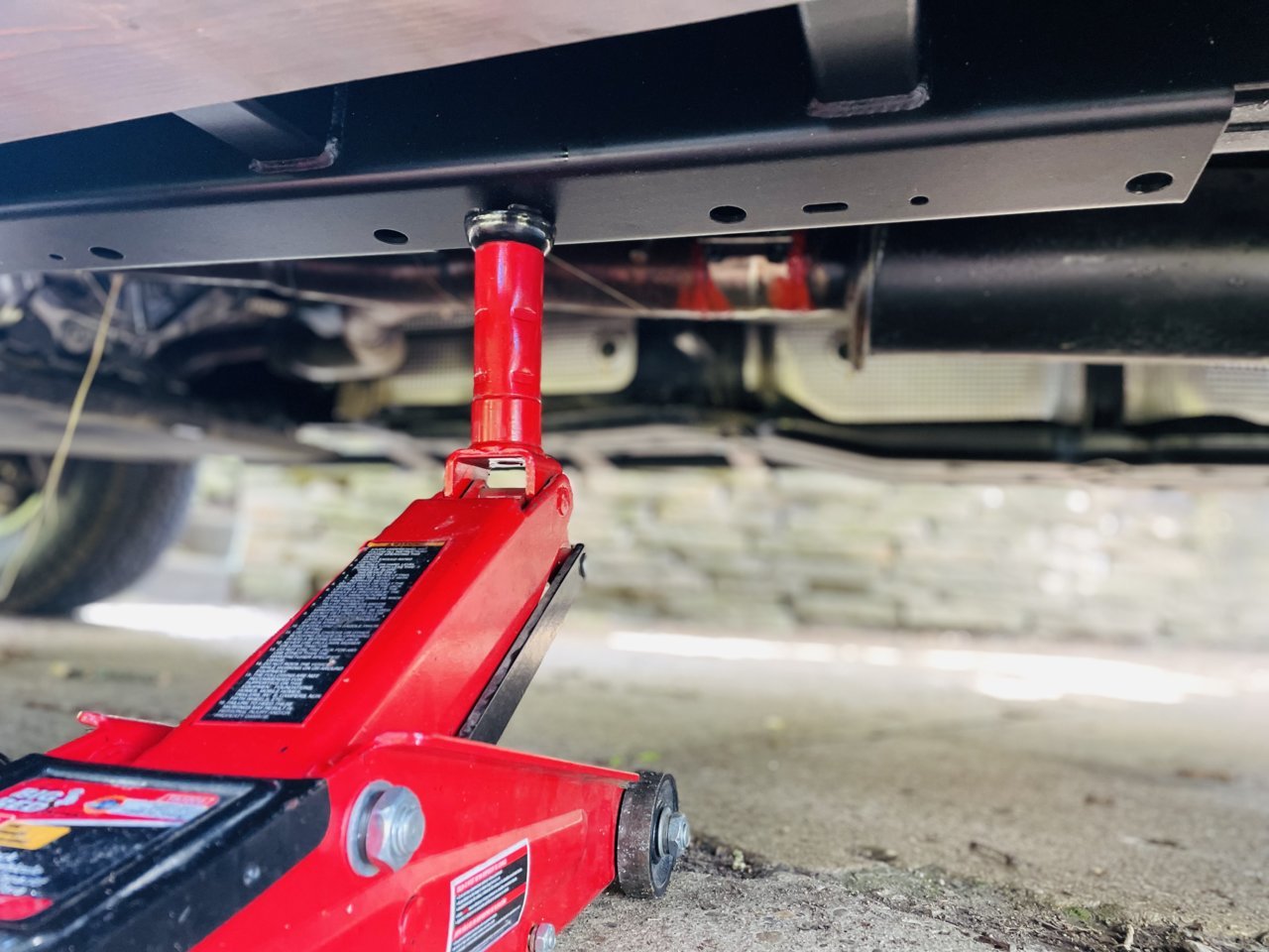

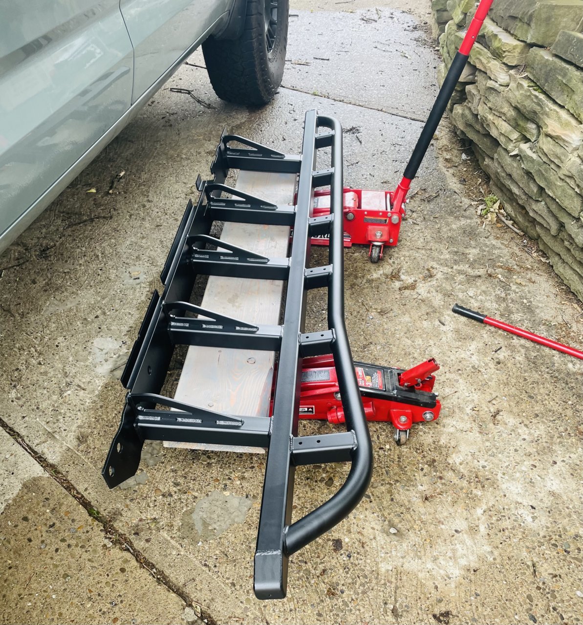

    Incase anyone in here hasn’t installed sliders. This was how I did it solo for getting the slider in place.
    Getting the nut plate into the driver side frame can be tricky and I’d recommend using wire fishing rods and extra string. Once the plates in the frame, it’s easy to slide into place with the rods but you’re going to want to make sure you have a bunch of extra string going into the entry hole incase you ever have to pull it out
    Two jacks and a pice of wood to support the sliders and slide it under the truck. C5E89F1F-C329-4758-A08C-E587B4AF7A3F.jpg
    move the slider in place and jack up the jacks until the slider is as high as it will go, without hitting the rocker panel.
    Place two jack stands under the rail of the slider to prevent it from tipping back.
    remove one of the jacks and move it to the frame plate. Jack the slider up into position onto the frame and make sure the holes of the slider are lined up with the frame.
