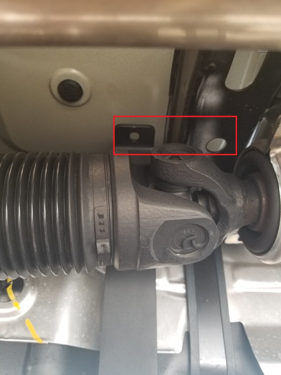

    I have had this same exact issue very recently. I have a 2021 SR5 4x4. I had to use a peice of aluminum flat to fab up a bracket to the crossmember. It works, but the website clearly states that this will fit on a 2021.

    Can you post a picture of this issue? We might be able to identify the problem and if it’s something we haven’t seen we would love to look into it!

    The picture of my issue was posted in this thread with Safar85's pictures of the "floating" bracket.

    The area in red is where I attached a flat from the bracket to the hole in the crossmember.

    Thank you for the photos! I have brought this to the attention of the shop owner and our engineer. We are working on a resolution for this!

    I have the same situation. I had contacted rci and they told me it was due to my truck being 2wd, hence missing some parts off a 4wd. The solution I was given was to use a self taping screw in that location. I didn’t like that solution and ended up using a Simpson strong tie a24. The bolt hole on the long portion actually lined up perfectly with the rci strap. Then drilled a hole through for the short piece through both ends of the cross member. So it went bolt, washer, cross member, washer, metal cylindrical spacer (could use bunch of washers), washer, cross member, washer, nut.
