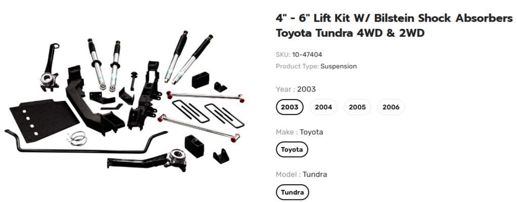

    Would love to see pics of this lift setup now that is 25’. Holding up well.? Seems like a solid setup.. they look great on the truck.!

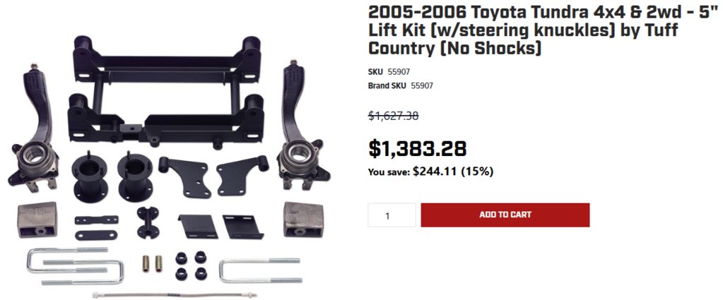

    When I looked at the pictures of the RCS lift compared to the Tuff Country lift, it appeared to me the weld-in portion was nearly identical between the kits. If true, would it not be likely there would be high parts interchange between the two? If so, just buy replacement knuckles from Tuff Country and you’ll be set, I think?
    Just be sure to avoid the knuckles with the spacer (I think it’s the 4.5” kit)

    Nix that, took a sec to side-by-side the two and they're definitely quite different.
    I would recommend you call RCD and ask them - NOW, don't waste time - if they have any parts remaining, and what they'd recommend. I'd probably aim to get the knuckles, since that would be the one thing you'd be hard pressed to find later.
    I always hated these kits used gigantic lift blocks in the back, it's horrible from an axle wrap/pinion perspective, but (I think?) both of these kits are irreversible, so ... you get what you get if a previous owner installed it, and can only do what little you can to reverse it. I'd probably drop the kit down to 4" lift and go to Archive or similar for custom leaf packs to lift the rear, if it were me. Especially if I'd be using the truck as a workhorse to potentially haul around stuff, which is where you'd suffer with axle wrap the most. Not getting the rear off those blocks would be a quick path to absolutely nuking your driveline.
    Tuff Country kit first, RCD is second.

    Rear shocks don’t provide lift, leaf packs and/or lift blocks do. The kit (for both brands) clearly use a 3”-4” lift block which should be installed at the axle, where the leaf pack bolts to the axle housing.
