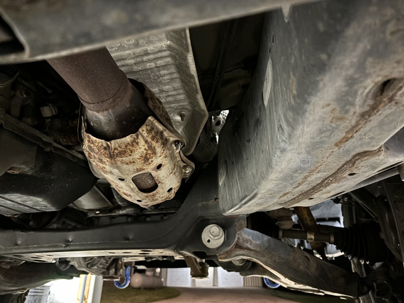

    Mine turned out to be rusted loose heat shield on catalytic converter. Start the truck cold and it has a little more vibration to it then when it warms up and idles down the sound would go away. Couple new bolts and lock nuts and she’s good as new.
