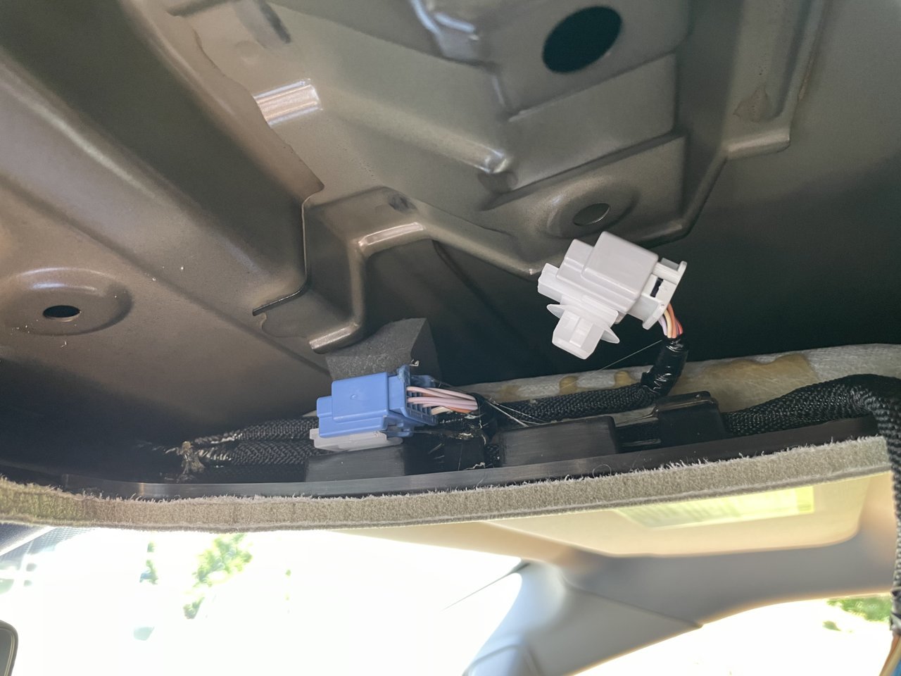

    Mine rattles in 3 places, 2 of which I have pinpointed, the third is hard to find as the other 2 drown out the third.
    My headliner right above my head rattles like crazy. Exceedingly annoying. I have panoroof on mine. If I pull down on the headliner I can get it to calm down. For now I stuffed some gym socks between the headliner and the roof and it has helped a lot. Ridiculous.

    Ok, here is the current list and what has been fixed 2023 Limited with sunroof
    Headliner both sides near the mics for handsfree-Waiting on new headliner
    A-pillar when its cold-should be fixed when the new headliner comes in, very annoying

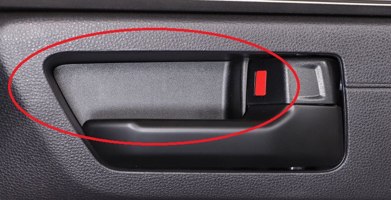

    With some music playing, the small inside panel of the interior door handle will start rattling. Took a little while to figure out because it always sounded like it was coming from around the A pillar instead. Not feeling brave enough to rip the door card off to solve it and end up causing more rattles in the process so I'll try sticking something in the gaps around it to see it subsides.
