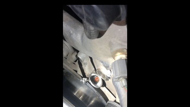

    Replace the driver's side primary tensioner for the timing chain. Fixed this noise before. Pain in the ass to diagnose and pinpoint.

    Yes, I have. You have to pull the timing cover off. It is a solid 2-day job for a professional tech. I am like 99% sure it is the tensioner rattling. I will never forget the pain in the ass it was to diagnose. If I knew how to upload videos I could provide several videos of my theory.

    You can remove the serpentine belt, and remove this large nut on the timing cover allows a little bit of access to the tensioner. Start the engine up, and you will see the orange arm on the tensioner bounce with the rattle noise. See my image.

    I’m pretty dang positive that’s chain slap and more than like the driver tensioner. That’s probably the only Achilles heal of this motor
    Now just install a SC when you/your tech is in there. Getting ready to drop that bomb on my wife. We’ll see how it goes
    :spending:
    If you (or anyone else) figures out it is their tensioner and wants to replace it, this is probably the most comprehensive video. Not positive, but pretty sure I’ve seen them all

    Don't just throw parts at it. Take some steps to pinpoint the noise and diagnose it. But your videos sound just like what I have fixed previously. I remember the noise as a metallic tapping noise that was cyclical. It was worse during cold starts and would go away. And randomly return.

    I don't recall if that affected the noise. The tensioner has a both mechanical spring mechanism and a hydraulic feature. The back side of the tensioner actually has oil passages for engine oil to pressurize the tensioner. So, oil pressure does have an effect on it.
