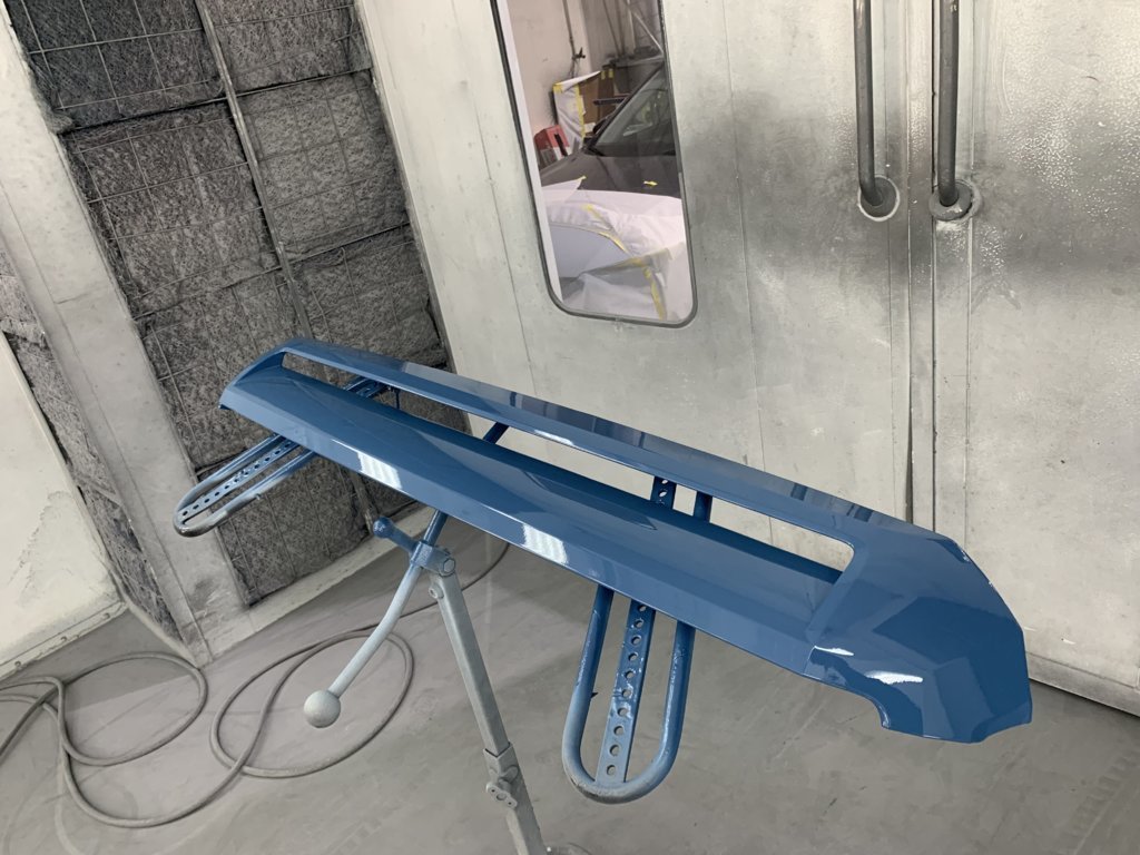

    Do you happen to know how they prepped the chrome? Sanded it down? Special primer? I've always heard this was a no-no to do so, but clearly yours has held up.

    if I rember I think they acid dip it but you can call him and ask he’s super cool, I don’t have that rig anymore but my buddy still has his and he got his painted by them shortly after me and it’s still not chipping or any issues and he does lifetime warranty the paint

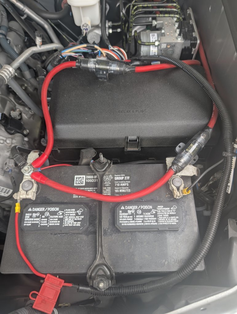

    What does this mean?! Can you pls explain this to me. I don't want my catching thank you

    Make sure the red cable does not lay, touch, or interfere in other ways with other metal parts directly. Wrap it in wire loom. Route directly, cut to appropriate length, so it does not rub grounded parts.

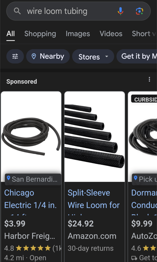

    Here's a better pic. This is how I bought the truck. Precious owner upgraded the sound system. Wire looming is this the stuff? Just wrap it around all the red cable parts? Thank you so much! I really appreciate it!

    Yeah...to paint chrome you need to sand blast the part first so the paint will stick.
