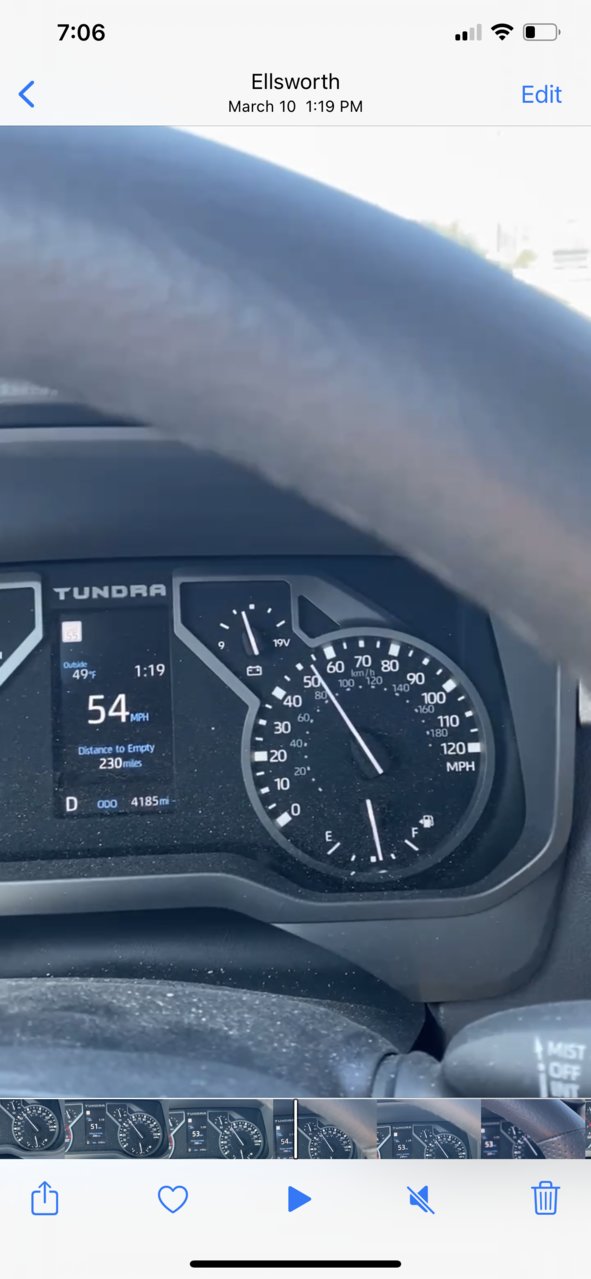

    I have a 22 Tundra myself. It has stalled twice on me. Both times as I was approaching a stop light. Foot on gas pedal, took foot off gas to slow down, stall. Was dead before I even touched the brakes.
    I went to the dealer the first time. No codes. I have an appt tomorrow to have them look at it again.
    I happened to notice one day that the voltage gauge fluctuates up and down big time. I started watching it and realized that I have a rough idle as it compensates. I can recreate the symptom by putting it into drive and holding the brake. In fact one day I caught it just as it almost felt like it was gonna stall. It didn’t but I saw the gauge on the way back up as it seemed to recover.
    I am going to point the techs in the direction of a faulty/underpowered alternator or battery.
    I believe that this is what is creating the stall. I will update this post after I get some answers from the dealer.

    If the battery was charging when the engine starts to stall it makes sense that the gauge moved down. The position in the picture is about 12V. When the battery doesn’t need charging, the alternator is turned off so the gauge goes from 14 (middle) to 12 V. It will move to 14 V when coasting in some situations and if you apply throttle, it will go to 12 V. I don’t think battery is an issue for stalling otherwise the engine would have a hard time starting back up.
