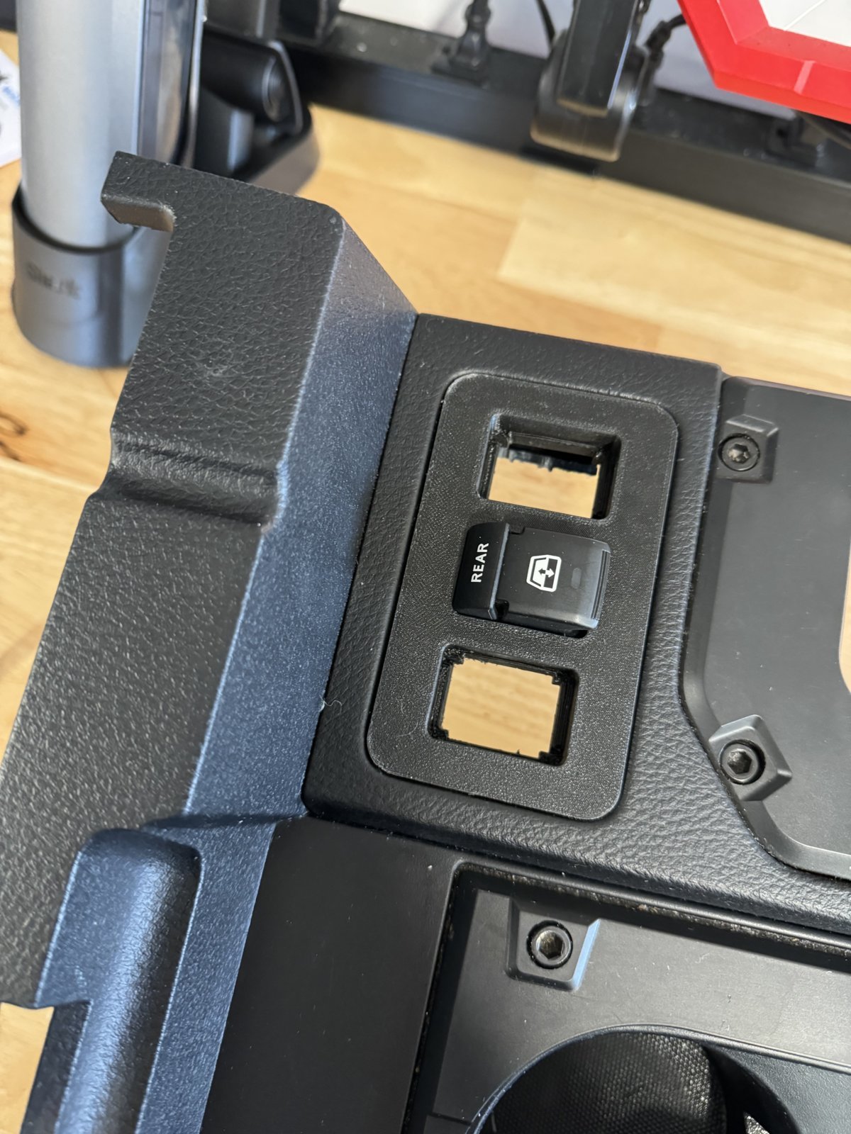

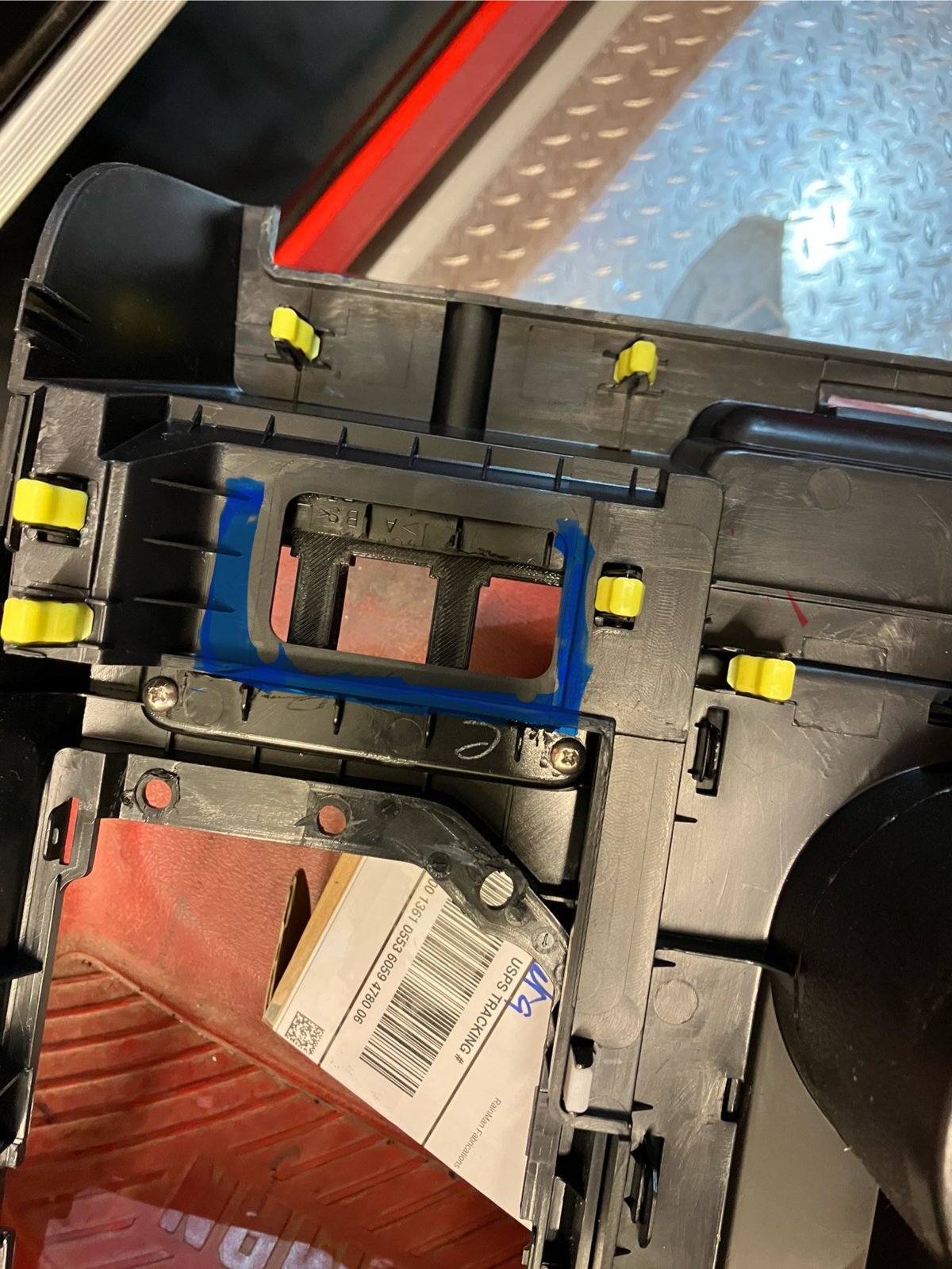

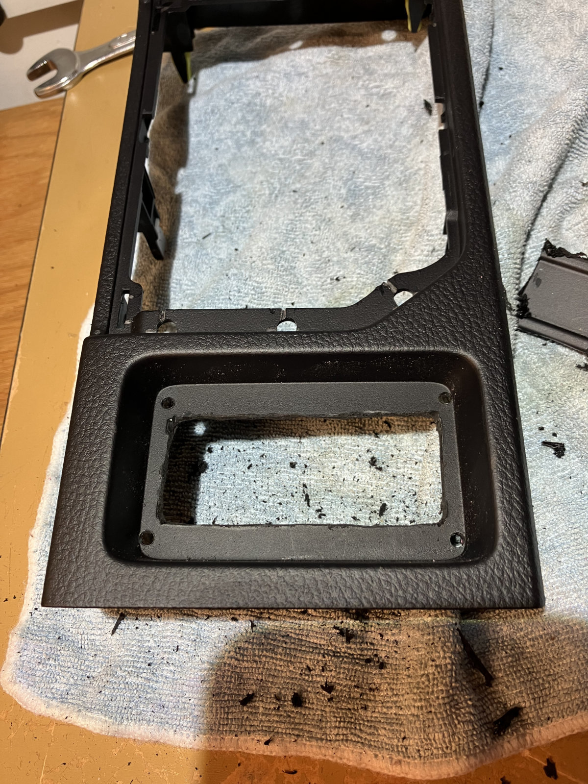

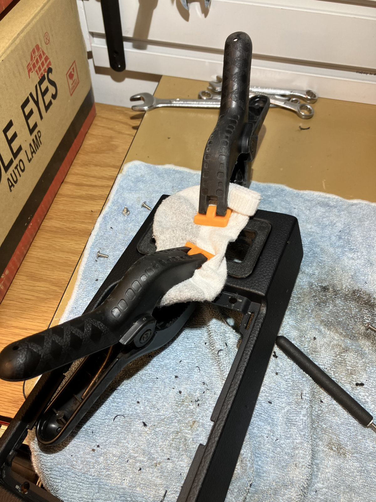

    Package came in unexpectedly, I paid and forgot about it. I purchased the switch holder bc I wanted to move the anytime front and rear camera switch. I had to extend the wires also.
    Templet made it easier to cut, I used a center punch and a dremel tool, it’s not perfect cut but it will work.
    After the cut, clean it up with a razor bc the switch holder sits tight, any lip or debris will increase the height of the holder.
    I used two clamps to hold it down flush while I screwed it down, hand tighten only.
    Once I snapped it back in I realized I also had to cut the other plastic backing out.
    Overall I’m happy with the product, thank you @RainMan_PNW for offering it to the community.

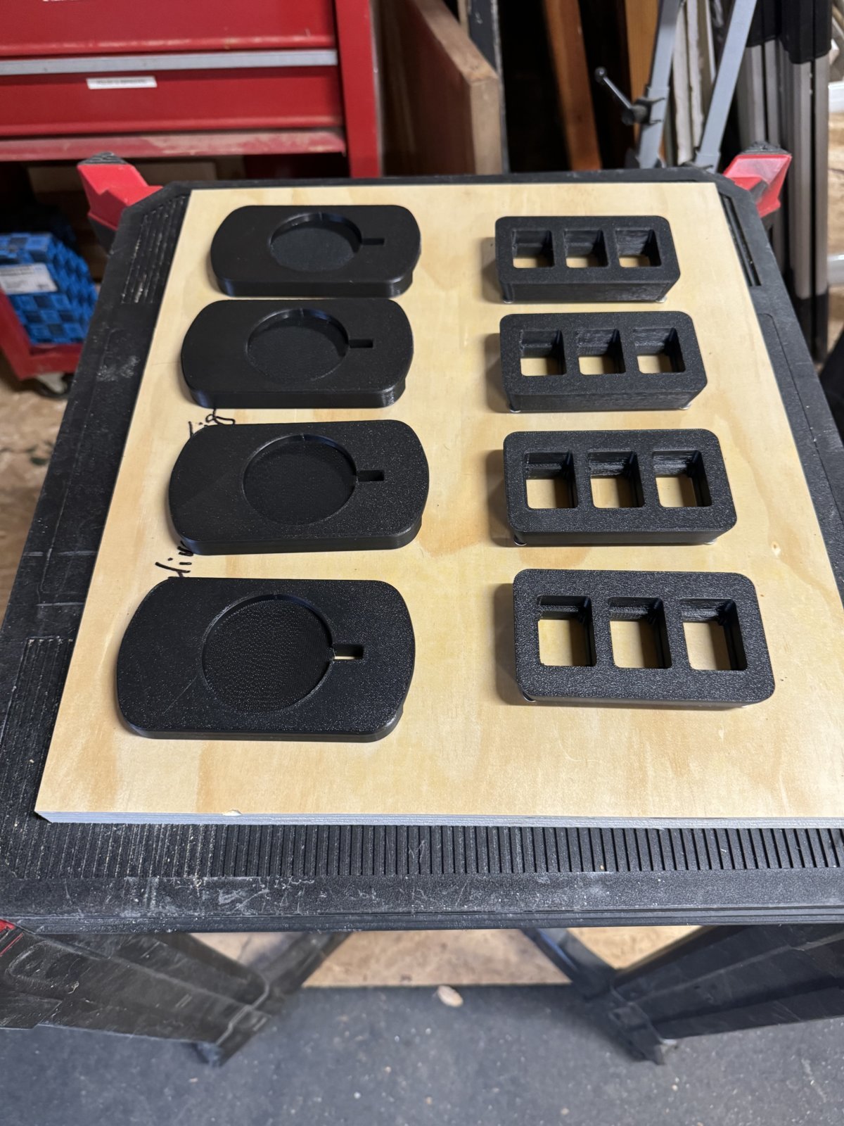

    Getting closer

    Looking good!

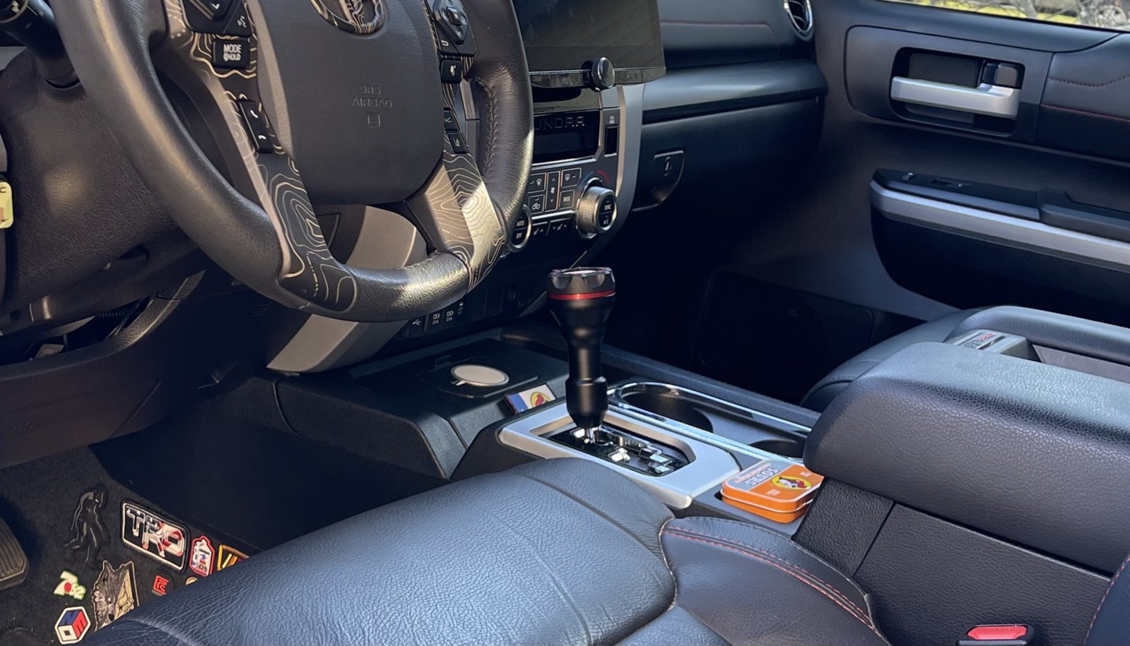

    Got mine from Colton, who ended up with an extra. What an amazing product! Thanks for the hard work Casey!IMG_1479.jpg

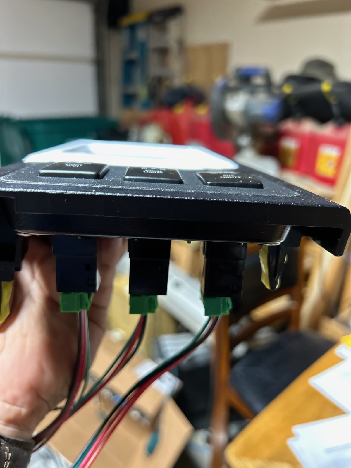

    I received my switch panel sometime last week. I was able to get it installed over the weekend. I still need to order my switches. I'm very happy with the quality of the panel. Thanks!

    What bass knob is that? I tried mine and couldn’t fit it in the blank. JBL amp.
    Thanks!

    It's a JL Audio bass knob. It was a very tight fit in the Toyota blank piece and took a lot of patience to get it just right. I had to trim all the supports on the underside of the blank.
    Thanks!
