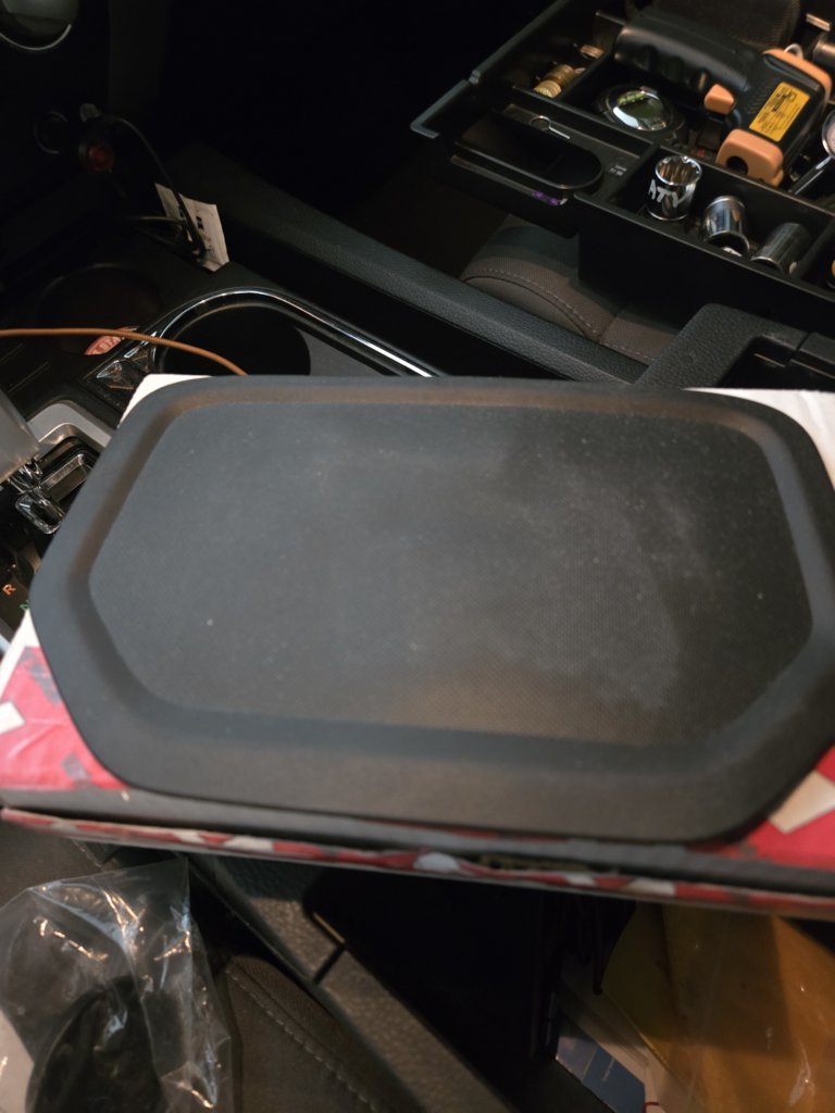

    I wasn't to keen drilling into my dash as well until I found out the dash mat comes out.

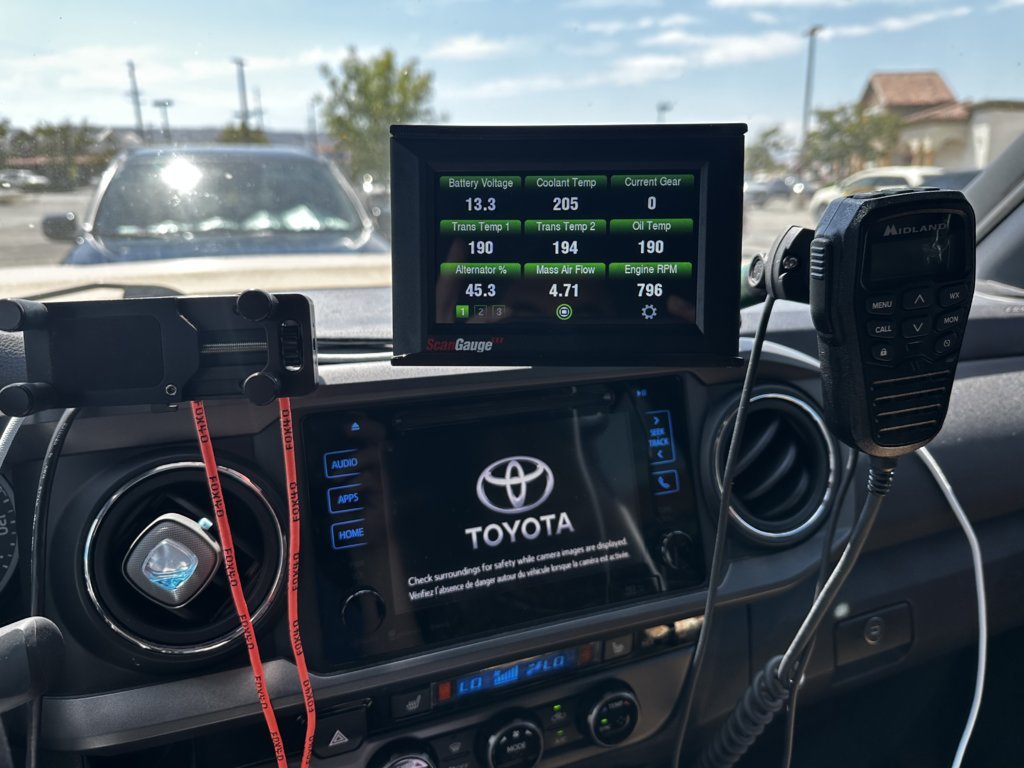

    Yeah I wouldn’t either. The phone would just be one item. I would use it more like this…possibly mount a Starlink mini there as well.

    That oil temp reading is no good though. I wish we had the capability to read it on the Tundra.

    I have a SG3. My point was that the oil temp reading is inaccurate. Tundras don't have an oil temp or oil pressure sending unit to get readings from.

    It's kinda like the AFR reading on the SGiii... It's not an accurate reading of your AFR just what the ECU is programmed to 'request' under the given conditions, but the actual AFR isn't what's being displayed :thumbsup:

    Good to know. I was unaware of this
