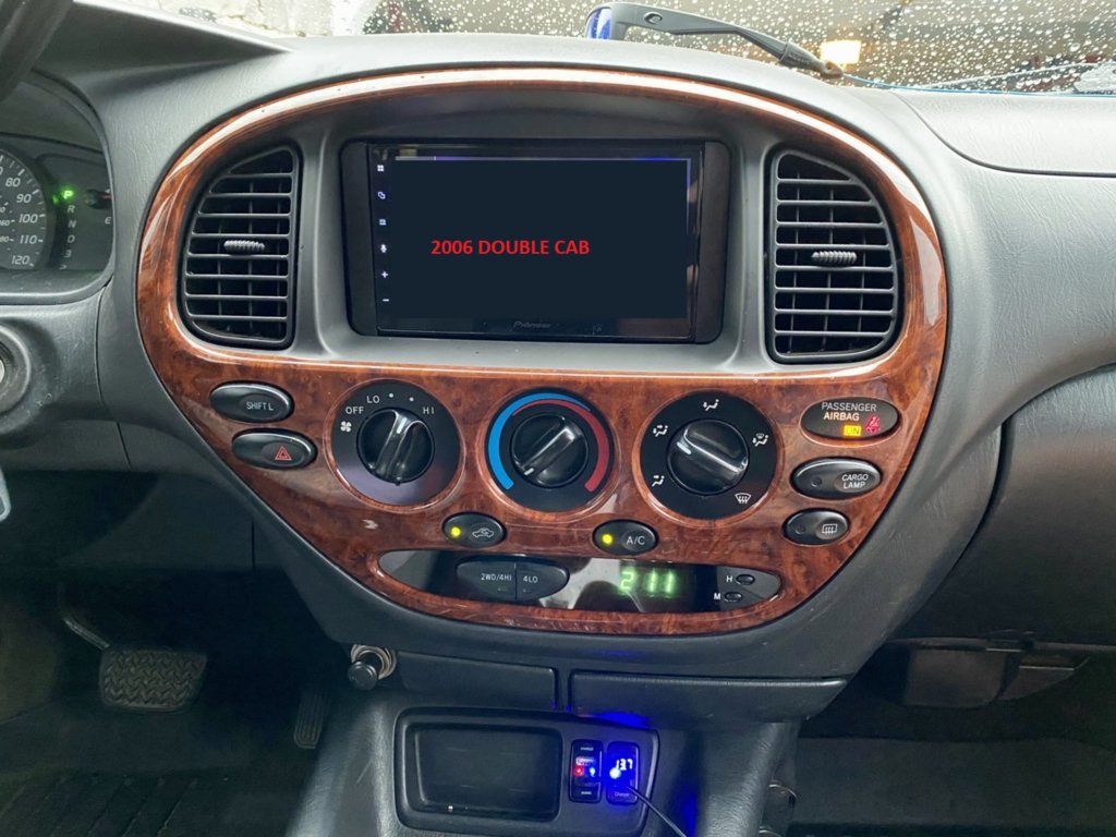

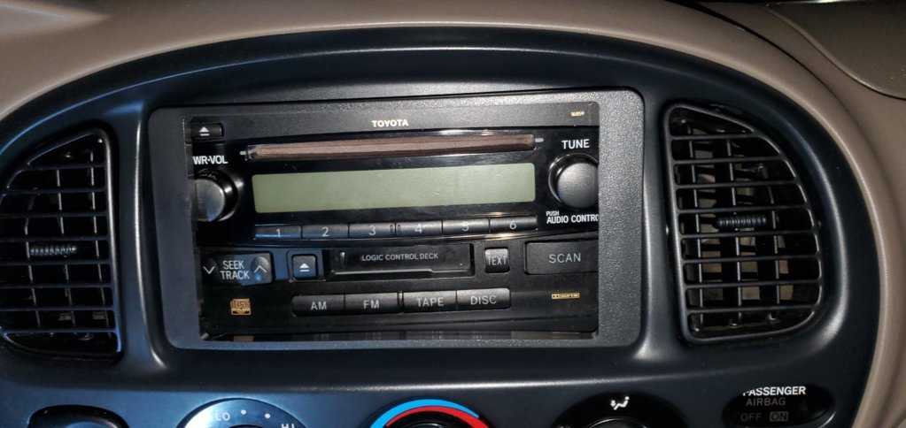

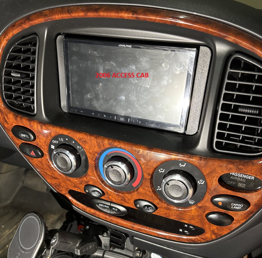

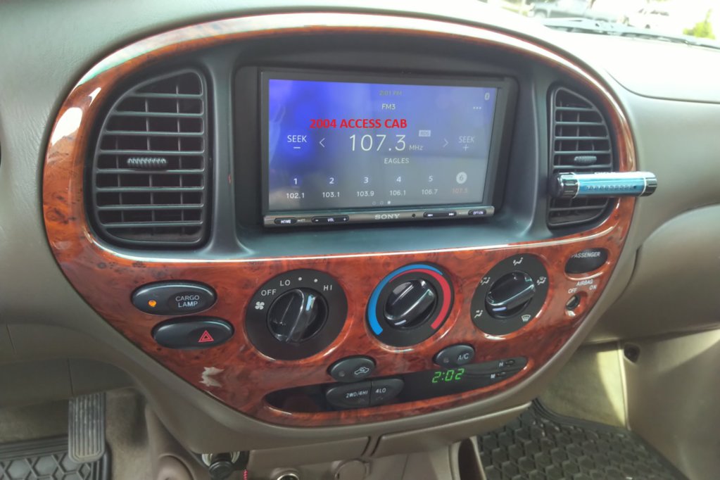

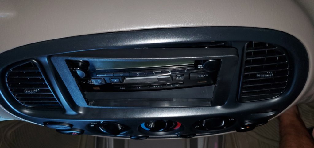

    I recently put a side-by-side on them on here, but this text pretty much explains it.
    But here's some shots to better visualize the differences. Other than the brains behind the A/C controls being different you could swap some later model dashes (AC has a blank where DC has defrost button), but generally speaking, there's a lot of variations over the years. The real bitch is the key lock/unlock location on the right, and added buttons, button position changes. Like, 00-02 has the airbag unlock and skinny opening with wider 4HI/4LO buttons, 03-04 has airbag unlock and wide opening with smaller 2WD buttons, '05-'06 wider opening and lots of differences on the right-hand side. It would also appear the vents on the '00-02 are wider.
    I'm dropping all 4WD trucks here on purpose, but none with the 'Auto LSD' button some of the inferior DC trucks came with, which adds an extra opening, making their dash incompatible with other center dashes. It really is a mess, the dash (non-)swappability of these trucks.
    I still don't understand why Toyota opened the dash up more in the later years. But I do know some Scion (Pioneer) radios with more options fit perfectly in our later-year trucks, plug and play, and there's only minor harness pin changes required to use the 86/FR-S radios in our trucks.

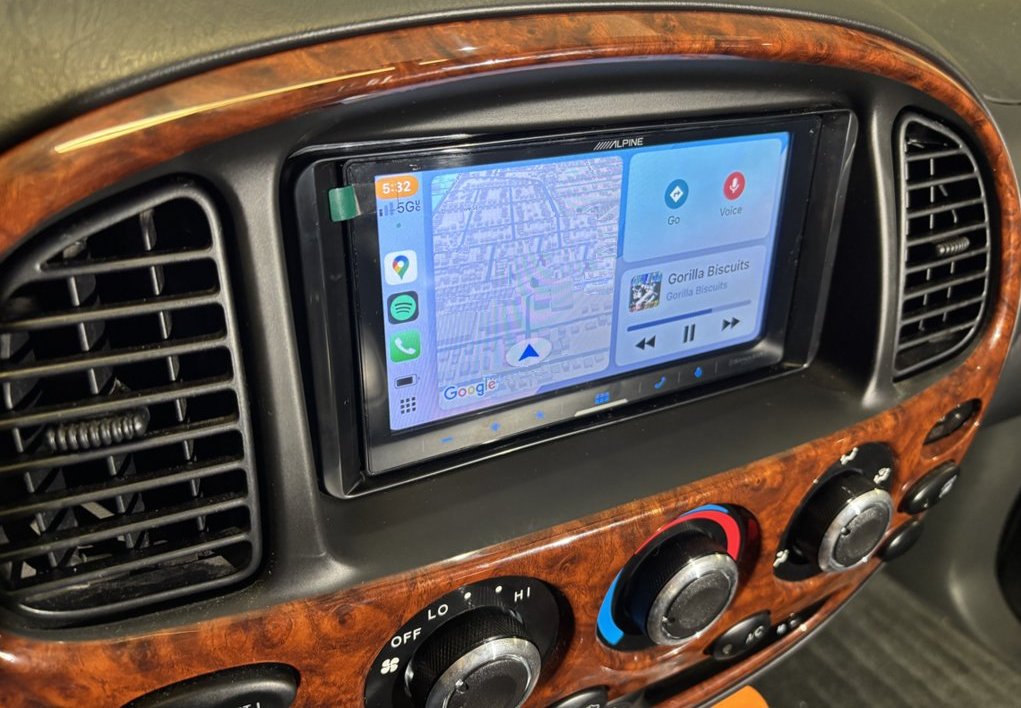

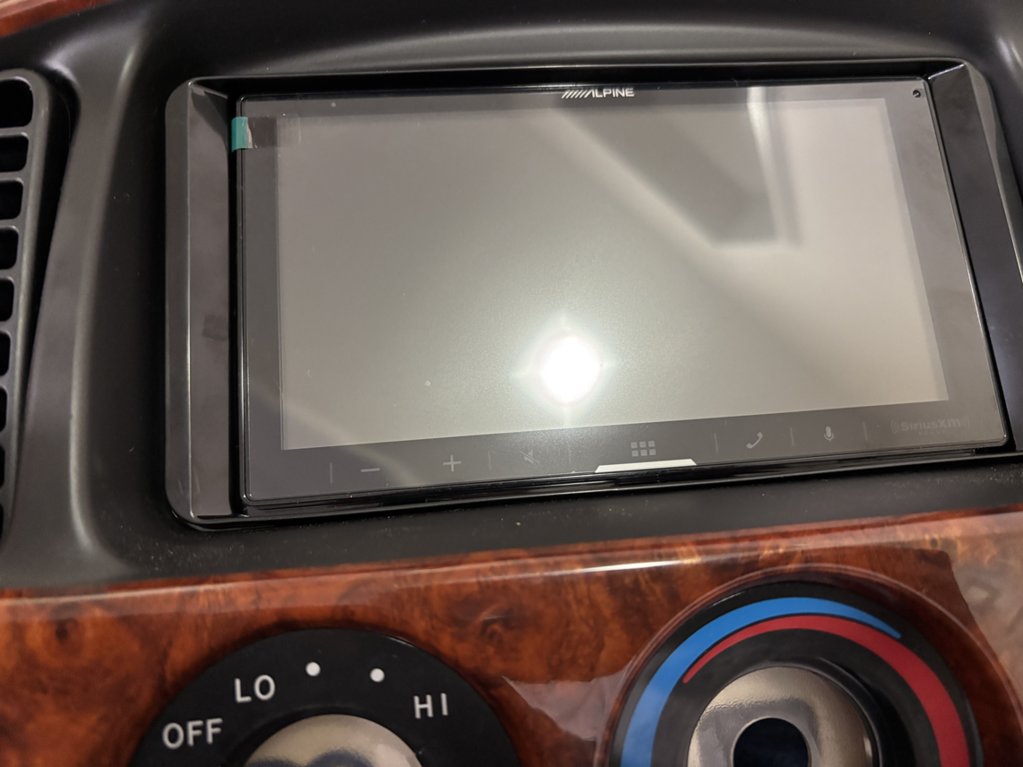

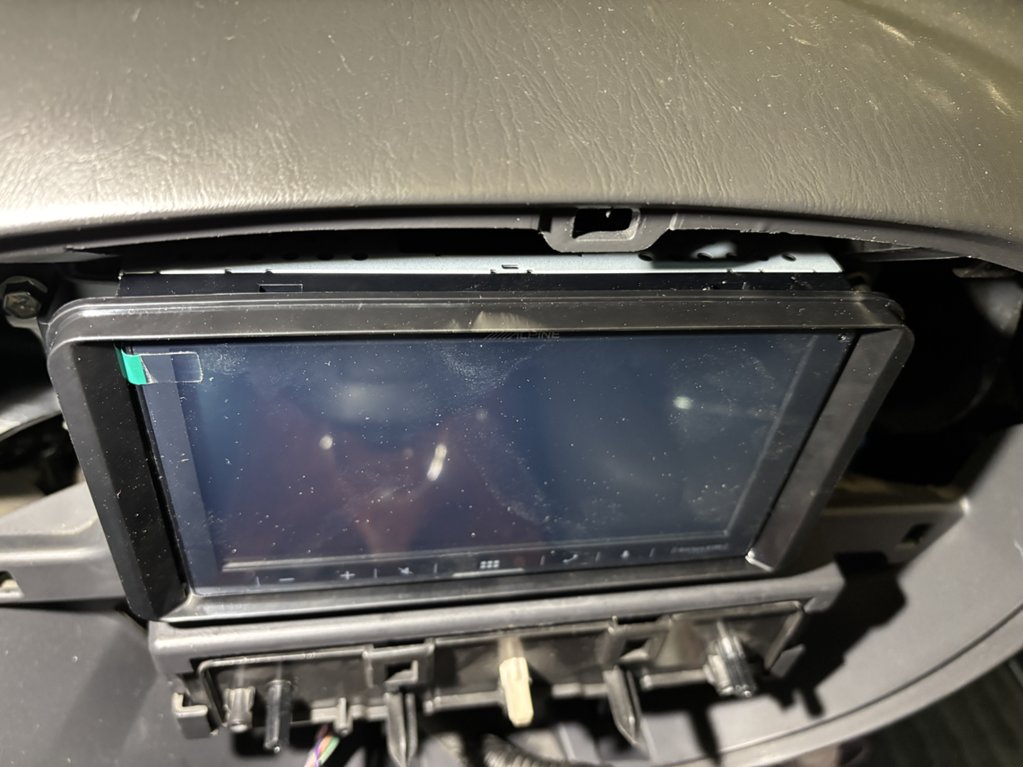

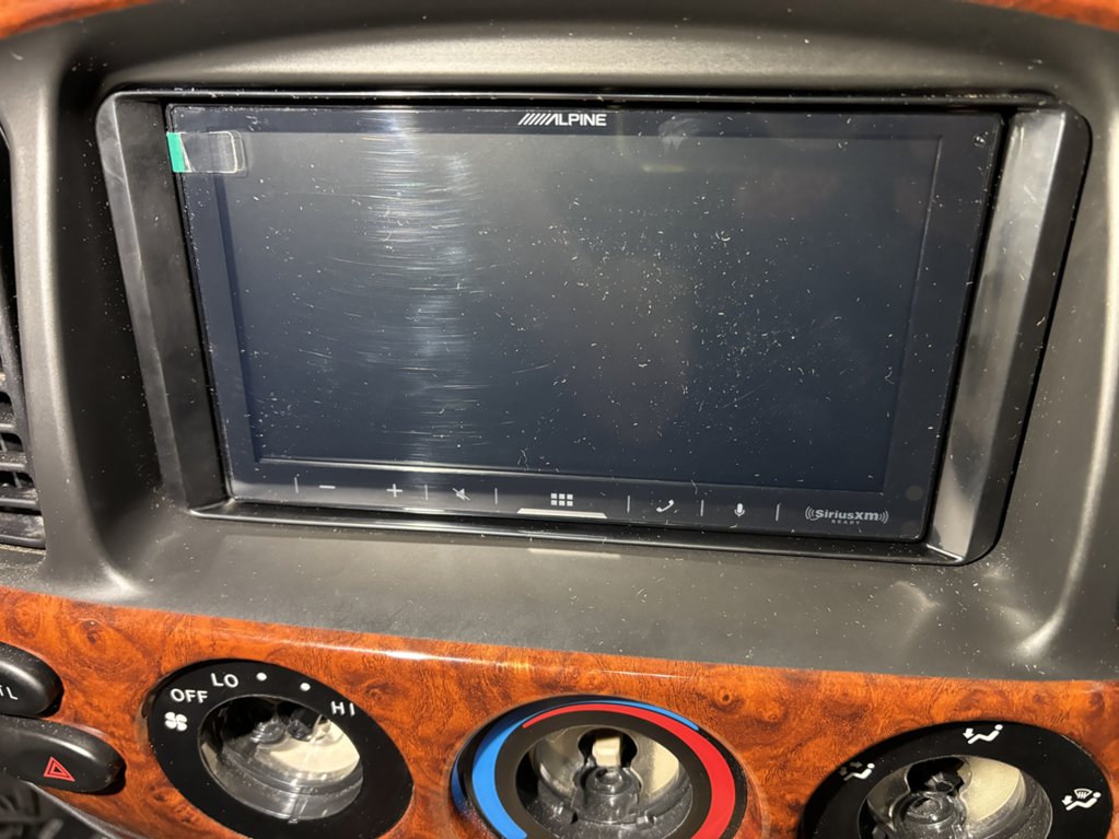

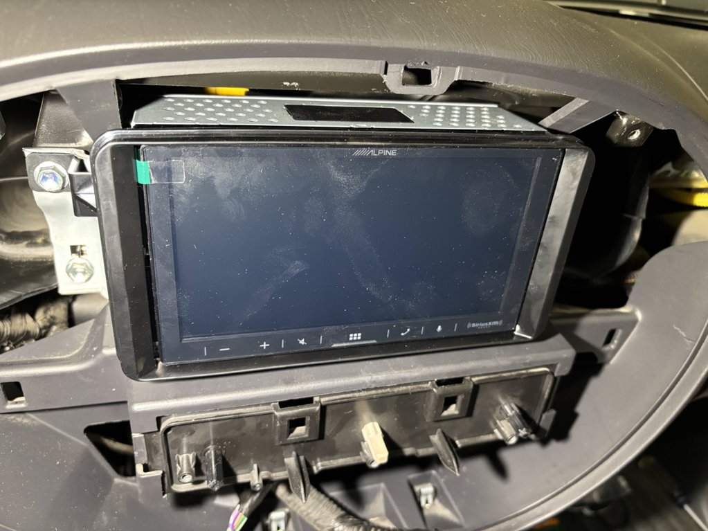

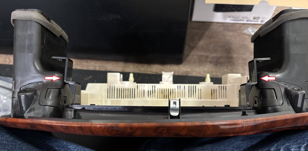

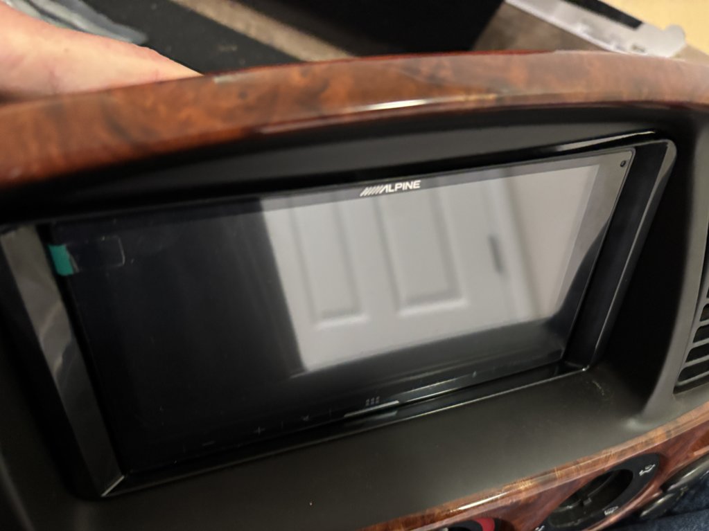

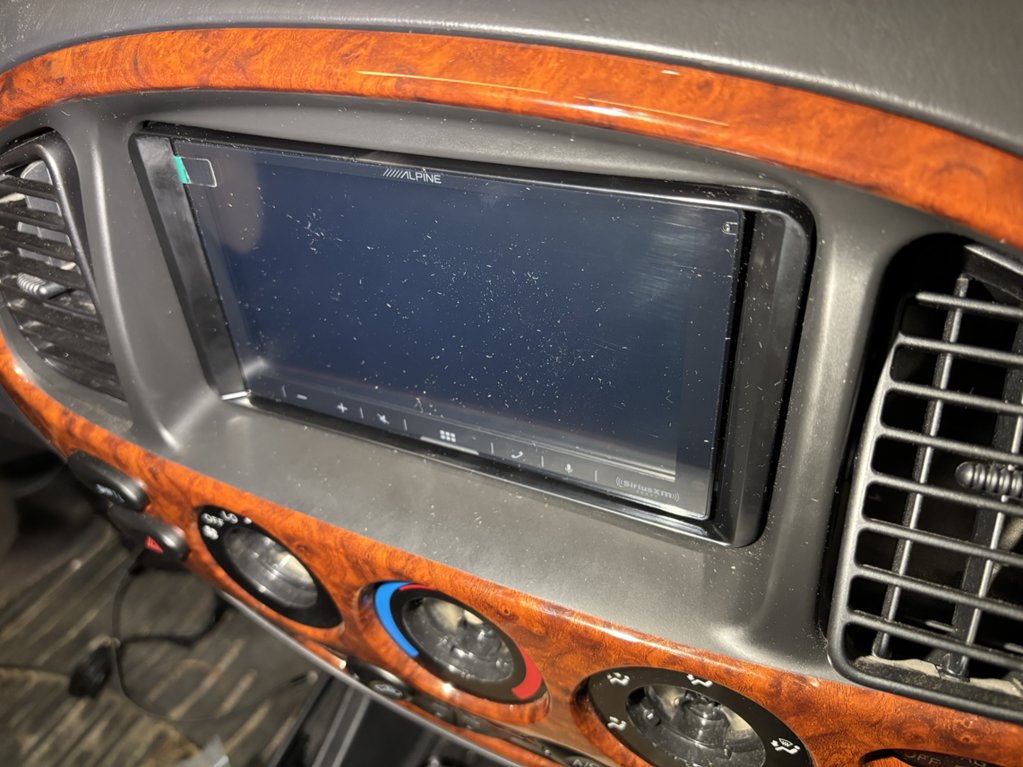

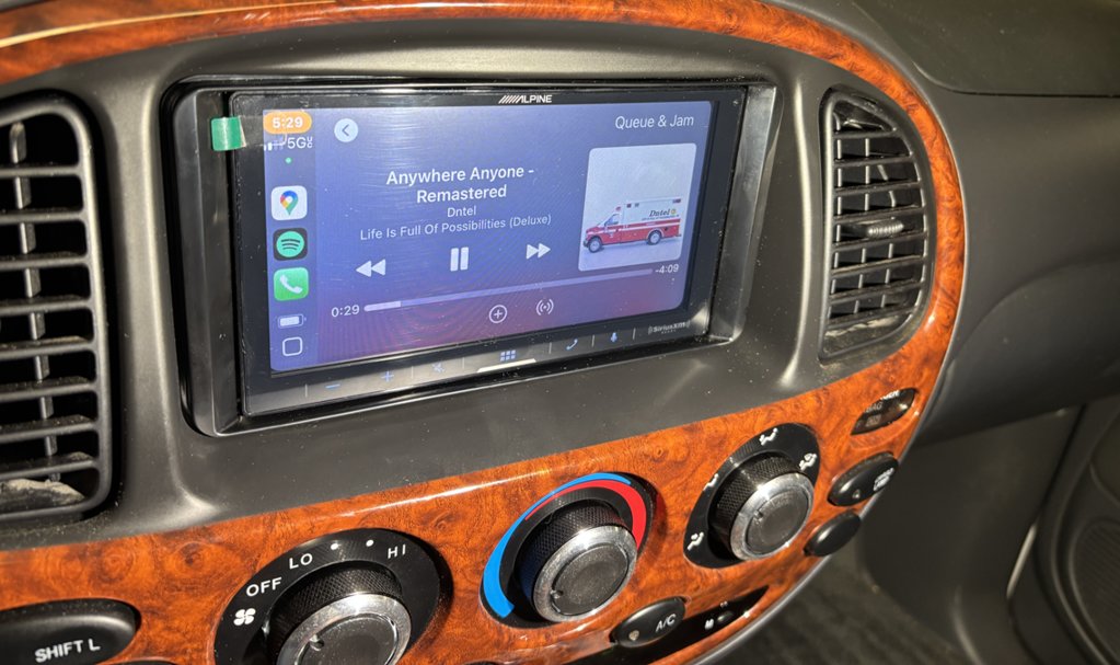

    Looping back on this. I've been using Alpine receivers in my truck and decided to upgrade my ilx-w650 with the new w770 so I could get wireless CarPlay. It adds a couple other features, but that's the biggie. Anyone looking to do a similar upgrade, I'll forewarn you of the differences:
    • The main harness is identical, save for the w650 reverse trigger wire is orange/white stripe and the w770 is purple/white stripe.
    • The microphone plug is smaller, so you've got to rewire your mic or adapt
    • The multi-out (RCA/video) connector is wider on the w770, but it's fine, you need to swap anyway

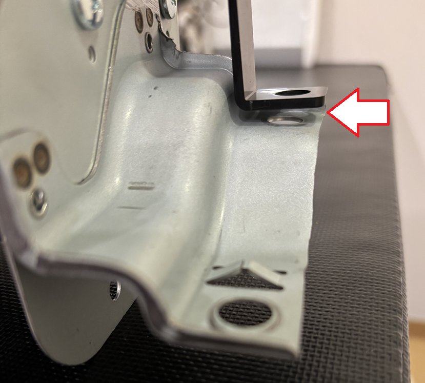

    I decided since I was going to be in there anyway, I'm going to take the plunge and install the Metra 8268 kit and get an all-new dashhole.
    I'm going to post a bunch of pics with thoughts, a little tip also. I found if you shim the kit with a washer (or two) where the plastic arms meet the metal bracket, so the bracket stands 4-6mm off the metal, the fitment works out a lot better. Also, if you adjust the arms all the way inward while attaching to the stereo (for my Alpine at least), and you push the radio upward after installing the lower two mounting bolts in the dash loosely so it's mounted as high as possible, you get the best fitment.
    I also found the 8268 kit would probably slide in a little bit easier, but the arms are engineered in such a way that they don't fit super-clean between the dash vents. Hopefully it shows in the pics. But I don't see any way to make the 8300 kit work, frankly.
    Anyway, on to pictures. Tight squeeze, test fit:
    Mind the gap, this is when the Metra kit is fully seated, and is the gap I was looking to fill. Two washers shored the gap, but at install time, I found only one was needed.
    Install time, fitmet pics.
    And final fitment, showing gaps from a few angles and a head-on. Lots of pics, just to try and get all the angles.

    Probably gonna go in my parent's "new" Jeep JL toward the end of April. But the Jeep has no steering wheel controls, and I dunno if they can manage without. Strongly considering picking up one of the Jensen/Dual receivers with a knob and wireless carplay for them instead. I have a week to mull it over.
    I will say, after making a run to the hard-to-recycle place, then over to Lowes, the brightness on the 770 isn't as good as the 650. But the sound output seems better. Daytime screen visibility was generally OK in the 650, and "alright" in the 770. But it's been overcast, so I have my concerns.
    I don't use the buttons really, except the 'apps home screen' button center-middle. I have steering wheel controls and rarely touch my stereo.
    The 770 definitely feels clunkier on the user interface, which is weird, because I'm assuming they're using the same firmware on the 770 as they did on the 670, both of which are totally different from the 650. I'm going to firmware update and factory reset it some time today, see if new firmware resolves some of the clunkiness. Specifically, the UI in general is poorly organized, adding Bluetooth devices was frustrating as hell on the W770, it doesn't work like any other stereo I've ever seen before.
    There's a slight delay in CarPlay response with button presses, but it's only half-as-bad as what I saw in the W650 using The Magic Link (via USB) to carry over wireless CarPlay. I guess Alpine isn't using a high-quality processor in any of their radios, because I honestly think a 5-year-old bottom-barrel-quality Android tablet could probably handle the CarPlay load more efficiently, and that's kinda sad when you consider the pricepoint of this head unit.
    Still on the fence about the purchase. I do like the 770 has a speed input, but I can't find the damn plug to adapt my OEM 2-wire (speed + reverse trigger) input to tap into it. I also like the 770 adds a GPS antenna, although I'm not 100% certain what it's for, I've always done GPS through CarPlay, teeing off my phone. I've only got about 30-40 minutes of drive time in it, using at least 6-month-old firmware. Staying cautiously optimistic.
    I like the startup splash screen more on the 770. It looks more OEM+. But I need to dig and see if Alpine unlocked the ability to update the splash screen yet. I'd like to do a Toyota splash. I know it's possible with the 407, not sure on the 507.
