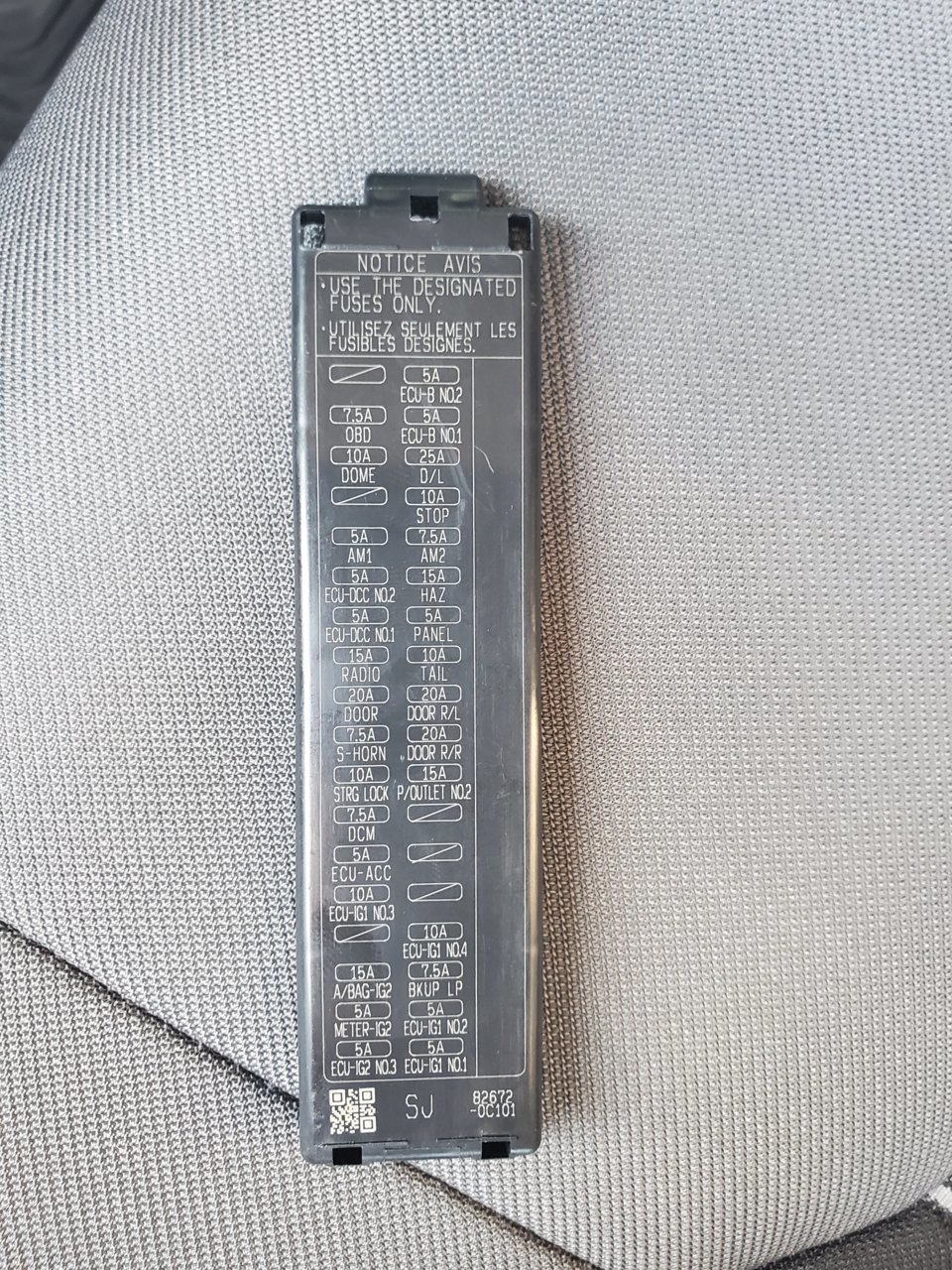

    Problem solved. It was the 5 amp ECU ACC fuse. I did not turn the camera on to see if it blows or not. 20201013_085152.jpg :thumbsup:

  29. Oct 13, 2020 at 6:47 AM
    #59
    29,718
    :yes::bananadance::dancingbacon::broccoli::jellydance::kona::locked::taco::yay::woot:
    Now turn on the camera!
    blackoutt and jewsNbrews like this.
