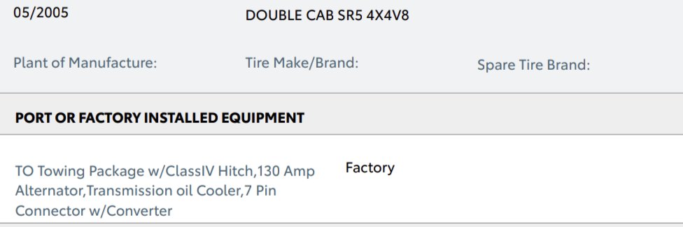

    This is true on my 2005 DC with towing package. Trans oil cooler is in the spec sheet

    Also, LSD is not specifically named on that list of tow package installed equipment for my vehicle but I checked underneath and definitely have it
