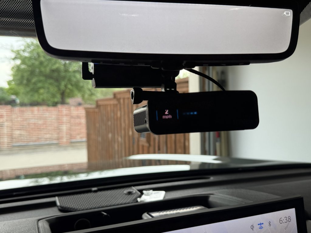

    I'd also like to know the details on this mount. I can see the maker, but the connection piece, did you go w their velcro mount? how are you liking the set up? quiet, doesnt rattle, looks adjustable, hows the angle when using, lastly, hows the plug access in the back? I use the cigarette adapter for inflating river rafts...

    Following...I would also like to know about that Rubigrid setup as I have a very similar radar detector. Thank you much!

    All the components are from BulletPoint. There is no velcro involved....I used their small, round magnetic mount on the shortest arm they have. I took the detector apart and epoxied the corresponding metal plate to the inside (tried the adhesive tape it had on it first, but the heat finally degraded it after a few months and I went the epoxy route). Power is through a MirrorTap wired to the backside of the 12V outlet so the outlet remains usable for other stuff.
    The thing is solid with no movement, flex, or vibrations.
