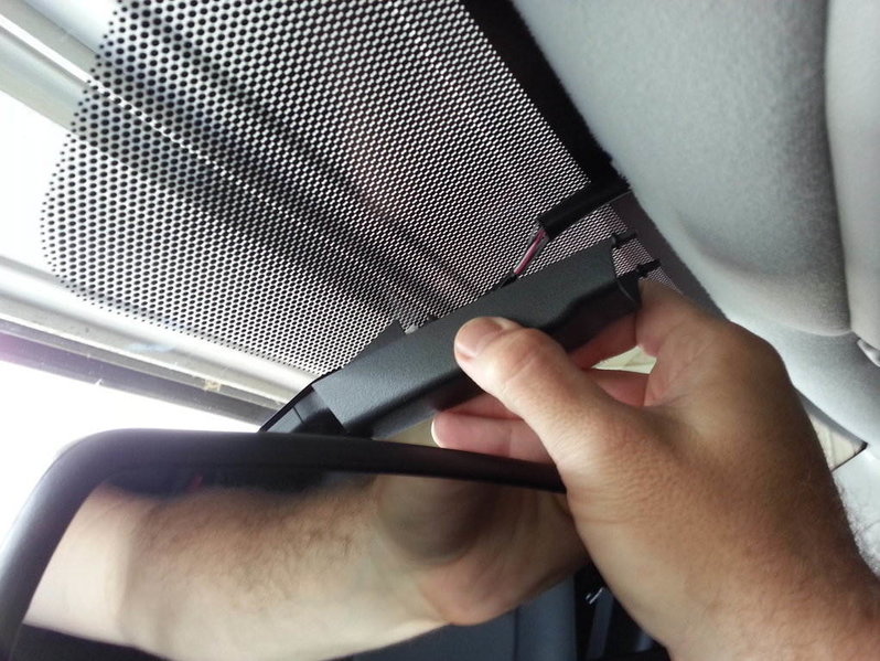

    Please enjoy:

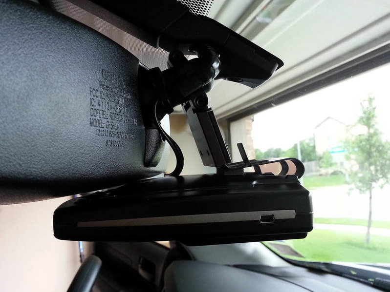

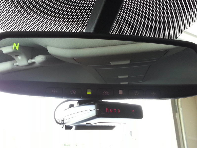

    I just wanted to give a good look at what an Escort Passport 9500ix with the mirror install kit looks like in my 2013 Tundra.
    Im a simple guy, that likes easy instruction and thought if there is anyone out there that isn't so good with DIY's, this one you might just be able to do.

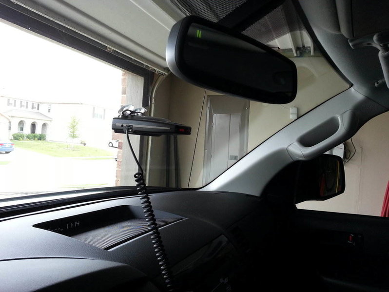

    I was tired of the suction cups on my windshield and the cord draped over my radio.:
    I'm sure you could make a bracket for a lot less than you would pay for this one, but i liked the clean look of this one that I bought directly through Escort.

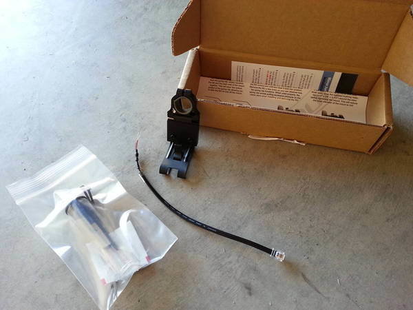

    Here is the kit. A little pricey, but the materials, especially the bracket, are top quality:

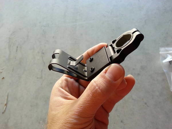

    Bracket:

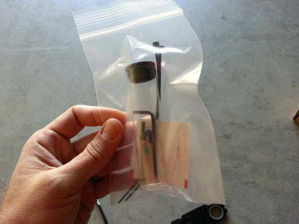

    Comes with everything you need:
    First I took off the plastic wire covers. They easily pop off. This one wont fit after the installation and will not go back on:
    These will go back on:

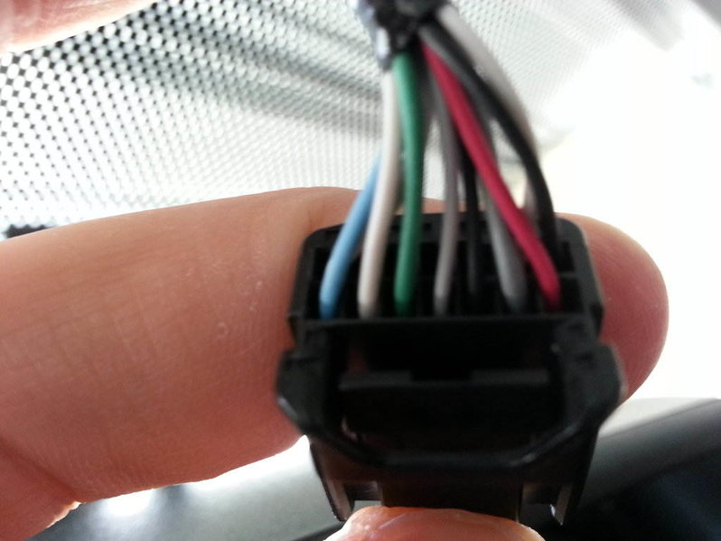

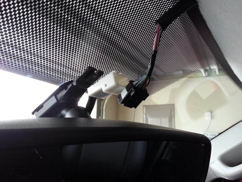

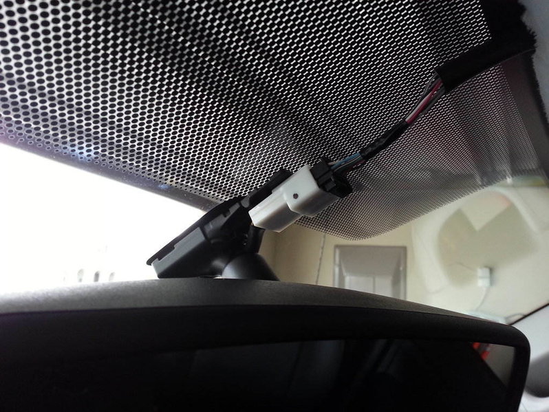

    Wire covers popped off, Slide the harness off its hook and disconnect male from female:

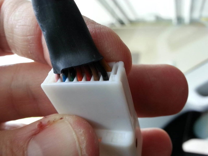

    In the 2013 at least, on the receiving harness, your ignition wire/power is the black wire and the ground is the brown wire. You will see on the male end of the assembly, the baby blue wire is the power (leading to the black on the female part of the harness) and the ground wire is white with a black stripe (leading to the brown wire on the female part of the harness).The best part about this is that you don't need to splice into your factory wires. On the harness (the one on the mirror side, receiving end) you will take the power and ground wire and push them into the correct slot. Don't force it, there is four corners to each wire hole. One of those will let the wire slide in for a nice tight fit. And remember, you will place the power wire in the black wire slot and the ground in the brown wire slot. (Black and brown wires are on the bottom right of the picture):

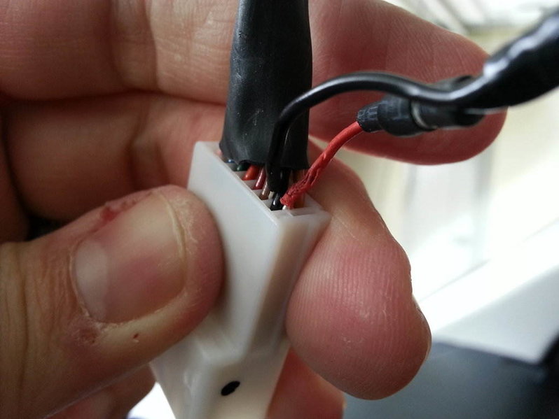

    This is just a view of the male end of the assembly. You will see on the male end of the assembly, the baby blue wire is the power (leading to the black on the female part of the harness) and the ground wire is white with a black stripe (leading to the brown wire on the female part of the harness):
    Wires in the slots:
    I used a little electrical tape, nice and tight, so the wires wouldn't pull out. Here is a tip, when you wrap them up, twist the harness sideways like its actually going to be, then wrap the tape around it. If you dont, when you go to plug it in and start bending the harness in place, your wires may pull out:
    You might want to make sure it works before you get everything put back up:
    Next, put the wire harness back on its hook and place the two plastic covers back over the wires. Then loosely attach the bracket and center is up:

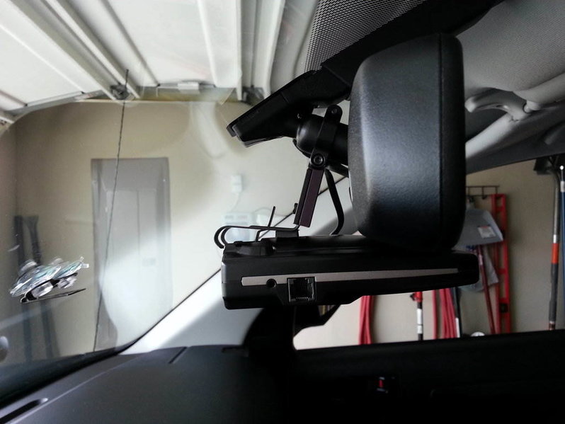

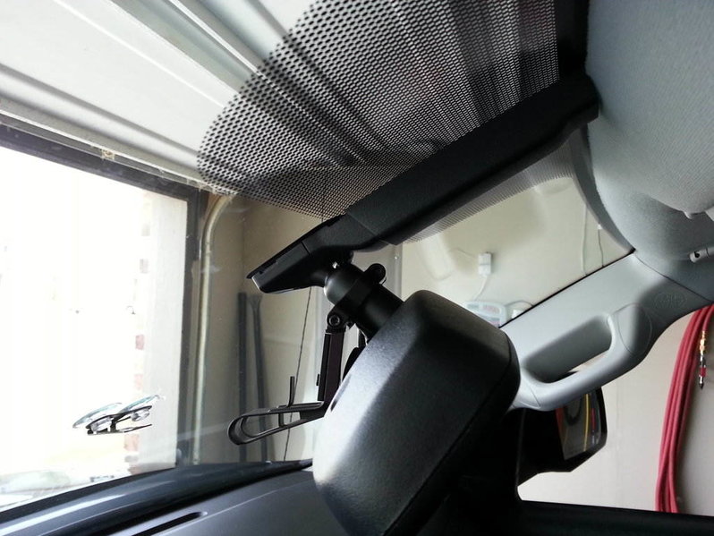

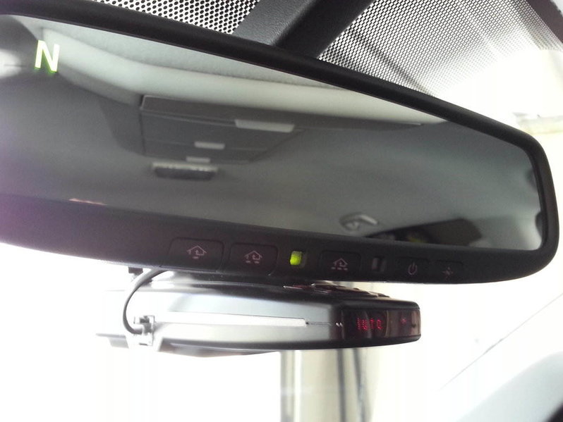

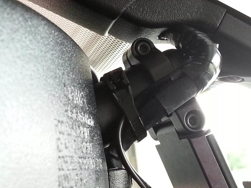

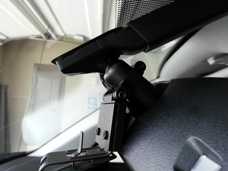

    I clipped my detector on to make sure it was where i wanted it, then I tightened down the screws on the bracket:

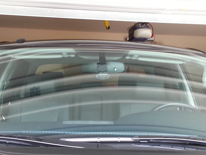

    Make sure its nice and strait from the outside:
    Just use a zip tie to snug the wires down to keep it clean:
    You may have to move it around a bit to make sure its strait, but you should end up with something that looks professional. I think these trucks are so nice and everything I do to mine, I want it to look like it belongs:
    You don't have to buy the kit to have a nice mount. I wanted the quality of the mount I got, but it was a little pricey. Like I said earlier, you could just buy the wiring and make a mount.
    Hopefully this was useful. Thanks!
