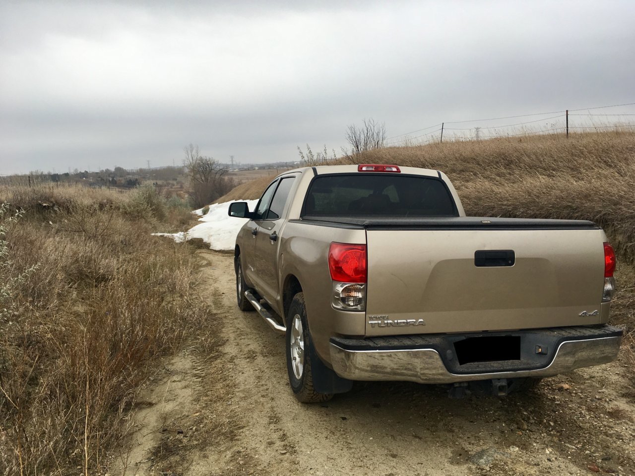

    2008 Tundra 5.7 CM DSM
    Hakkapelitta LT2 studded and 350lbs of sand tubes tied down over the rear axle. 300% increase in traction over last snowfall with Goodyear Adventures and no weight in the back.
    Eta: this is with 2 snowfalls on the goodyears, and then with the hall as this year we have only had 1 12" snowfall and this morning was a solid sheet of ice.

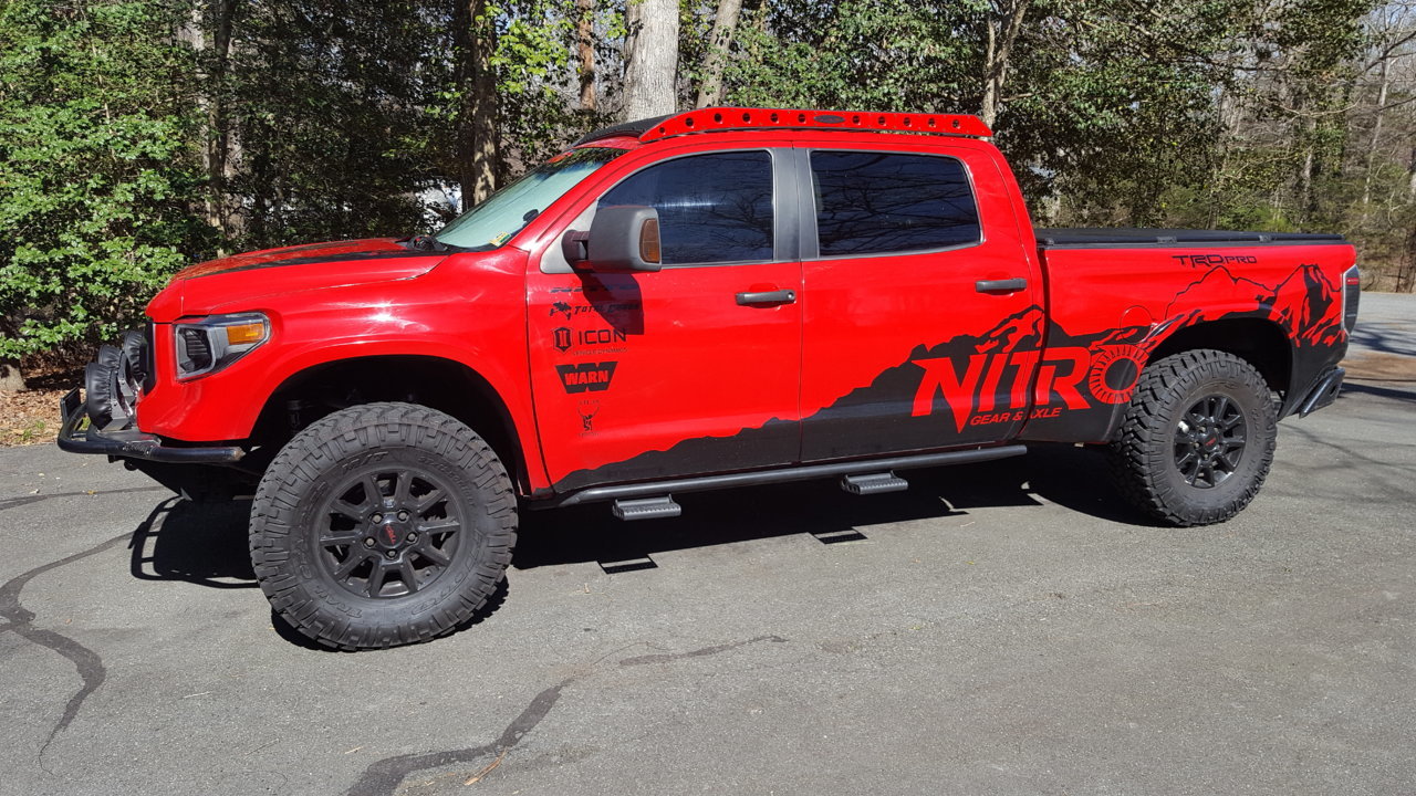

    I'd love to see a pic of your truck if that's available
  17. Nov 5, 2019 at 3:56 PM
    #47
    Kerch71
    Kerch71 Surgical Precision
    Apr 5, 2018
    #14195
    1,709
    Mechanicsville VA
    Here's one. Need to get better pics at some point. The angle on this one makes it hard to appreciate the longer bed.
    Ely010606, Grizzly660, DZ_ and 2 others like this.

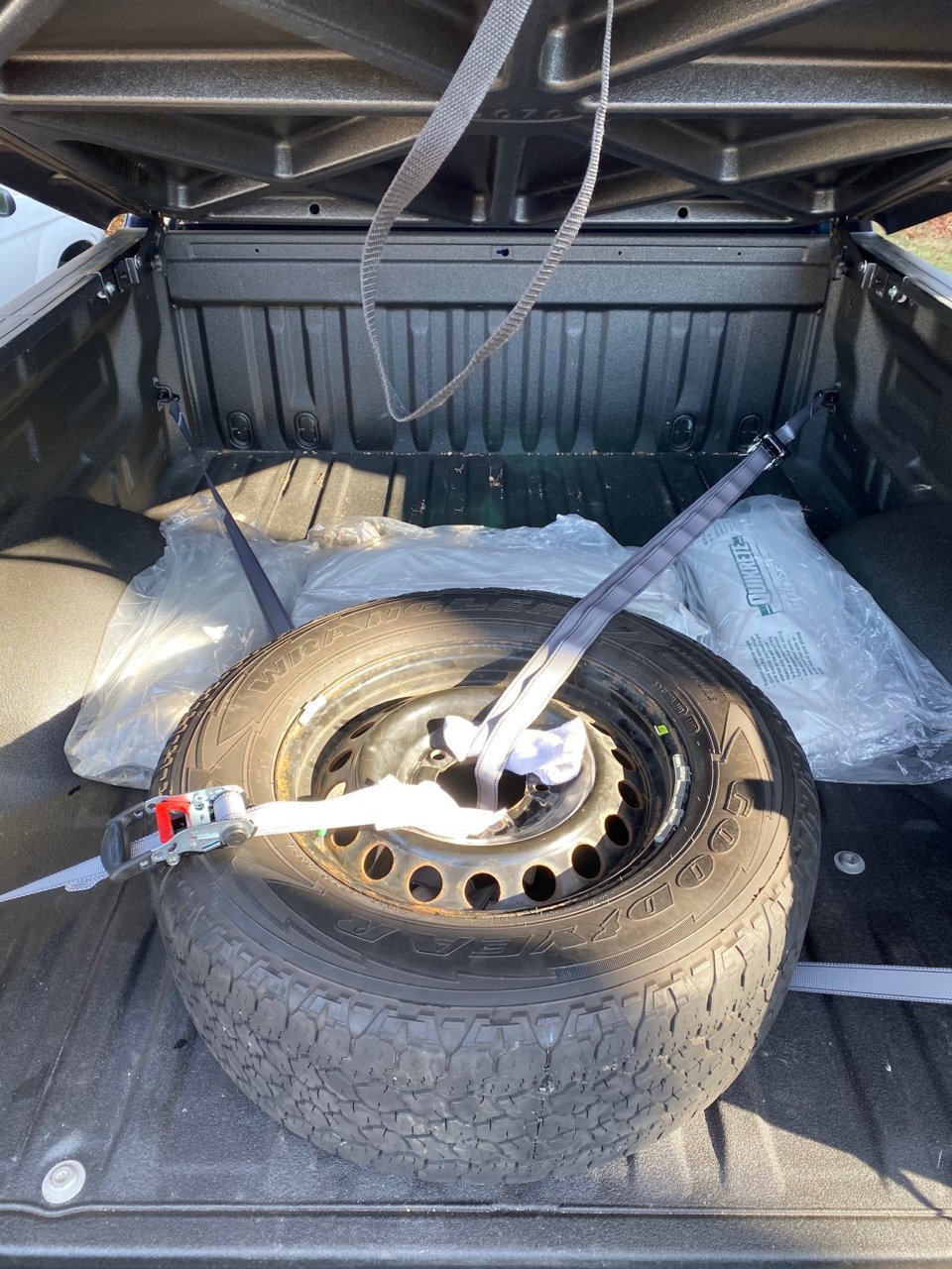

    Dave
    2013 SR5 DC 4x4 5.7 Off Road Nautical Blue Metallic
    Sand bags and full size spare strapped in place. With this, traction control and 4wd my 2013 is a beast in the snow. Has to be, in Maine winter is 11 months long sometimes (seems like it). 59987490-9D37-4504-93EF-57045967E156.jpg
