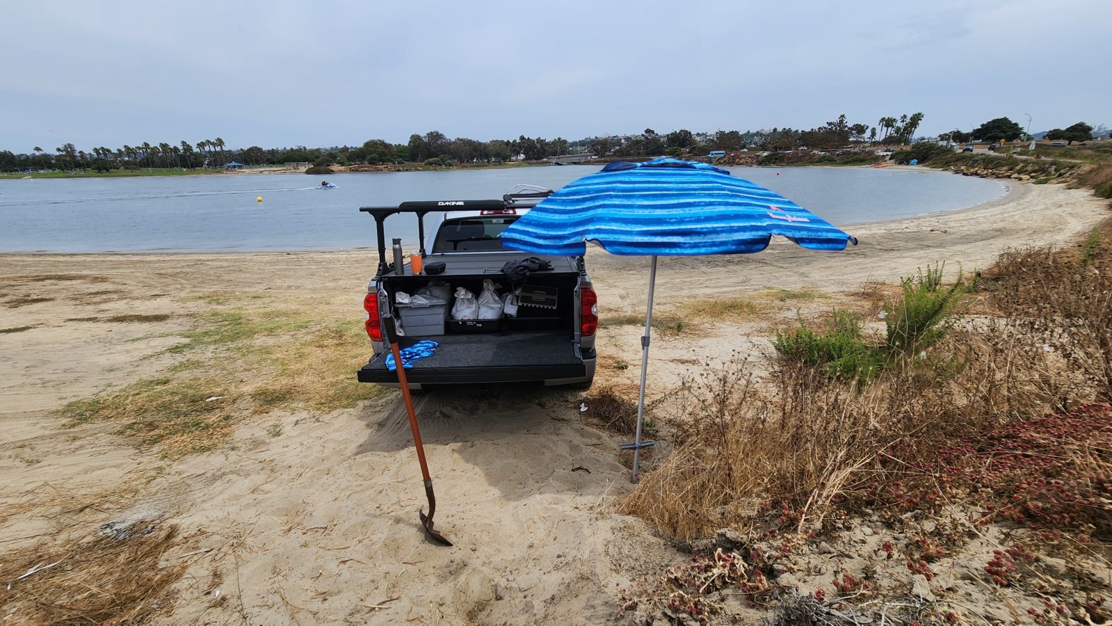

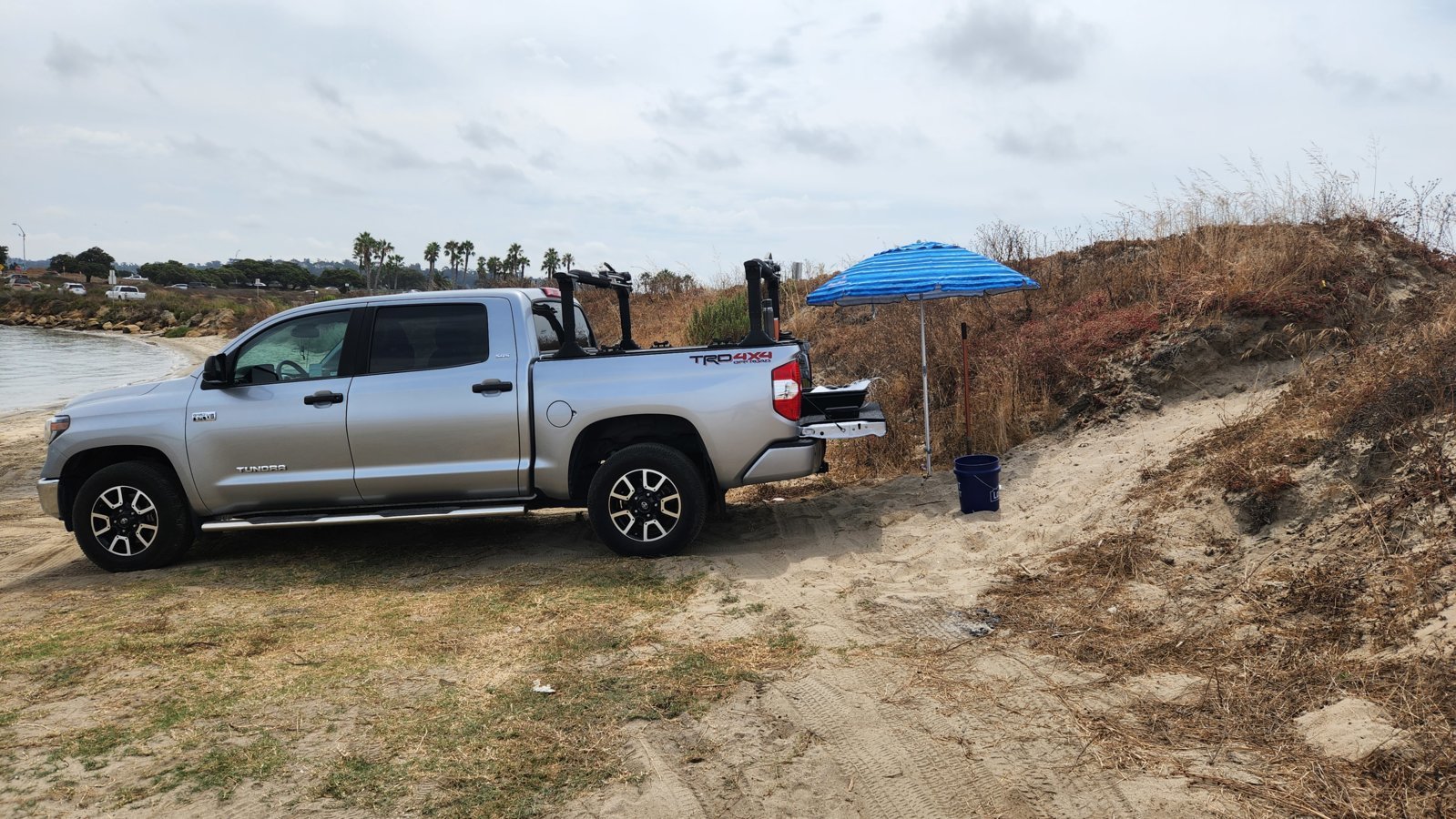

    I live in the city (San Diego) so you kinda' have to make a point to go find dirt to play in.
    Fortunately there's a patch of sand at Fiesta Island down on Mission Bay not far from me, so I'll go down there every so often just to drive in the sand and put it in 4WD.
    Sometimes it's because we're expecting a deluge of rain and I need to fill sandbags so my garage doesn't get water coming in the doors. :(
    Otherwise, whenever I find myself on dirt I'll engage it just to actuate and lube everything.
