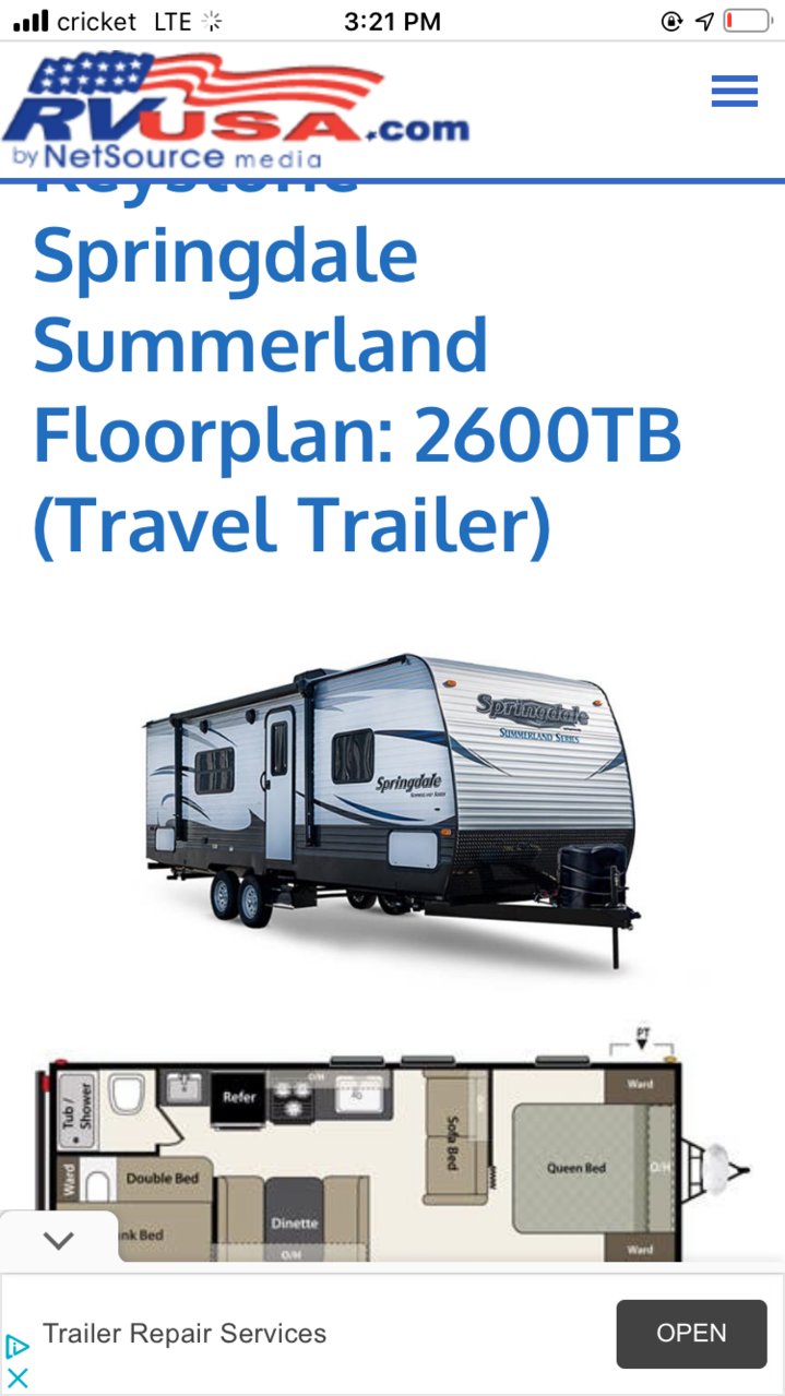

    This trailer is only 4700 lbs dry. Easily a half ton towable trailer. upload_2020-5-27_21-48-11.jpg

    I think he was reading your original post. That first trailer was a whole lotta trailer for a 1/2 ton.
    Nice floor plan!

    Yep, you should be fine. Mine is about 4800 dry, a bit over 7 fully loaded, water etc. Now, can I feel it, yes, but the truck does pretty good. My rule is that I don't want to go much more than about 70% of a trucks rated capacity and at max load, that's about right where you and I are. Be sure to use a WDH, an absolute must!

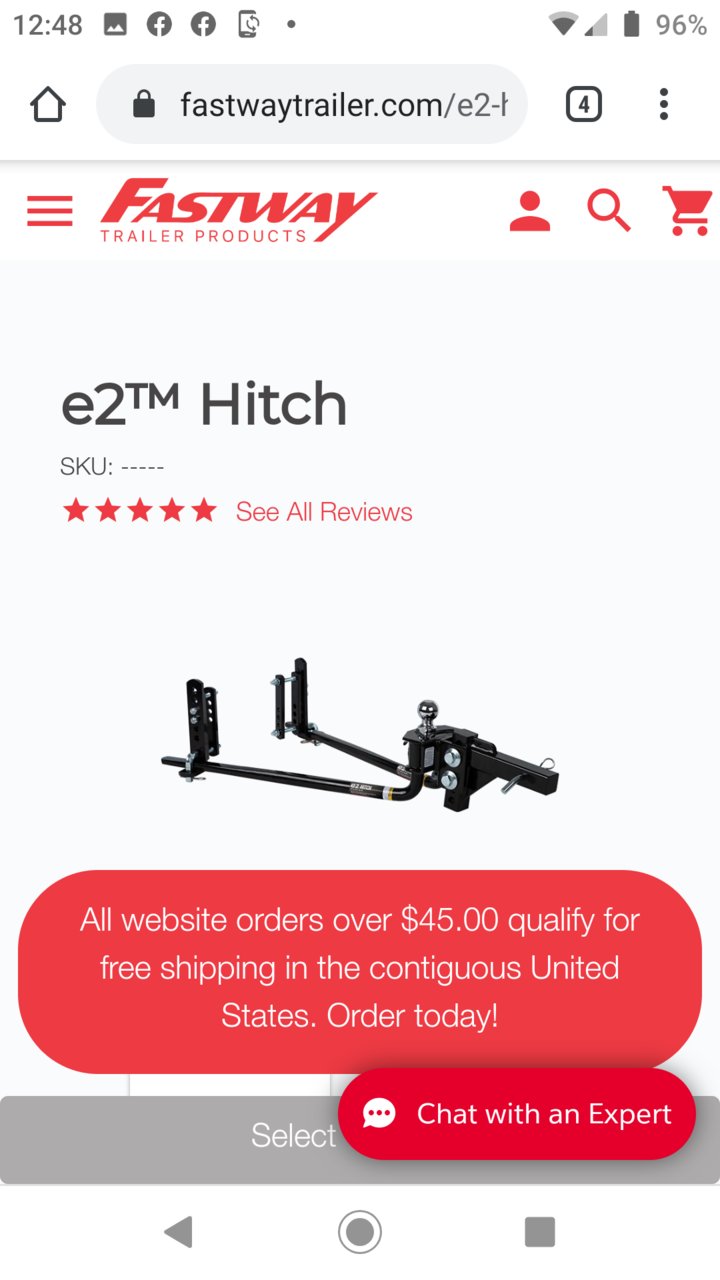

    My next question was going to be what WDH do you recommend? I have air bags and towed it home with just those, but definitely want a wdh before taking it on a trip. I have a 5500kw generator that I can put in the bed of the truck if needed for self contained times. Need to buy all the new sewer hook ups and such also.

    I have the kind of WDH with the solid bars, not the chain type. I really like it. Just make sure you get one that covers the weight you’ll be towing and one that is compatible with airbags. I don’t think they all are.

    Opinions vary on hitch brands but this is what I have and it is a very popular and well regarded hitch:
    https://www.amazon.com/10K-Equal-i-...jbGlja1JlZGlyZWN0JmRvTm90TG9nQ2xpY2s9dHJ1ZQ==
    You mention a 5500 generator, that sounds like it's probably an open frame construction site type of generator. If it is, don't use it. You will be hated by everybody anywhere near you. Get an inverter generator, so much quieter.

    The dealer included this one with my unit. Seems to do the job OK and pretty popular...

    I have this as well.
