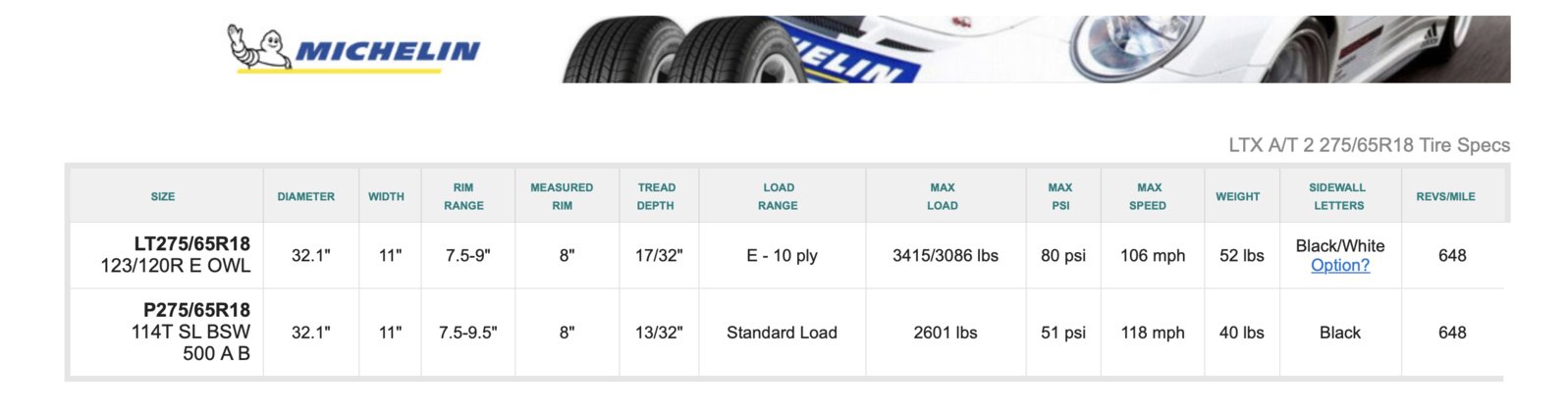

    I have the Michelin LTX A/T 2 (275/65/18) and actually I love the ride, smooth as butter.
    I was wondering what's the right PSI for these tires? They came with 40PSI when I got this truck brand new in Nov 2023.
    I always measure 40 PSI when tires are cold with truck in the garage and they go up to 42 or 43 after driving. Is that about right?

    Sounds a tad high. Are the Michelins E rated? If so I’d try around 38. If they aren’t the LT truck tire version I think you should run low to mid 30’s.

    For sure they're not the E rated according to this chart. What I read on my tire is " Max Load 2601 lbs & MAX 51 PSI" so it must be the "standard load" and not E which 3086 lbs

    Have you tried the PSI your door jamb recommends?

    Not really, I got it new from the dealership last year with 40 PSI in the tires. Now, on the door jamb I have 30 and 33 which makes me confused :) Maybe 37 PSI is a good compromise? Perhaps doing chalk test is the way to go at this point.
    Front 30 PSI
    Rear 33 PSI

    Then run them at 30/33. You aren't running giant LT tires; why wouldn't you go by the door jamb?
    Never assume that because a dealership did something to your truck (like running SL tires at 40psi) that it is supposed to be that way.

    Because I am clueless and eat whatever the dealer told me LOL. I will drop them to 30/33 and go from there. Makes sense and I appreciate the valuable advice here :)

    All good. You're running the stock tires; you'll get best results with door jamb PSIs.
    The only reason dealers do anything to your tires is so they can say they added "nitrogen" and charge you an extra $1k for it.

    Yeah 40 psi on a standard load tire will be over inflated and you will wear the inside of the tire out/take longer to brake/etc. 40psi would make sense if your truck weighed like 2k lbs more curb weight (caulk test would show even contact I would imagine). There are some funny “just rolled in” videos where customers bring in tires with 95 psi in them stating they keep trying to get to 100% full on the dash readout.
