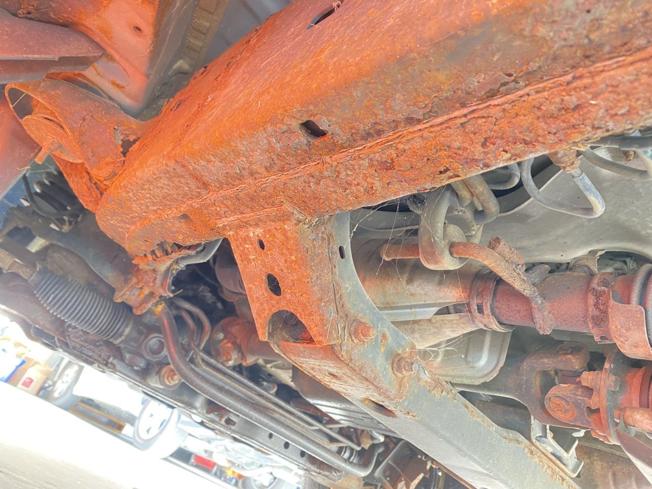

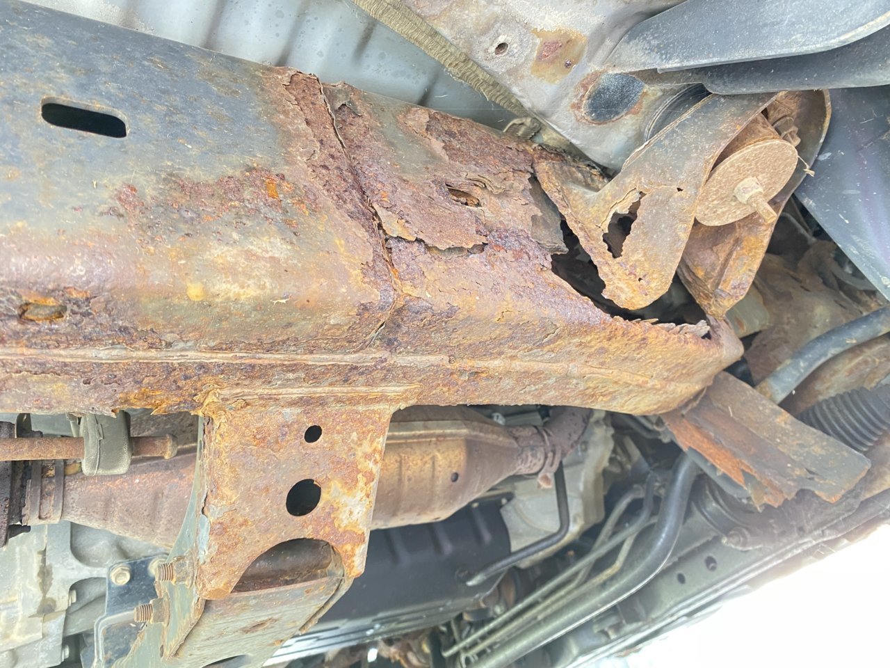

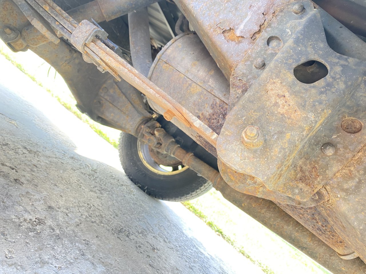

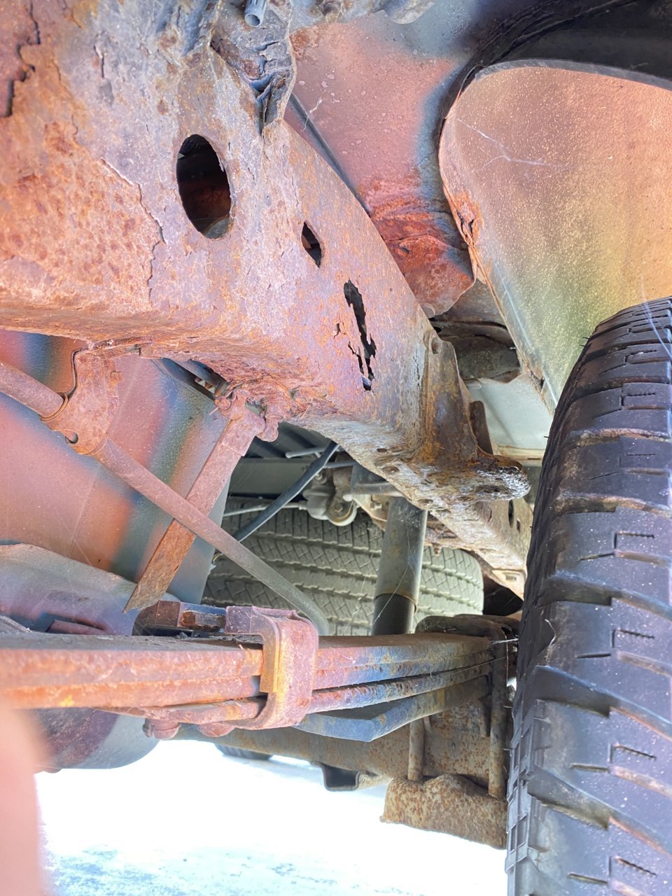

    Here are pics of the framer rust:
    Front Passenger
    Front Driver
    Rear Driver
    Rear Passenger

    The DC frame is toast. Best to cut your losses on that one. Good chance the hardware for the 4wd is going to be inop or extremely rusted as well. Hopefully you didn’t buy the DC and are not having to realize a loss on it.

    What are you gonna weld the safety cap to? The frame in general is rusted and has perforation in multiple spots. Have to have a clean and sturdy metal surface for the safety cap to get welded to, not sure yours has an acceptable landing zone for them.

    Damn, yeah. That's toast. Almost looks like it's been underwater to me, but it's weird, I'm seeing some new-looking fasteners under there, like on the transmission mount.
    There's no welding to solve that. You're basically looking at a frame swap. You'll need to find another DC frame to get that done.

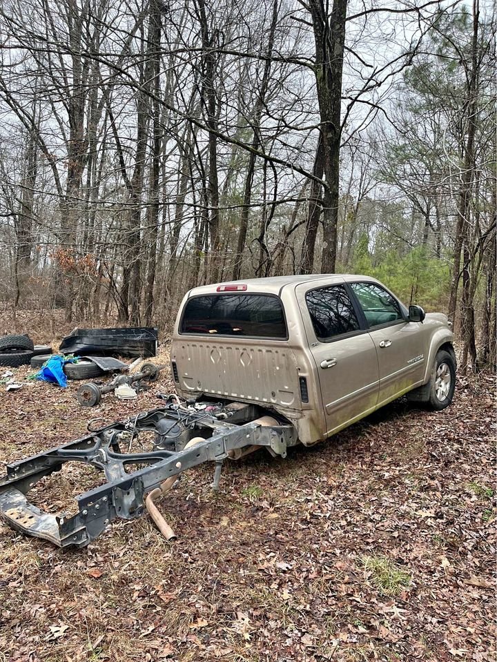

    Not my ad but remembered seeing in my local area Early 2000s Toyota parts truck, have tires , good transmissions , bad motor from what I’ve been told . , what parts you see is what’s left
    365721746_2198009637063971_7250370172667_241f8a1bccd099f4d7c5c35a206a4b8cbbfce9af.jpg
  29. Sep 13, 2023 at 5:27 PM
    #29
    KNABORES
    KNABORES Sarcasm incoming
    Jan 1, 2020
    #40572
    14,477
    Arkansas
    Frame looks good
