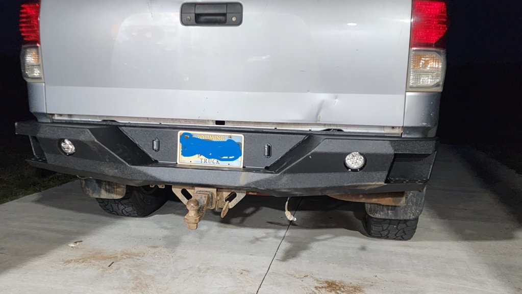

    Needed a decent rear bumper since the oe style doesn't hold up to ranch work, but I cringe when I see the prices and with the front, I learned high dollar and big name don't mean great, so I settled for a hookie off road bumper for just under $500.
    Installation was super easy and it looked great. But I did find the tow points should not be used. We had a snow storm and I needed a tug out of my spot. Shortly thereafter I noticed the bumper was crooked. I thought maybe I installed it crooked. Today I crawled underneath to find the the bracket bent. :( I'll have to pull the whole bumper, inspect it and reinforce the brackets, but for now, I just adjusted it all the way forward.
    If you don't use the tow points or reinforce them it's a nice looking bumper.
    UPDATE: the hooke rear mount that wasn't bent broke at the seam of the bend, so i had a friend make me some 1/4 mounts. so much better now.
