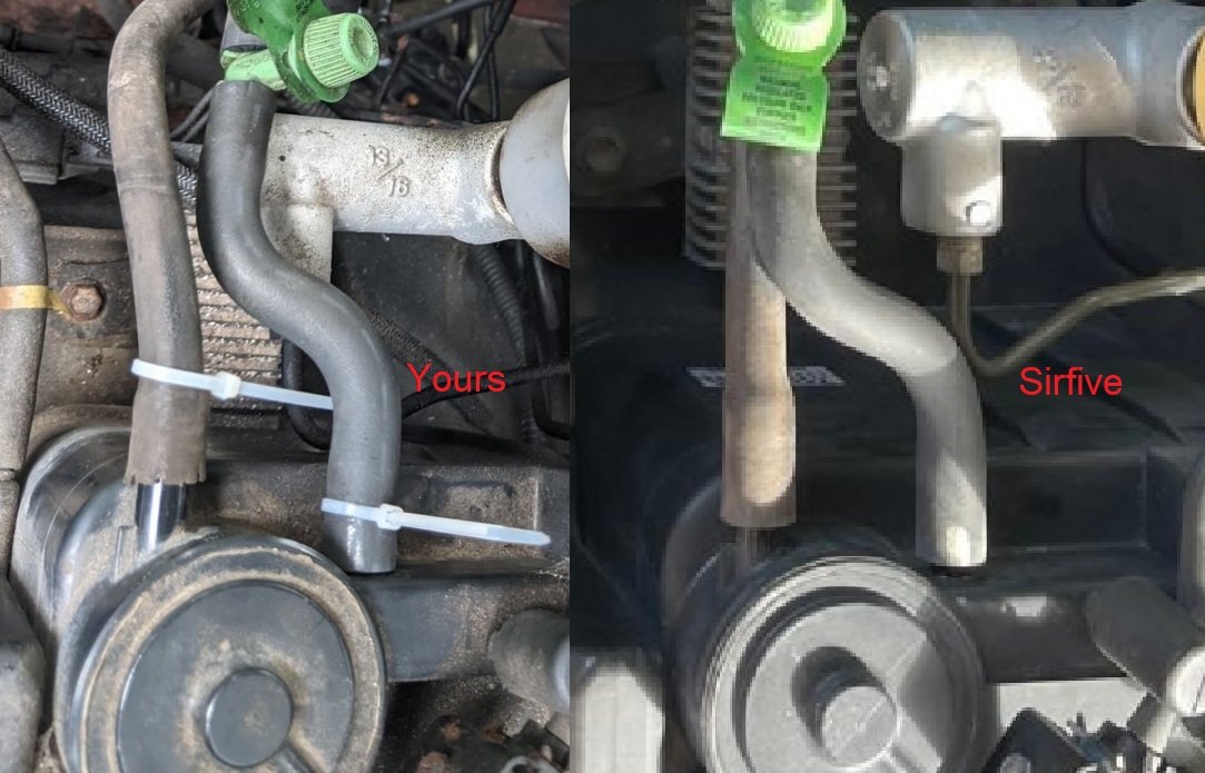

    The overhead pic @Sirfive posted in post # 35 shows how it should be, which has actually been posted more than once and even the FSM schematic is showing the same. I know it’s frustrating and all but if things are still not running good, it won’t be because those few vac lines.

    Ok and to me I think mine currently matches that, do you agree? Concerned because that smaller hose closer to the front of the truck really doesn't want to fit over that outlet.

    Yes and you can thank yourself a thousand times :)
    What I don't agree with or perhaps don't quite understand how hooking those vac lines the right way caused this massive fuel leak.

    Taking a stab in the dark, someone else mentioned doing this wrong pressurized the fuel tank, which was probably more than enough to pop an old hose on that end.

    Took a look at mine and you can see it in @Sirfive pic also, the original hose comes somewhat belled on that end or once on, it definitely should not leak :notsure:
