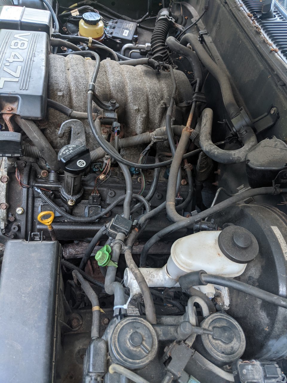

    Ok, I can fix that.
    As for your fuel issue, @Sirfive mentioned fuel lines related to your fuel smell/leak which is somewhat more important than a vacuum leak. The pic showing Input and Return are your fuel lines. Try and keep that separate from your vacuum leak as far as trouble shooting.
    As for your vacuum line issue, from my couch the below pic you posted seems to look fine but with all the info you have been given plus pics, surely you can see the proper way. If you still are unsure, post up a new pic showing everything the best you can and those that can help will try to assist.

    Ok but given there was no fuel smell before and these hoses don't seem to have been on these tubes before I'm guessing the pic I posted of where they are now (with one ziptied) isn't correct. Just needing to understand which is wrong and where it goes instead.

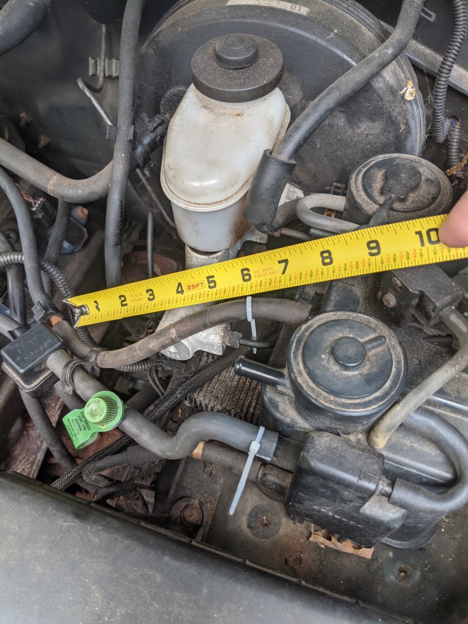

    We'll try that when I get back but I'm not confident the hoses are even set correctly at this point given the conflicting photos and diagrams. Also now it's doing a very odd chirping sound it seems to increase with speed but I can't determine if it's related to being on the throttle or not

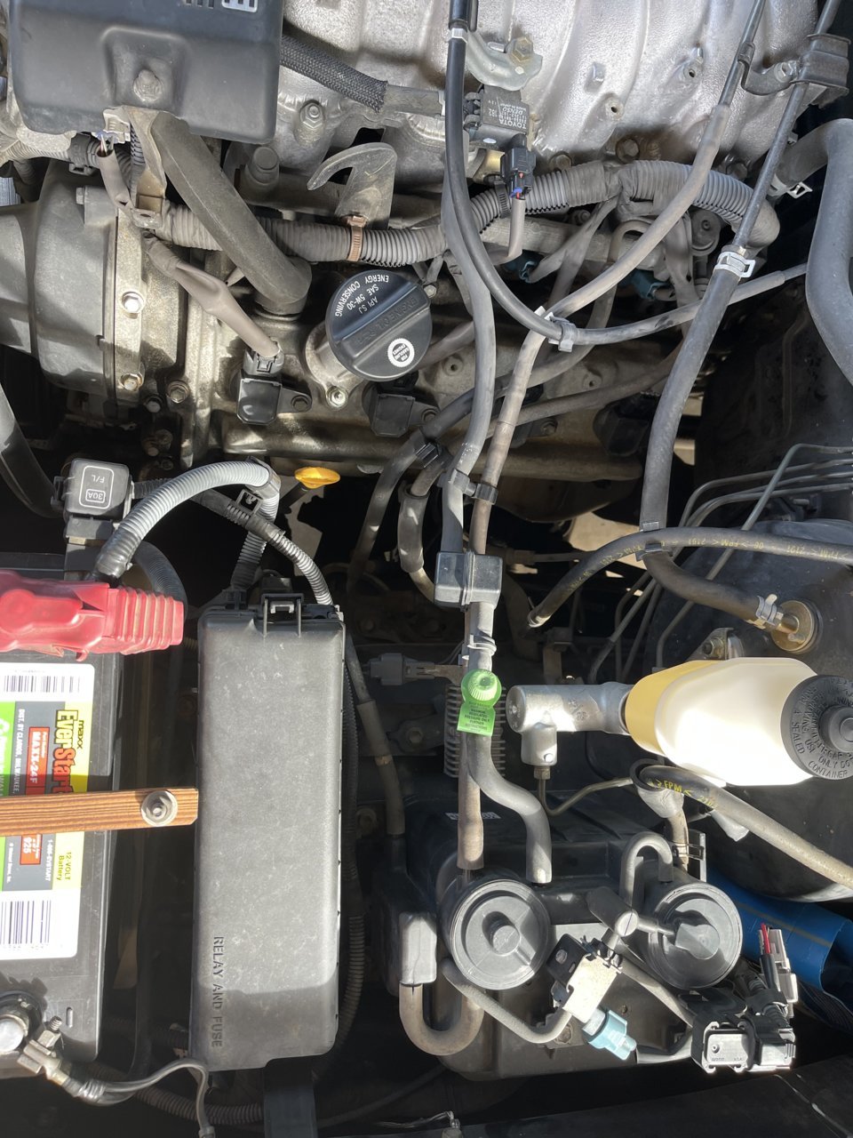

    Mine follows my diagram.

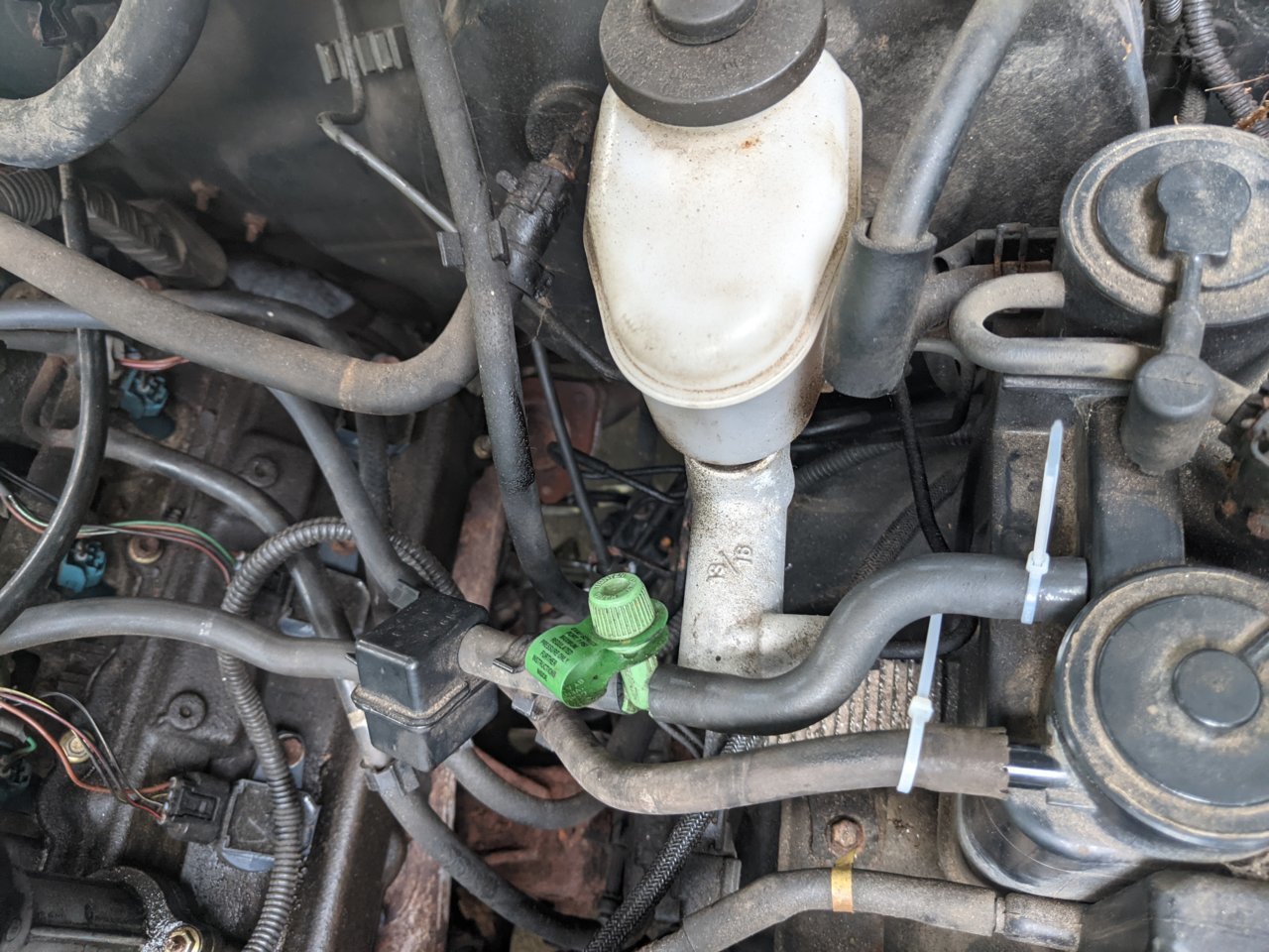

    Hoses I have didn't want to fit to match the diagram and had to be forced/ziptide. Can you confirm both of those nozzles get hoses on your application?

    Ok, so mine are opposite because the hoses won't fit any other way and in fact I ripped the one with the zip tie trying to get it to work.

    Didn't bother to check cause the truck started and drove home....but they didn't bother to reconnect the hoses under the hood....
    Since the ends started to split, I just ordered new ones from Toyota ($60 WTF?!). And the more I compare all the photos and diagrams to my own engine bay the more frustrated I get as none of it seems to line up. I may just take the new hoses to the shop have have them deal with it, which feels pathetic but I'm sick of making costly mistakes with this thing.

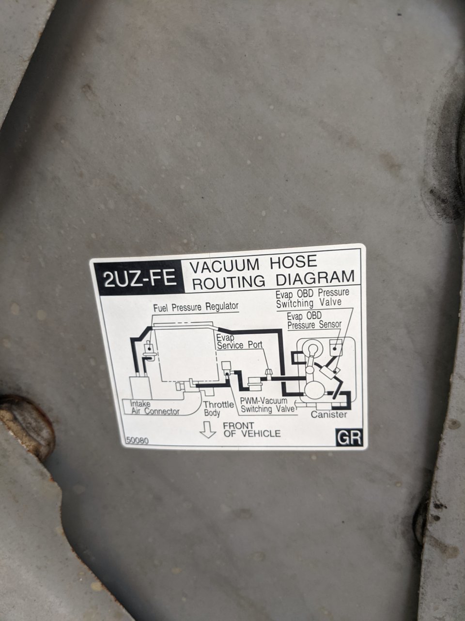

    Post a pic of the vacuum line sticker on your hood.
    also, has the evap been checked for flow?

    No it hasn't been checked for anything and I've looked at that sticker, not helpful at all honestly

    Was it identical to post #17?

    Map looks the name but has a different code at the bottom. Also rerouted things based on that (which I think is what caused the massive fuel leak last time). See last pic and if anyone confirm it looks right I will owe you a thousand thank yous.
