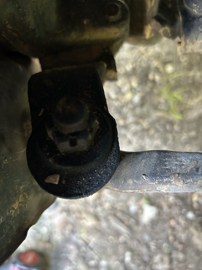

    I forgot to mention Something that bothered me a little.
    Thought I had looked good, but found one thing changing my LBJ today, that never entered my mind Especially since it's been in front end shop twice: once to have them check everything, and second time to replace the inner tie rods and align it: since I had it. No cotter pins on lot of the castle nuts. Only one LBJ had them, and none on the tie rod ends.
    Only took one picture.
    I'll be looking over there shoulder from now on.

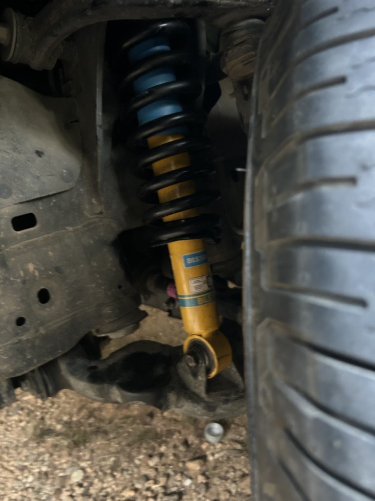

  6. Aug 23, 2025 at 6:10 PM
    #36
    Redoak
    Redoak [OP] New Member
    Nov 28, 2024
    #126549
    304
    Dave
    2006 Toyota Tundra DC, Limited 4x4, with LSD
    none
    Got the bilstein 4600 with OME 2884’s installed about an hour ago
    Was 19 and 18 on the front.
    Currently sitting at 21.5 inch. Right at level before settling, and it stopped my tire rub on turns.
    Man is it riding so much better. Old OEM shocks wore worn plumb out.
    Had to go get, and replace the sway bar links too cause once again whoever been under it had tightened the nuts down into shoulder of stud, and stripping the threads as nut came off.
    The Black Mamba, shifty` and KNABORES like this.

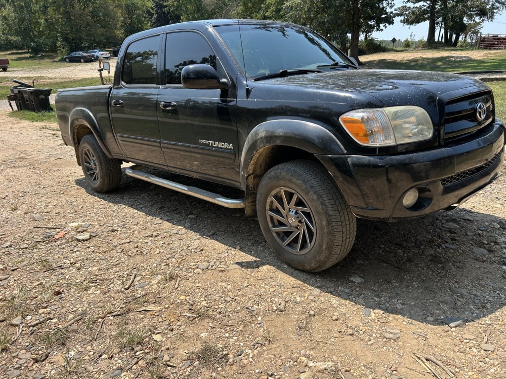

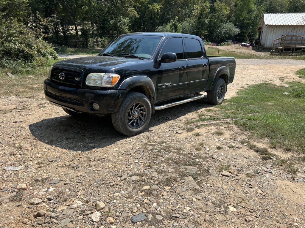

  9. Aug 24, 2025 at 1:53 PM
    #39
    Redoak
    Nov 28, 2024
    #126549
    304
    Dave
    none

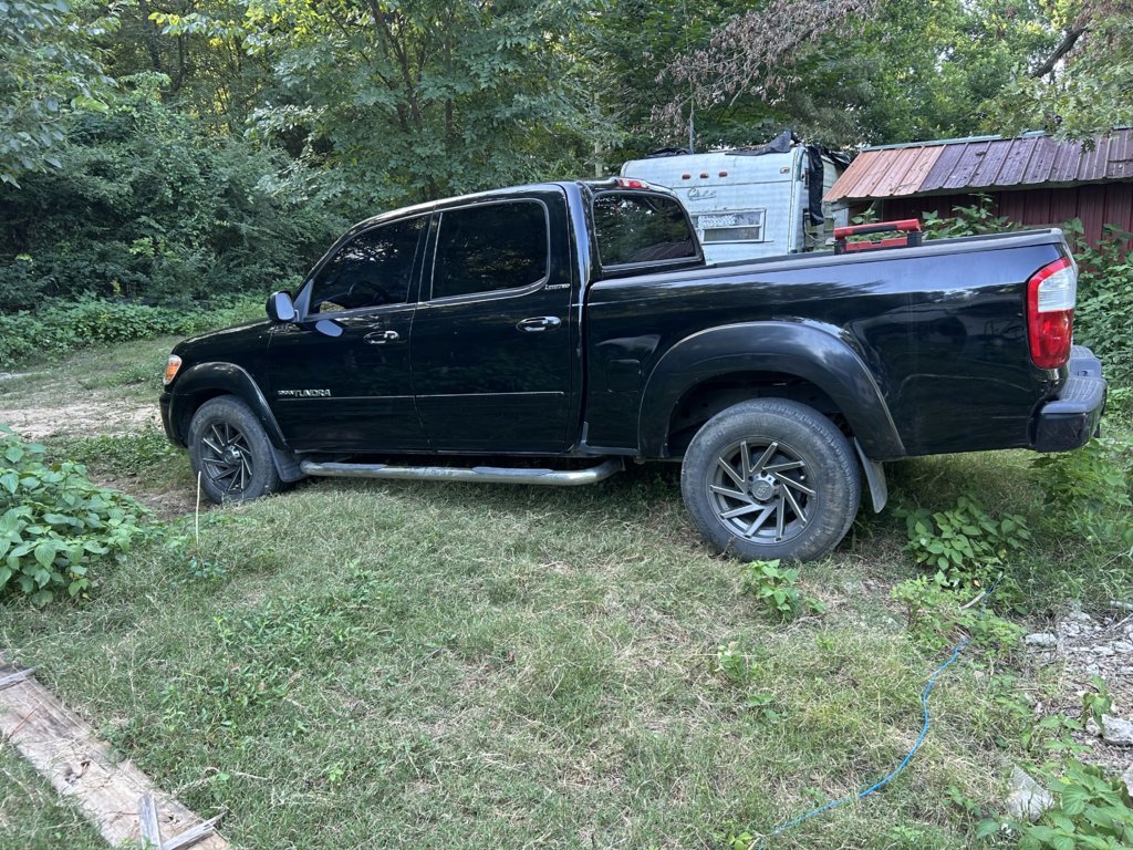

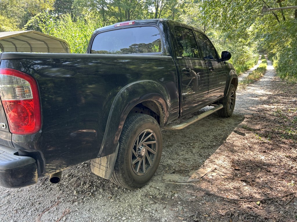

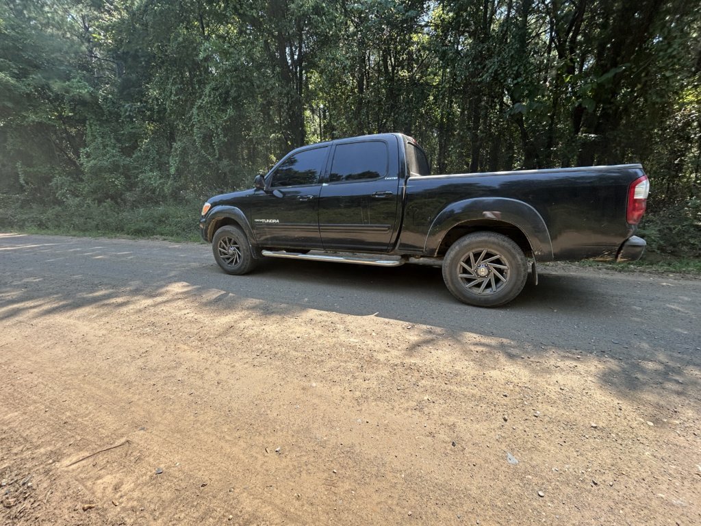

    This may be better pictures showing the lift before and after.
    Before: below
    shifty` likes this.
