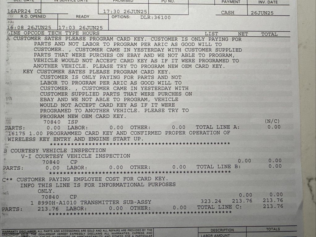

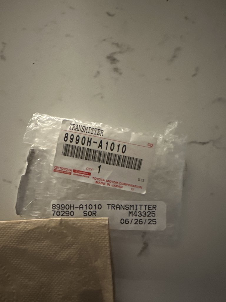

    I can confirm this works, had my 2024 Tundra TRD Pro programmed to the key card today. Virgin factory OEM keycard purchased direct from a dealership is my recommendation. I purchased an “brand new OEM” keycard on eBay with a free emergency uncut key. The keycard wouldn’t program. They tried 2x, the assistant foreman and the foreman. My advisor offered to order me a new card, and let me return it if they couldn’t program it. Went back today and the dealership ordered keycard was a successfully programmed. Also they had difficulty with cutting the “free” emergency key, they said it wouldn’t align in the machine properly. It’s doesn’t even fit in the glovebox. Thankfully seller has a return policy. A dealership ordered keycard doesn’t come with the blank emergency key, that has to be ordered separately, which I didn’t know. IMG_9166.jpg image.jpg

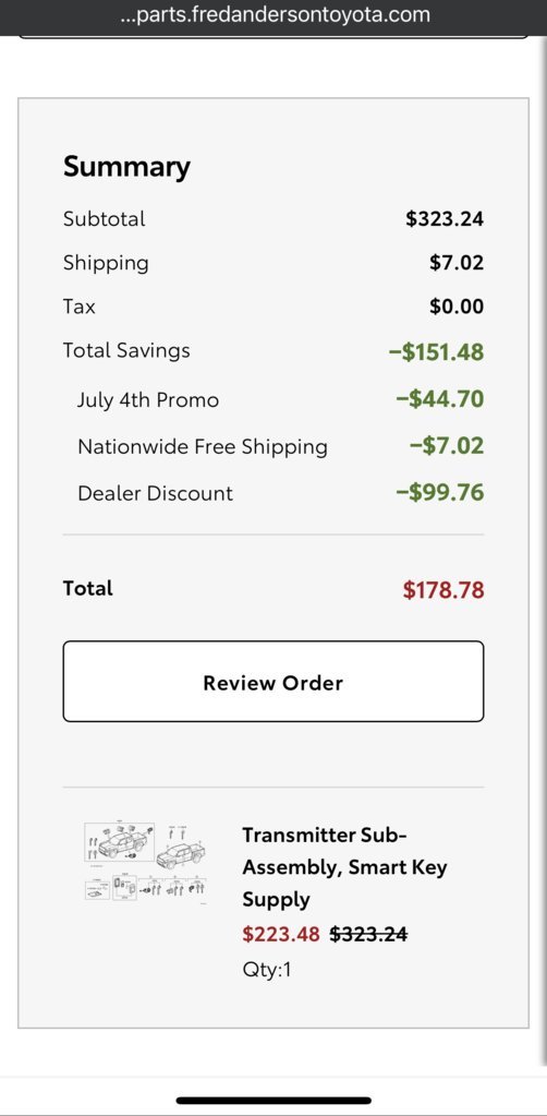

    If anyone is thinking about getting this, get it now. Most of the great dealer sites are running discounts for the 4th.
    I just ordered mine from Fred Anderson for $178.78. Lowest I’ve seen it so far.

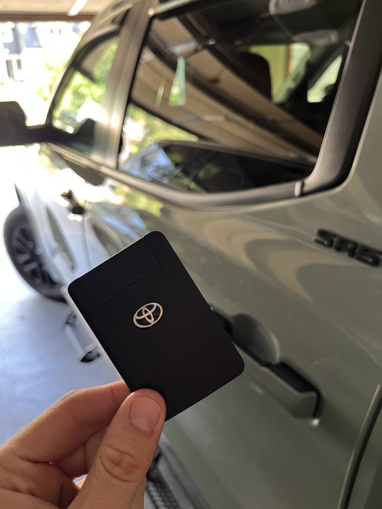

    I got mine programmed today. It was easy once I got the process down. Definitely love the key card. Here's my post of the write-up if anyone is interested.
