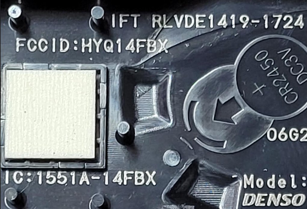

    Took mine to the dealer and they tried with no luck. charged me $180. FCC numbers are differentIMG_0134.jpg IMG_0133.jpg .

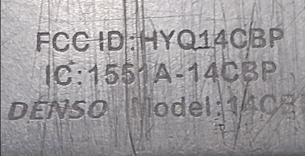

    Here is the back of my working card fob. 2 dealer visits to figure out, 1hr labor total.

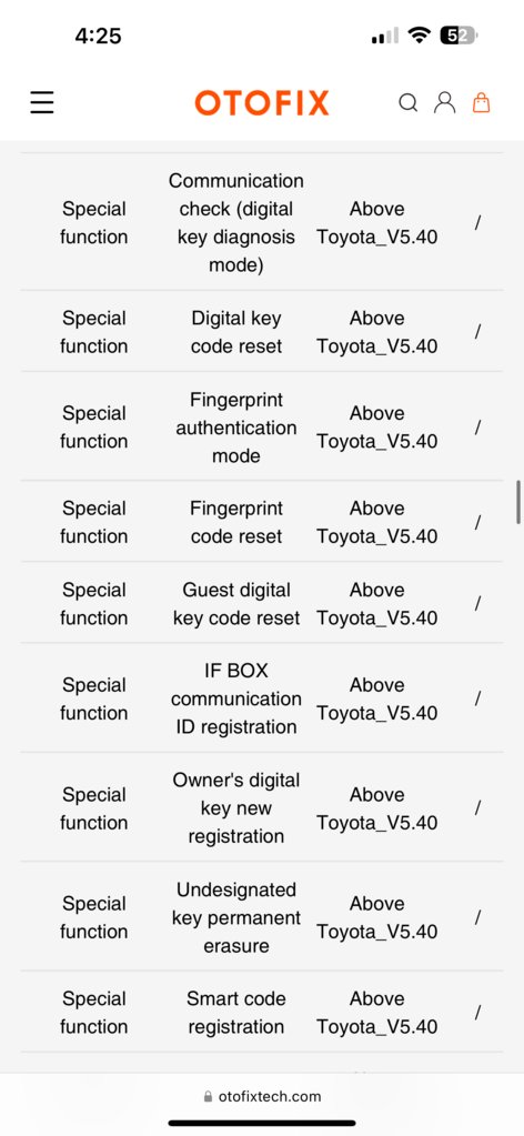

    I have a scanner that has these functions in the photo below, anyone knows if I can use it to register the digital key card?

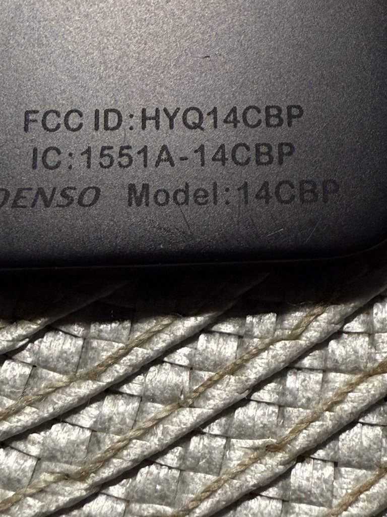

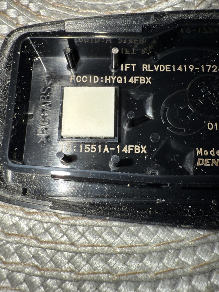

    I'm getting an oil change at the dealership Saturday and been in touch with the service center about programing one of these. They had just got some in, model# HYQ14CBP. The service manager was so interested he wanted one on his Tundra. They couldn't get it programed, even on a known new card. His FCC ID and mine are HYQ14FBX, IC: 1551A-14FBX. They talked to Toyota tech and they told them, for the 2024+ Tacoma it's VIN specific. Had zero advice for the Tundra. I think we're going to try it anyway. Anyone have any insight / tips on getting it done correctly?
