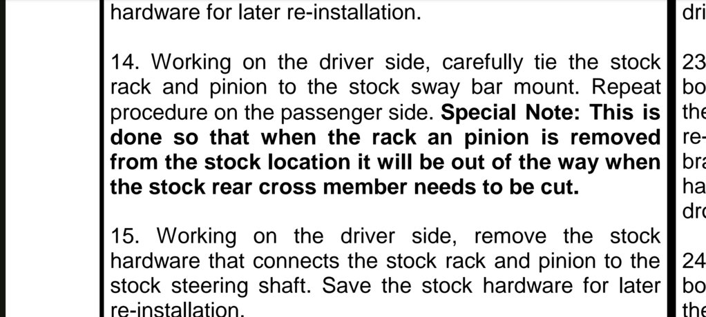

    The Tuff Country kit, it's a bracket lift. You must permanently modify the truck, to the point you can't return it to stock height again. Cutting into front/center crossmember. And with the 4.5" kit specifically, it uses those super-sketchy spindle spacers. The 5" uses a contiguous knuckle IIRC, and is the better buy. But with any of the bracket lift, you're going higher while keeping the CV angles more neutral, which is actually great from a longevity perspective. I just wouldn't want to do irreversible shit to my truck because ... well, I guess you could weld in a donor center crossmember, but it's my daily driver and I like having a fallback/reversible option.

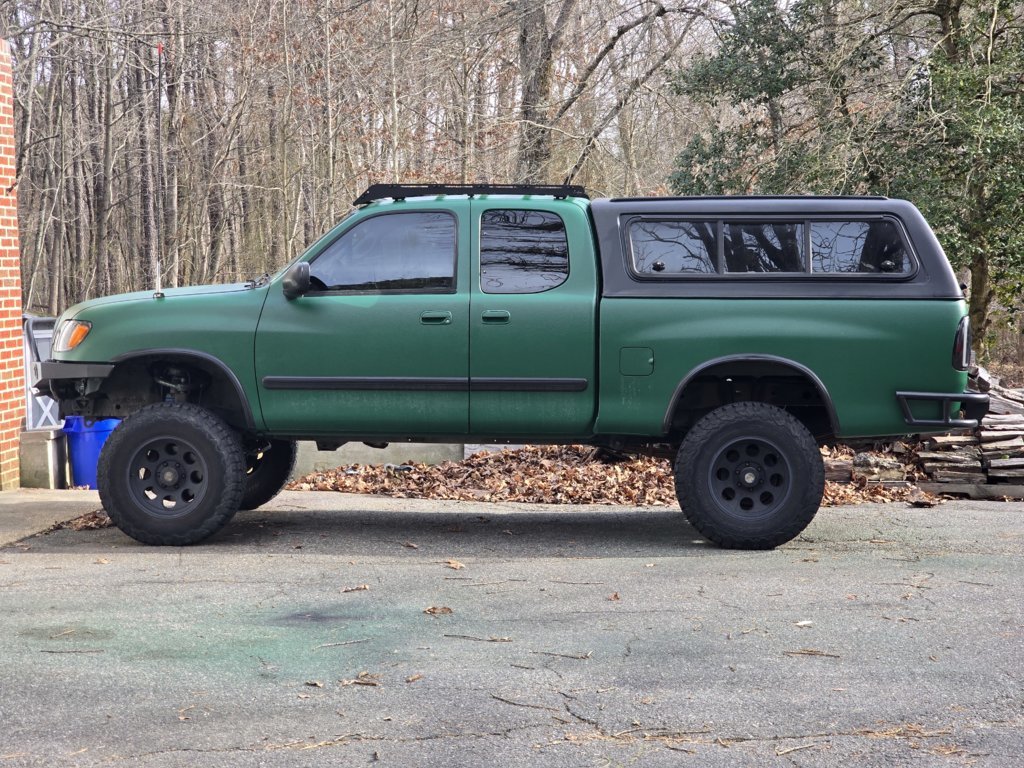

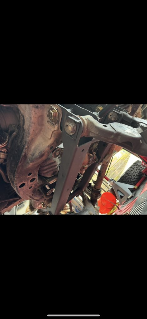

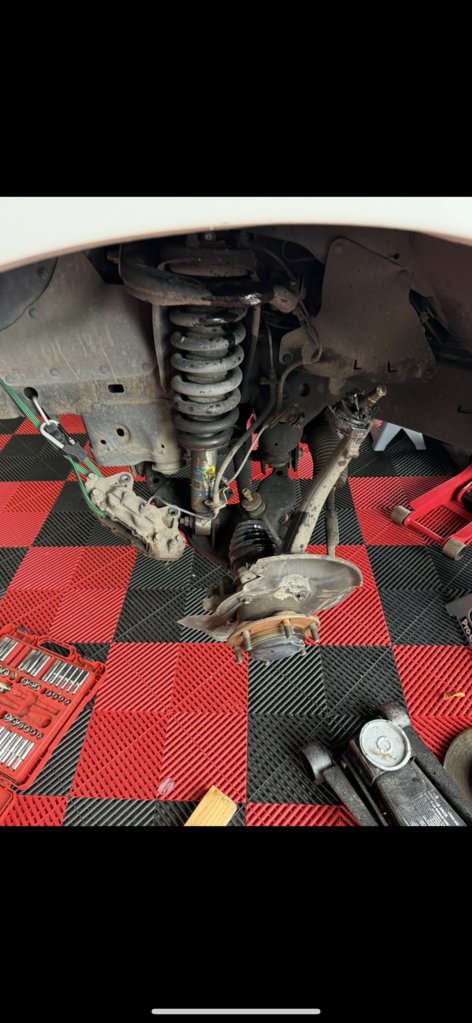

    it is the 5 inch kit that requires the sub frame cut out and comes with new bigger spindles. It has a spacer above the coilover in the front and a block in the back on the leaf. I’ll get some pictures of the suspension later today.

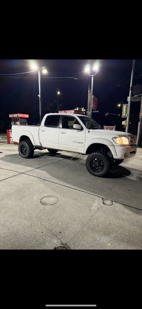

    I do have some pictures of how it sat with the Bilstein leveling shocks and the 5 inch.
    Also a photo from before the lift with just the Bilstein leveling shock
    and the tuff country sub frame while the install was happening
    I’ll get some more photos, I don’t have a picture of when I put those Monroe’s on but it was pretty damn low in the front, you guys are probably right about them being terrible.

    Ah, so this 5" lift doesn't require cuttin the crossmember? Maybe it's only the RCD kit that does... I swore they both did. But that looks like a bolt-on bracket.
    I want to see the knuckles.

    Do you need to get your eyes checked or your tape measure calibrated? The front is higher than the rear, by a fair margin.

    I would say that’s how a leveled truck should look. The side view picture looked a little higher in the front because the ground was uneven there.
    Even if it is up a tiny bit I would say it helps get rid of the natural rake of the truck.

    But it would appear he’s confused and complaining about the front being too low ? Am I right ?
    Well, ground level or not you can clearly and visually see the front is up about 2” higher than the rear.
    One thing about these trucks and most Toyota’s is that the rocker panel and the bedside are at different angles. If you want the rocker / running board level the bed will actually be tilted upward in the rear. The bedside isn’t normally level with the rocker panel so a truck that is “level” meaning the frame / rockers / running boards being level with the ground typically means the bedside is going to be tilted up in the rear
    AND
    The height of the front tire to the fender will be different than the rear tire to the fender.
    If you’re wanting to go visually off the fender to tire clearance and have the same size gap between the front and rear tire and the fender then you’re gonna have the ass end squatting and the bedside will be angled downward in the rear.
    To get this truck “level” and I mean the frame rail and rocker level with the ground you’re gonna have about 3/4” higher on fender clearance in the rear to the tire than you will in the front and the rear bedside will be about 1/2” high in the rear versus the front.
    Measure your ground to fender clearances right now and I’d bet you’re every bit of 2” higher in the front than the rear. This is a nose high pitch by a fair margin and not what I would call level and certainly not consider that low in the front.

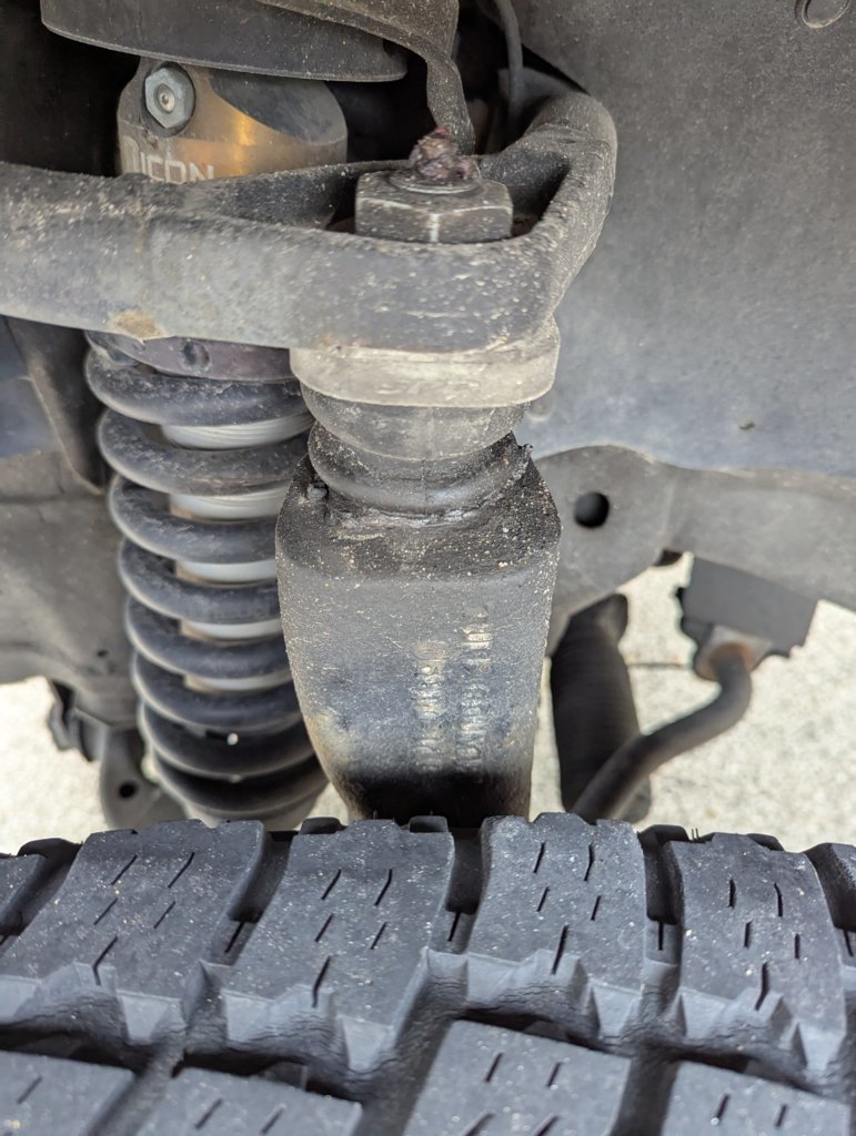

    Nah, it needs cut. Something's amiss..those spindles look small on top for the 5" compared to the ones I got. Maybe it's just the photo?

    Yea that photo of the suspension didn’t have the new spindle in it. I’ll post some photos of the current setup. And yes the crossmember did need to be cut, I said it in that post but called it the subframe on accident

    I feel like the truck in the ad in the OP's link has about the same stance as the pics the OP posted which would make me think it's sitting as should be expected. 2481959-1-2004-tundra-toyota-sr5-tuff-country-suspension-lift-6in-toxic-widow-black.jpg

    If the front is higher than you want or lower than you want, why not adjust the 5100's? Oh yeah you said one was leaking. NVM.
    Or better option:
    Buy some adjustable coilovers meant for 4-6in drop bracket lifts and ditch the top hat spacers.
    I believe Bilstein and the big racing companies (King, Icon, Fox, etc) all offer extended length front shocks for this situation.
