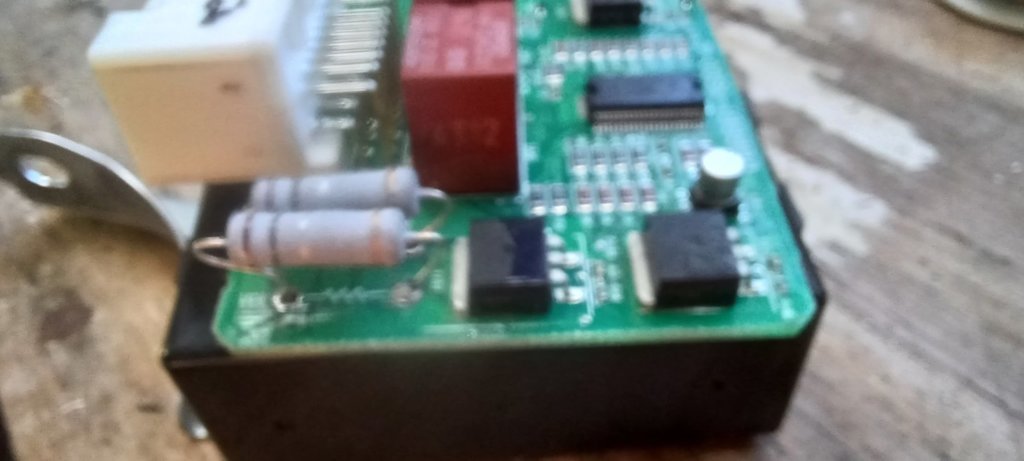

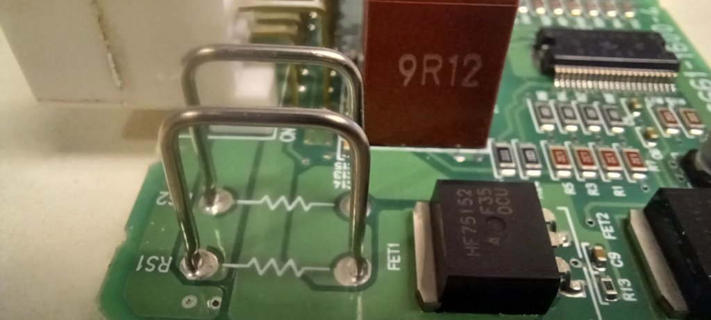

    Here are a couple of pictures of the stock resistors that some grind and the modified with new resistors soldered in.
