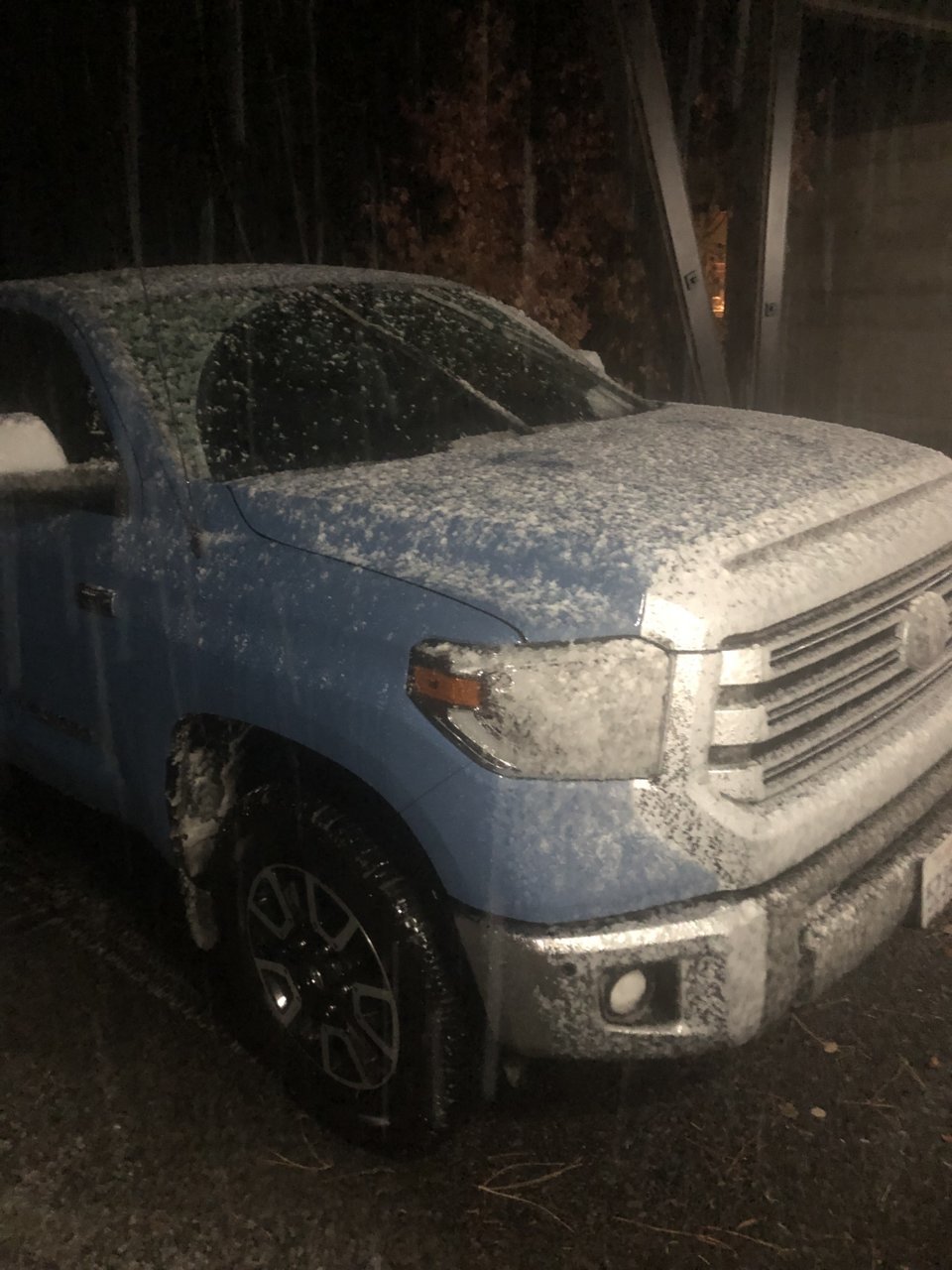

    I just had this problem occur on truck with 8k miles. Think it’s party weather related as it happened in mucky wet snow today in Sierra.

    Yes it will happen if snow covers the emblem and windshield. It’s the nice sunny days when it’s on for days we are worried about

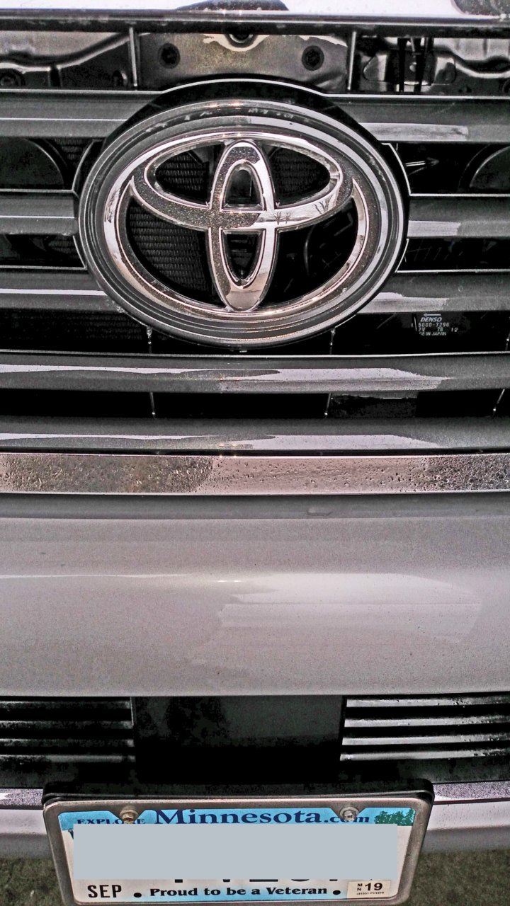

    Hi,
    I've returned to the forum after a long absence and I a little out of element. After years of Land Cruiser ownership I been "seated" in a more comfortable ride - a 2008 Sequoia Limited for eleven + years and now a 2019 Sequoia Limited. I like to read about the upgrades and accessories everyone works on. But this thread about PCS "unavailable" messages interested me.
    The 2019 Sequoia has been generating the unavailable clean sensor message for about the last six weeks here in Minnesota. The problem is nearly continuous. Yes I have cleaned the sensor and and scrapped ice from the sensor all to no avail. Of course the dealer (the largest Toyota Dealership in Minnesota) has never heard of this problem before but seeing all of the posts in this thread I doubt the veracity of that claim. I'll post a photo of the sensor so you can see the sensor and the position of it relative to the license plate. The sensor is positioned where snow-melt water runs down on the sensor and freezes on to the sensor creating icicles partially obscuring the surface of the sensor. Next week a Toyota Master Tech will look at system and report to Toyota corporate through the Customer Voice program.
    Based on what I have read in these posts I expect my outcome will be similar.

    Thanks for the suggestion to clear (clean) the Toyota emblem but on the Sequoia the PCS sensor is not incorporated into the Toyota emblem but rather, it is located below the bumper partially obscured by the license plate.
