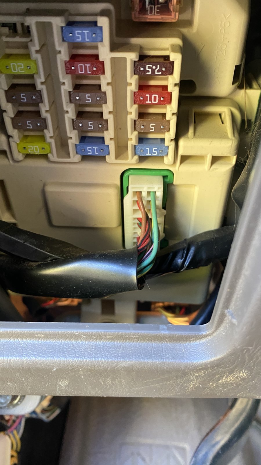

    There is a relay I had to add to get the windows to work. It goes in the dash by the driver side firewall. It’s on the back of the panel and hard to see.

    It looks like I have the green connector housing as you described.

    Im going to try that right now!

    Shoot I just realized you had that information in your instructions, but I got it now. Thanks dblittle!
