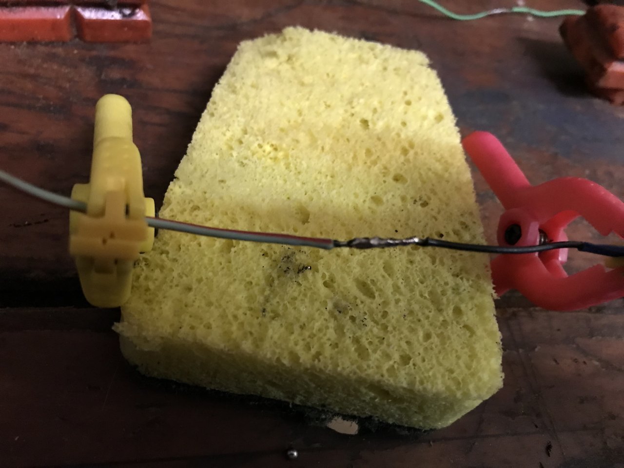

    CF7D0666-8452-428E-A9F2-FD011A8F1161.jpgJust a little bit of progress made this weekend. Baby steps…

    If this were me, I'd have forgotten to put the heat shrink on during my 1st wire. At least until after I tinned then probably finished my joint.

    I did…..

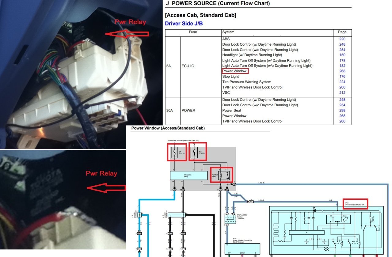

    I have the harness repaired and checked and everything works except the power windows. The donor truck had a bad switch for the drivers window, so I sourced a replacement one that checks out with my multimeter. The window motors work when I put power directly to them, so they're good. I think that I don't have the main power relay on my truck. That would make sense, I guess, given that it came with no power accessories. The relay is supposed to be on the back of the fuse block to the left of the steering column under the dash. It's really tight in there, so I couldn't see for certain whether or not if it was there. If it's not there, putting it in is going to be a really fun exercise. Does having to add that relay sound familiar to anyone who's done this swap?

    Mine had the relay if remember right. But it’s been. A few years

    Never done the swap but definitely have to have the Power Relay as Dan alluded to. According to the 06 FSM and EWD, you would need the 5A ECU IG fuse, 30A Power fuse and Power Relay. The ECU IG should be there given it feeds a number of existing circuits. It's questionable if you have the 30A given it appears to only cover what you are dealing with. ECU IG fuse is used, among other uses, to energize the Power Relay and when energized closes the contacts, current then flows thru contacts to Master power windows switch, protected by 30A fuse.

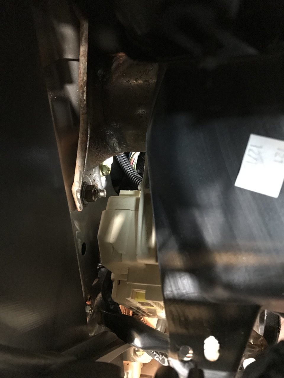

    EA38563D-D370-47BC-B788-C916A863521C.jpg EA38563D-D370-47BC-B788-C916A863521C.jpg
    That last picture tells the tale. No relay. On the bright side, the 30 amp fuse is there.

    At least the relay is easily gotten from junkyards or denso or Toyota

    FE868D50-7751-4946-BA03-4B4DD14CC30D.jpg I grabbed a relay and managed to wiggle it into place without taking apart too much of the dash. Success! I have power windows, door locks, and heated power mirrors in my front seat.
