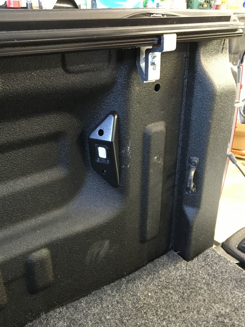

    The OEM instructions say that there is a conflict with the bed lighting kit, which I have. Does anyone know what the conflict is? Is it in the plug that the OEM has? Is it routing of wiring? Has anyone installed this with the OEM bed lighting kit?

    The only thing i can see that conflicts with the two is the wire harnesses for each kit both run down the passenger side frame rails and into a body plug hole on the pessenger side. toyota probably deems two harnesses coming through the same grommet and routed together down the frame rail tobe too bulky,but in reality i dont see why both cant be indtalled.

    I installed a Pop and Lock a couple years ago, not much to it.
    As stated use Posi-taps and make sure you have a good connection before putting the interior back together.
    If anyone buys a Pop and Lock for your Tundra, make sure you get their newer HD version, PL8547HD.
    I think it may be quieter and than old style.
    Also the HD has grommets for the door that accommodate 2 wires, instead of shoving 2 wires into the OEM grommet.
    Etrailer and @Bakershack walmart link have a pretty good price on them..

    On my truck that body plug has wiring for the Pop and Lock, custom bed lights, and Amp steps..:eek2:

    I'm not 100% on this but consider a possibly current/fuse conflict if you use the power gate while the lights are on. What is the draw on the bed lights?

    Just a couple of tiny LEDs..
    It couldn't be too much..

    Thanks to all for the responses. I currently have those LEDs but plan to replace them with @mattgecko's bed lights. I will have to make sure I have enough juice. Matt wasn't sure of the current draw so I plan to measure it myself once I order and receive his lights. What have y'all used to seal the floor grommet after running multiple wires through there?

    I just slapped some silicone caulk on it (from the inside), then covered it with a piece of foil so it wouldn't stick to the carpet..
    One advantage of the locking tailgate is hearing it lock when walking away from the truck.
    I don't always hear that 'beep' when it locks.
    I also got tired of checking to see if it was locked because of my minor OCD issues..:eek2:

    I have the pop and lock on my 2019 with Matt geckos bed lights.....no issues. The pop and lock IS loud but I like my truck loud. It doesn’t other me at all and I know it’s working

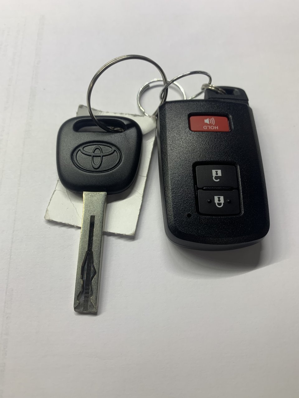

    Same here. I received a pair of key fobs, plus one "real" key.

    Just purchased a 2020 TRD sport last month and it came with 1 real key along with 2 key fobs.

    Mine came with two fobs each with a blade insert key

    This!! I got a full size key also with my 2 fobs, push button start and remote tailgate unlock options

    As others have said, you should have gotten a single full key as well. and a little silver badge with a number on it.
