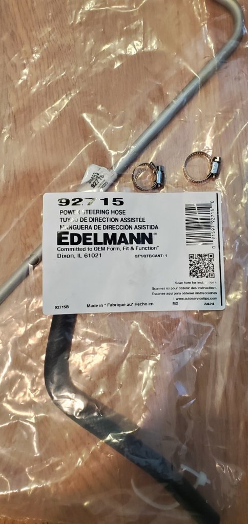

    Hello Everyone, I just wanted to leave this here so that anyone having this issue in the future can find an easy, cost effective and great solution to this problem. After an extensive research I found this set of hoses from Edelmman Brand name, made in Mexico and not in China to my relief. I bought from Parts Geek LLC online, I only paid around $60.00 for it. it arrive on time, had my friend help me hold the metal section from the bottom of the vehicle since it's only held by a clamp on the frame, and I didn't want to break it during installation while applying pressure to slide it on, made the process much easier having that extra hand, it only took about 5 minutes. It fits right on and it also works on my first Gen Tundra. I didn't use the worm clamps they sent me, instead I bought two from Toyota and replace the two old ones. Hope this helps the next victim... :) Sorry I forgot to mentioned, kit comes with two rubber hoses and a metal line, I only needed one of those hoses and not the other two pieces.
