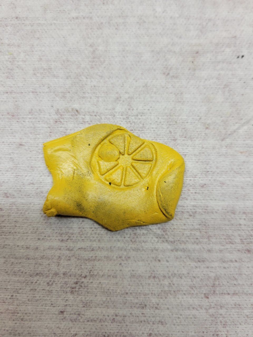

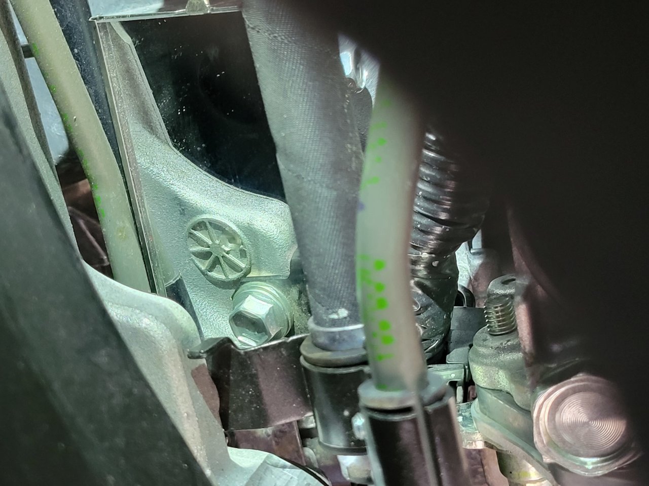

    Has there been confirmation if "B" good or a potential fail?

    In your top pic looks like the punch mark is in the "C" position?
    The marks would be reversed using clay impression?

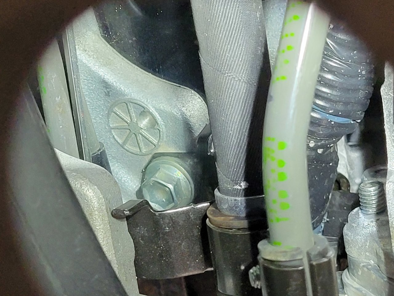

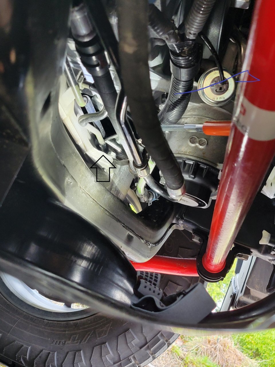

    Couple shots of where mine are punched, build Date Aug 2021.
    Crammed my largest inspection mirror into the area, placed a headlamp on the skid plate and aimed at the mirror, then took the shot through one of the skid plate drain holes with a Galaxy S21.
    Looks like mine is in the A zone.

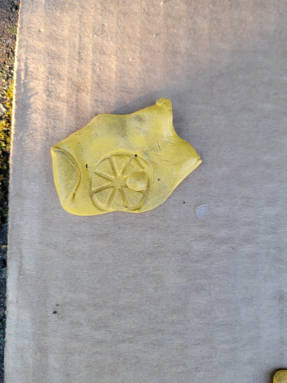

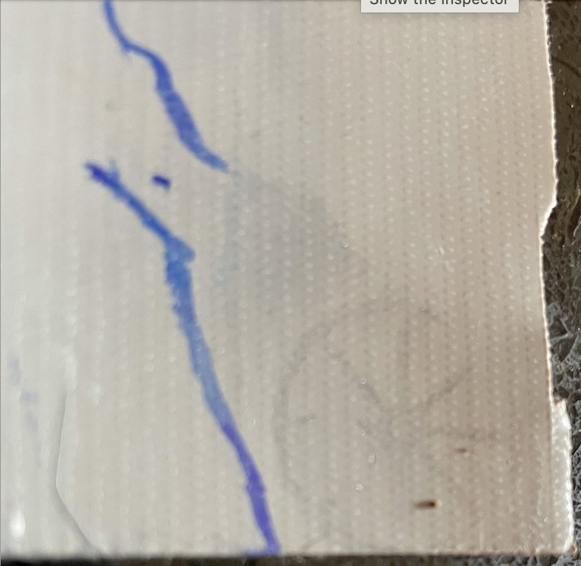

    Hard to tell with the clay so I ran outside and tried another method which made for clear shot. Took longer to drag out the carboard to lay on and find a headlamp.

    Nice shot...how to orient correctly?

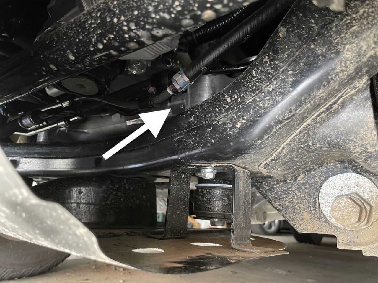

    I got under mine and it does not look at all like the pictures. I can’t tell on mine where it would be. Where I’m looking at is a solid shiny tube and bolts and there ain’t one flat flange on it?? Hoping mine was changed out at factory?? Will tell on Monday next?? No noticeable leaks anywheres?? Might go look again later?

    18"BBS Forged wheels, factory running boards, VLED's, Rigid Pro Led mod (D2 SAE), diff breather mod, Husky mats, DIY Cquartz UK 3.0, Husky liners, OCD organizers,
    Much easier than I thought. The extension mirror was basically laying over the punched area on it's own so no hands required. I placed the mirror in through the passenger side while looking up through the front center skid plate hole. Headlamp was situated under the general area on skid plate pointed in direction of mirror, rear phone camera (not front selfie) aimed through the skid plate hole facing the mirror area. Once you have headlamp setup and cram the mirror in position it's very clear and easy to focus through the hole for a shot or two.
    Just ran out to setup the mirror again and take a picture to help with the explanation.
    Hope this makes sense.

    Wondering if it is a four wheel drive thing??? I went back out and I laid under there a while and I can’t find it so I’ll let the professionals handle it!:)
    heck fire found it, enter from front of the truck and I saw it now to figure out if I want to mess with it. Thanks y’all for the answers to some questions.

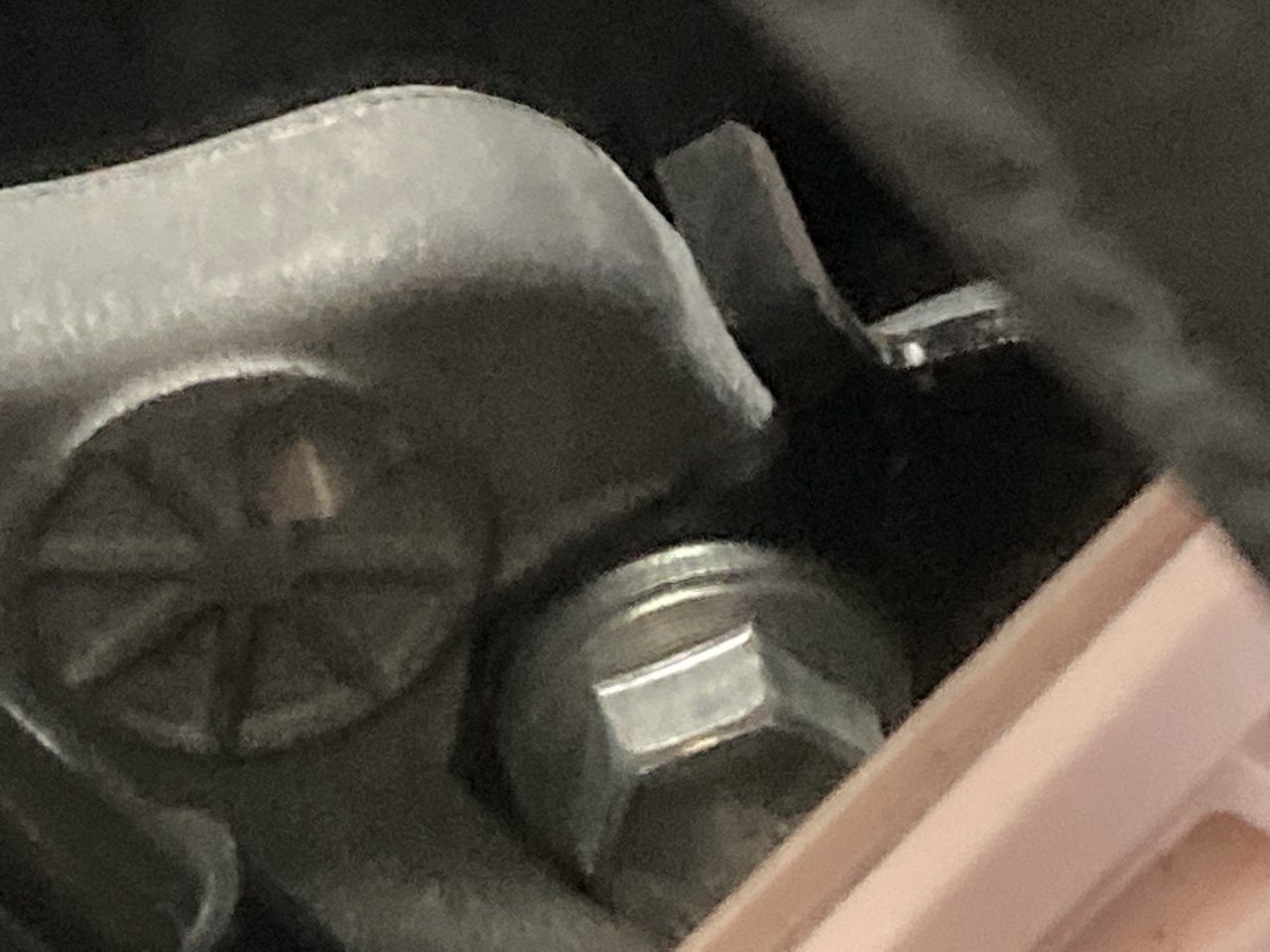

    is that good or bad?? Mirror on top of cross member black frame piece camera from the floor up

    Good shot, I'd be interested in knowing as well.
    If a few definitive pass or fail pictures show up we'll have a better idea of what represents potentially affected units.

    Don't know if its good or bad, but it looks like an A to me. The B section is closest to the edge, and A is closer to the black clip under the bolt that hangs over the front edge of the rack. Your's looks closer to the black clip. Similar to pic in post #254.

    But it’s upside down and backwards?? I got under there and held my phone every ways I could. My daughter is coming over and I am going to take a picture with the phone facing the rear like I did mine and then face it to the front to see what is what?? I going to camp are with the shop on Monday and take pictures of what they do???:)

    It's not always easy to figure out due to the mirror image. B is still the one closest to the edge, from there A is closer to the bolthole and clip, C is almost directly across the pie from the bolthole.

    Crap!!!!!!! Yup!!! Followed the picture up above and mine is in the A. Daughters truck was build before so I will see what is up when she gets here?? One thing for sure, it looks like a dull tool made the mark in the picture above.????
