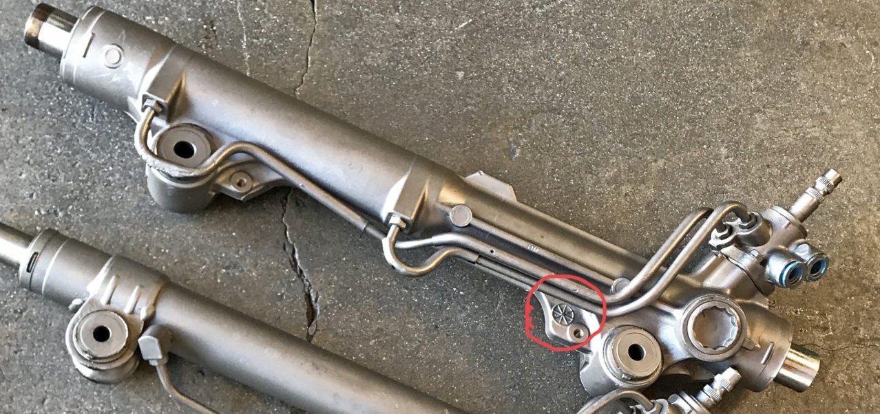

    stamping location on rack. ( red circle )

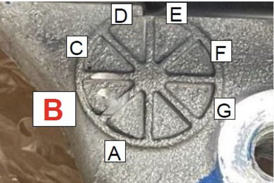

    One of my concerns is the tech working upside down and backwards with a mirror may misread the punch mark and check off my truck as good to go. I’d just like to be able and check then double check for myself. Then the dealer can triple check it when it’s inspected. Better safe than sorry, we already have one member reporting failure while exiting a on ramp and his truck crossing two lanes, almost hitting the cement barrier before he gained control.
    BCTRD, wexttxco and 2mchfun like this.
  10. Jan 30, 2022 at 4:50 PM
    #220
    timsp8
    timsp8 Former Tundra owner for 13 years
    May 11, 2018
    #15231
    3,540
    NY
    2018 Tundra Limited Crewmax - Traded In
    Someone mentioned those 8 sections of that circle have letters and it depends on where in that circle it’s punched, so they shouldn’t misread it. A post also said they don’t read it, but take a picture and send it to Toyota for them to read. This is a big issue and I think Toyota is trying to read it right. Imagine the lawsuit if they said you’re good and then your fails and ends in a crash with injuries.

    Makes sense because they then have secured evidence just in case at some point a bad rack is put into a truck from salvage.

    Cause the rack fits 07-21s, so if someone bought a bad one to replace theirs in a non-21 then they’d be part of the recall.

    So if there are four cutting heads and four possible punch marks why is there A,B,C,D and also E,F,G?
    TIA
  19. Jan 31, 2022 at 6:34 AM
    #229
    2mchfun
    Dec 31, 2020
    #56879
    6,686
    Dan
    Maybe the casting mold producer suggested a design commonly used for other things. If the shoe fits, wear it comes to mind!
    9DivDoc[QUOTED] likes this.
  20. Jan 31, 2022 at 7:22 AM
    #230
    9DivDoc
    9DivDoc New Member
    Jan 3, 2021
    #57039
    321
    Wisconsin
    2021 TRD PRO CM MGM 2021 SKM CM Limited
    agree with the casting design rationale and have seem similar in plastic parts time,date,stamps...just wondering why in the illustration why the additional letters E,F,G and if they had an other significance?
    2mchfun[QUOTED] likes this.
  21. Jan 31, 2022 at 7:26 AM
    #231
    2mchfun
    Dec 31, 2020
    #56879
    6,686
    Dan
    Probably just to eliminate any ambiguity. These circumstances call for utmost clarity.
  22. Jan 31, 2022 at 7:29 AM
    #232
    9DivDoc
    9DivDoc New Member
    Jan 3, 2021
    #57039
    321
    Wisconsin
    LOL I kinda thought the extra letters beyond the 4 cutting head possibilities was kinda confusing...at least for me anyway...:)
  23. Jan 31, 2022 at 8:02 AM
    #233
    2mchfun
    Dec 31, 2020
    #56879
    6,686
    Dan
    Having extra spaces gives room to grow. Having extra letters makes consumers confused. Both are desirable from a manufacturing and servicing perspective.

    How was the lettered clocking for the casting in the above post determined and is it accurate?
