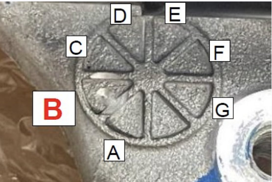

    Here’s the deal.
    If your rack is stamped with a specific stamp, you’re rack will get replaced.
    If it fails before you get it replaced, they will replace the entire P/S system (due to possible contamination.
    If your rack does not have the stamp of the affected racks, you are on your way and all is good.

    There is a punch mark in one of the 'pie pieces' and depending on where the punch mark is determines whether the rack is affected or not. I’m not sure where this is located on the rack exactly but I’m assuming on the top since you need a mirror and light. I’m also assuming the red B is the area that fails inspection but not 100% positive.

    I think B means you B BAD

    B means we BE needing just one more piece of this puzzle!

    Does anyone know for sure if the B is good or bad?

    I'm almost certain if B is stamped you're NOT good but still think a quick inspection at the dealer is the easiest way. Plus, we are supporting the members here that do this work as a vocation.
    EDIT: Turns out B is the bad mark.

    Should there not be (3) "Good" pieces of pie to represent the three machines that ran parts to tolerance specs.?
    Edit: as in 3 possible letters that are "good"

    Sounds like B is one of three four possibilities A,B,C, or D?
    Wonder which letter represents the bad cutting?

    I’ve been told that B represents Bad

    One of 4?
